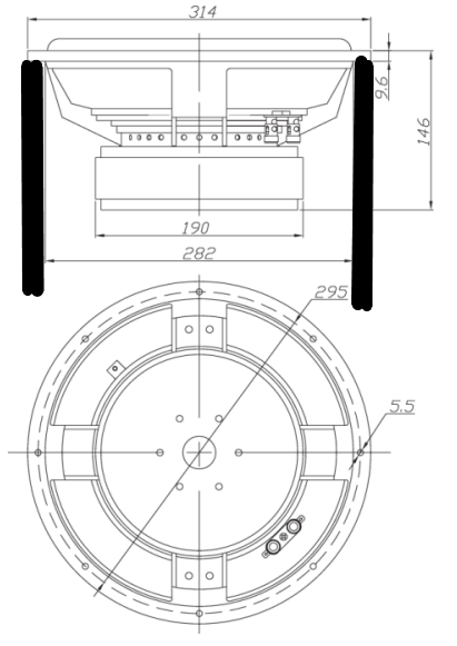

I'm in the middle of coming up with sub dimensions, and it's going to be tight. Pretty much 1/8th of an inch on either side of the flange. I will be routing the outer inset hole very close to the edge.
The internal width will pretty much be the exact 282mm, where the flange meets the basket/frame. I was going to rotate it so that 2 of the metal supports of the frame will be adjacent to the side walls of the cabinet. Like in the picture below. I'm hoping that would allow the woofer to breathe.
Does anyone see an issue with doing this?

I built a convertible box just like you are planning. I used metal pipe plugs with a rubber gasket inside that expands when you turn a wing nut on top. They work awesome, no vibrations or leakage. Just needed 2 because they're only 4 inch I believe. Also, for what it's worth I never remove the plugs. The sealed enclosure on the large size is very noticeably more accurate, even when both are room corrected. Transients are more crisp. Extra spl with vented is not worth the tradeoff, and I'm blinking distortion lights on 800 watt amps regularly so I do crave huge output.
Thanks for the response. The more I read, the more I decided I would be happiest with a sealed sub.
So I pretty much scrapped the idea of doing the convertible. That way I could optimize for a sealed enclosure, rather than try to compromise and use a port too small etc. It's why I had to go for a 12" driver, since I figured the extra Vd is necessary when going sealed...
