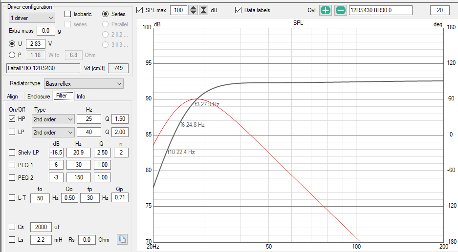

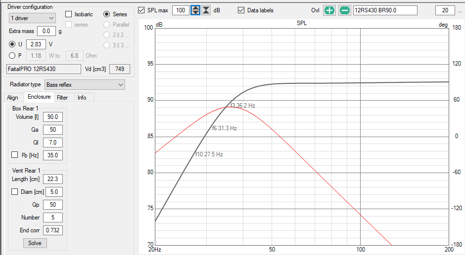

The facetted walls will make the enclosure very stiff - no or just minimal panel vibrations!I wish I had a good promo talk about how the facetted walls push the internal resonances out of the audible spectrum
Appreciate the input. To me, it seems intuitive that narrow 'plancks' resonate less or at least higher in frequency than big wide side walls. I could be completely wrong of course, as I have no evidence for this assumption. My reasoning is basically: smaller = higher frequency
One of the goals of this project is to build something based on science/evidence. I'm trying to sim this thing as well as I can using Vituixcad and Akabak (still learning)
The plan is to use a 2 channel DAC in to a 2 channel plate DSP plate amp per speaker (Hypex FA252) powering both the low end and the HF.
That's what i figured, but building something on intuition isn't always a good idea(?)
If you want to avoid the enclosure length resonance exiting the port (and driver) you could make simulations with hornresp offset port mass loaded transmission line model and move driver and port to their "ideal" positions.Any comments on bracing or other aspects of the design?
Baffle is 34cm, back is 15cm. Full height is 90cm.
I wish I had a good promo talk about how the facetted walls push the internal resonances out of the audible spectrum, but it's just for aesthetic reasons (although I do think it should help reduce resonances 🙂 )
The goal is to either make the cab's 'Fs' below or above its BW, so normally we want it to go lower and while facets removes material = less weight, ergo summed panel resonances rise, just normally not enough to matter, so best IME is to use HR or similar parabolic horn theory to design this style cab, then use thin/flexible material + bracing the sides and finish with vertical 'X' bracing to tie all six sides together with the one parallel to the baffle designed to mass load the driver to the whole cab.
Have you looked at molded MDF and ply curves and partial curves? Regular thin section faceting looks like a 'troublesome' solution...
Works fine with quality no void plywood and wouldn't even consider doing the MDF available locally except cabinet/furniture maker's $$ like Altec and others use(d) for Vott horns, whole cabs.
I thought about doing 'regular' curved sides, but I like the look of the facetted wall better and I don't really see the issue with the facets. I will be a more complicated build but I like a bit of a woodworking challenge. I will use good quality plywood, never liked MDF. Is there a way to sim cabinet resonances and bracing? I'm not yet familiar with HornResp.
