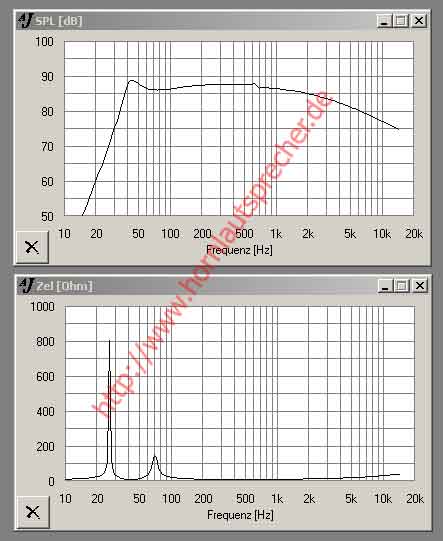

Hi Floric
sorry for my late response, but right now I am full with worx.
yes the SPH-135KEPs play in 13-15 liters BR each. The port is about 20cm long and has a diameter of 55mm.
here is the sim of one driver in 15liters BR, port 24cm² and 21cm length
cu Till
cu Till
