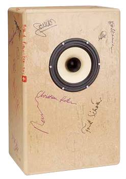

Haven't emailed Madisound yet but they are offering a sealed enclosure for the exotic. Anyone tried them yet (for those of us that can't build enclosures at the moment)?
I have listened to the pair madisound has many times. The Exotic sounds good in this cabinet but not as good as all birch ply natural finish. But for the funds a exotic in the madisound cabs better than most other fullranges I have heard.
Thanks for your reply. I've thought of having enclosures made in a similar shape but the ease of these enclosures make them appealing. Any idea on the construction? Are there other pre-made cabs out there that would work well with the exotic?

So guys, have we some ideas about a suitable cabinet for these drivers? Or is a 60lt sealed (golden ratio) it? Not that there's anything wrong with that...I just thought there might be some more optimum designs.
All the best: Dave
All the best: Dave
That's what we have done and it behaves really nice. Wouldn't go another way, despite from a horn maybe.Or is a 60lt sealed (golden ratio) it?
