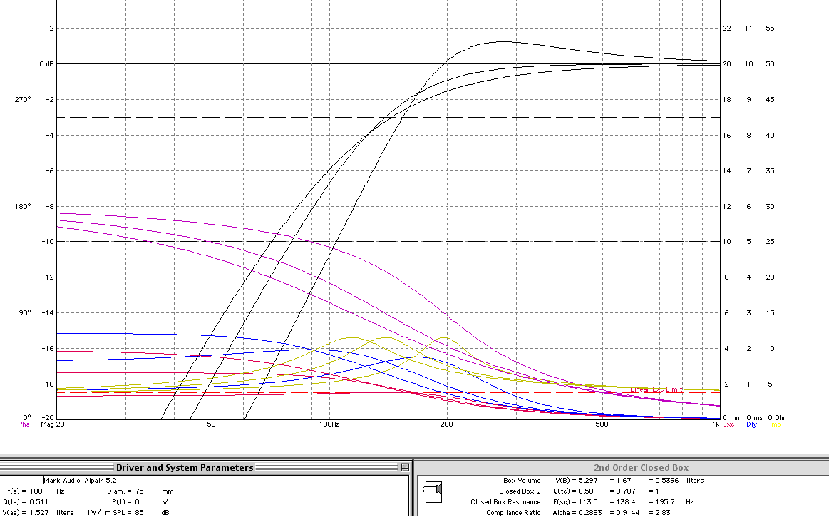

The normal target for a sealed enclosure for the A5.2/3 would be 1.7 litres unstuffed for a Q of 0.707, Butterworth, max flat response. Adding damping (required) will make the box act larger.
Beyond that you are looking to remove as much of the back wave of the driver as much as possible so that it does not come back thru the cone and cause a time-smear.
Making the sub enclosure larger, gives more room for damping, or a midTL which makes for a low pressure enclosure with maximum damping effect,=.
Try the sealed pipe, then if you decide to it can be made leasky by drilling holes into the pipe from the back.
By making the box larger it will roll off sooner & slower. Given the high XO, that is not an issue.
