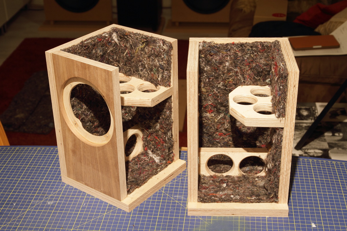

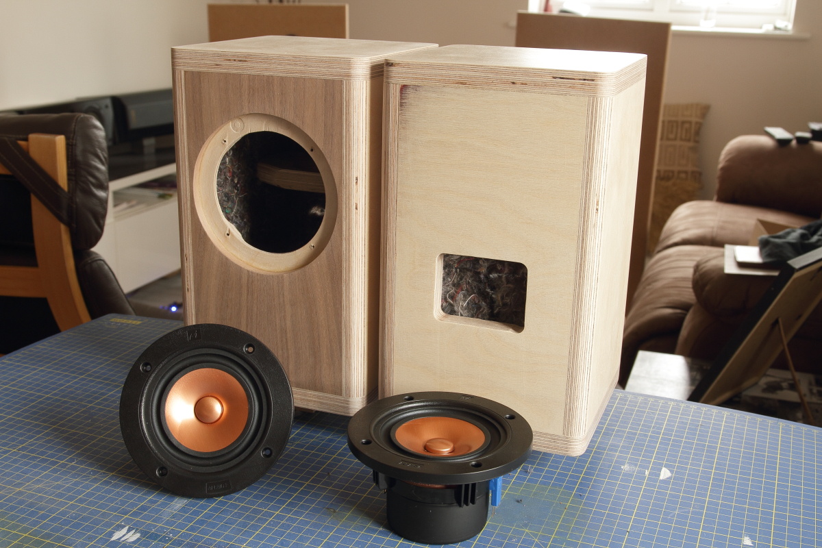

Very Nearly Done
Currently have a lot of projects underway and all nearing completion, with final details taking the most amount of time.
Had the mMarS sat on one side for a few weeks waiting the arrival of the A7.3 drivers. These arrived just over a week ago and gluing began mid week. The driver rear braces are trimmed, requiring a slip of paper for nice fit... Internally, used needled cotton felt.
Initial level sanding with 60 & 80 grit and routed the round-over [R=14mm], then sanded down with 80, 180 & 240 grit... applied some acrylic sanding sealer, sanded again with 180, 240 & fine wire wool. Will get some furniture wax to finish off...
B/B and Walnut veneer were leftovers from other builds. Both rears were slightly proud and needed ~1mm removed to level them [not so pretty looking]. Overall very happy & am pleased that my building is improving.
Should have these playing in the not to distant future 🙂
