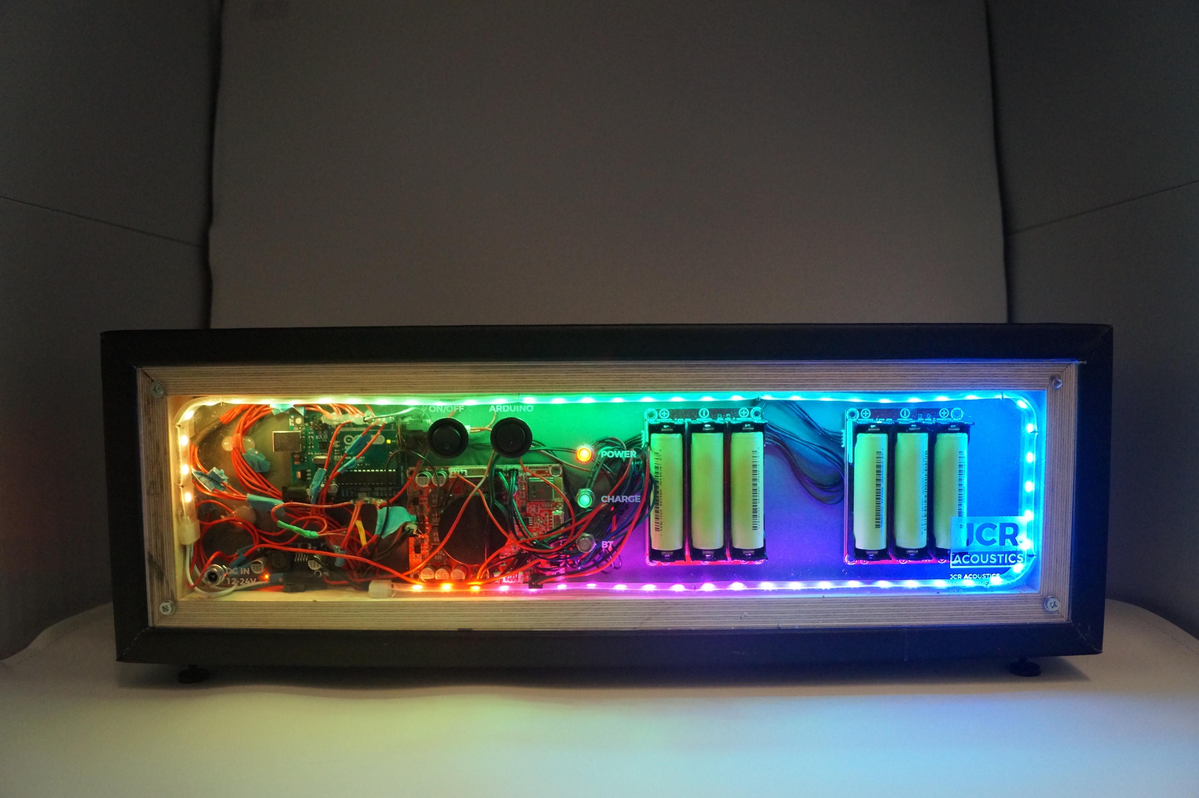

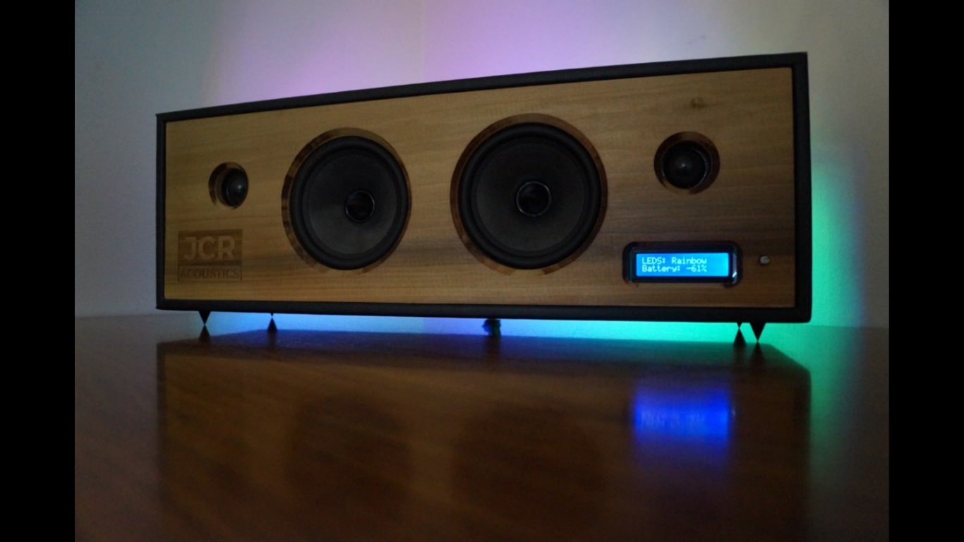

I landed on a sealed unit as I am hoping to keep the unit "boombox" style - similar but larger than my previous design (see images) but with the two subs down-firing. I believe this will give me more clarity. The zones for the sub-woofers and other drivers will also be separated (volumes currently undecided). The drivers will be powered by a Bluetooth amplifier I've been developing with an active crossover to separate lows and highs (crossover frequency currently undecided) to two TPA3116D2 Amps. The highs will then pass through a passive crossover to separate the tweeter and mid-range driver for each L/R channel.
Any thoughts on any part of the build would be appreciated but specifically on the sealed sub-woofer section of the unit and any crossover frequency suggestions from those with experience with these drivers. I've spent most my time developing the amplifier thus far so wanted any pointers on the design before I delved too deep down a particular path.
Thanks!
P.S. please ignore my ghetto electronics on the old unit - I've changed I promise!! :nod:

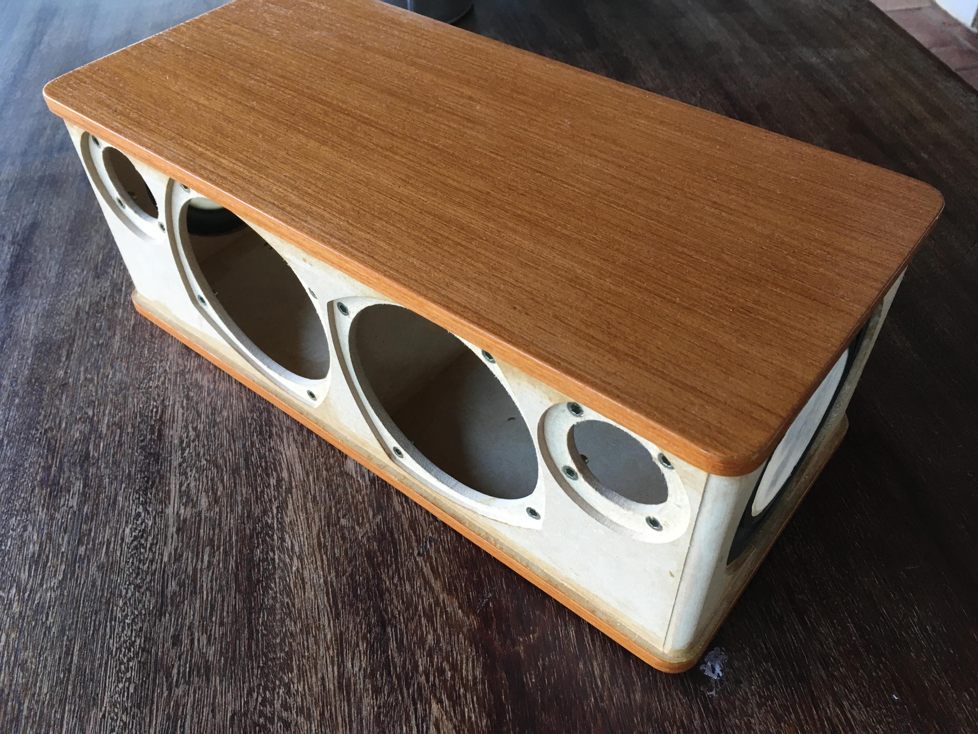

I actually made two speakers, almost identical, only one is done, the second is almost, the difference is that one of them have no battery, passive crossovers and no DSP, this was for my father
The one is progress is my own, battery powered, fully active (independent amplifiers for mid and tweeters to avoid some crosstalk problem I was having) and powered by a ADAU1701 DSP
The Devialet can surely pump significant bass, but it requires a lot of power, not doable for a battery based system, even in my own I need 12 dB is boost @40 Hz, but in my testing the battery life is still reasonable at 20+ hours at moderate volume and around 5 to 8 hours at full power
But all this comes with a maximum volume penalty, if I tuned my passive radiator to 80 Hz, I wouldn’t need any DSP and the loudness would be increased by 10 dB with the same power. The nice thing about using the DSP is that I can use a limited to tame the excursion and still get the full volume, with reduced bass of course, I need to play with it first

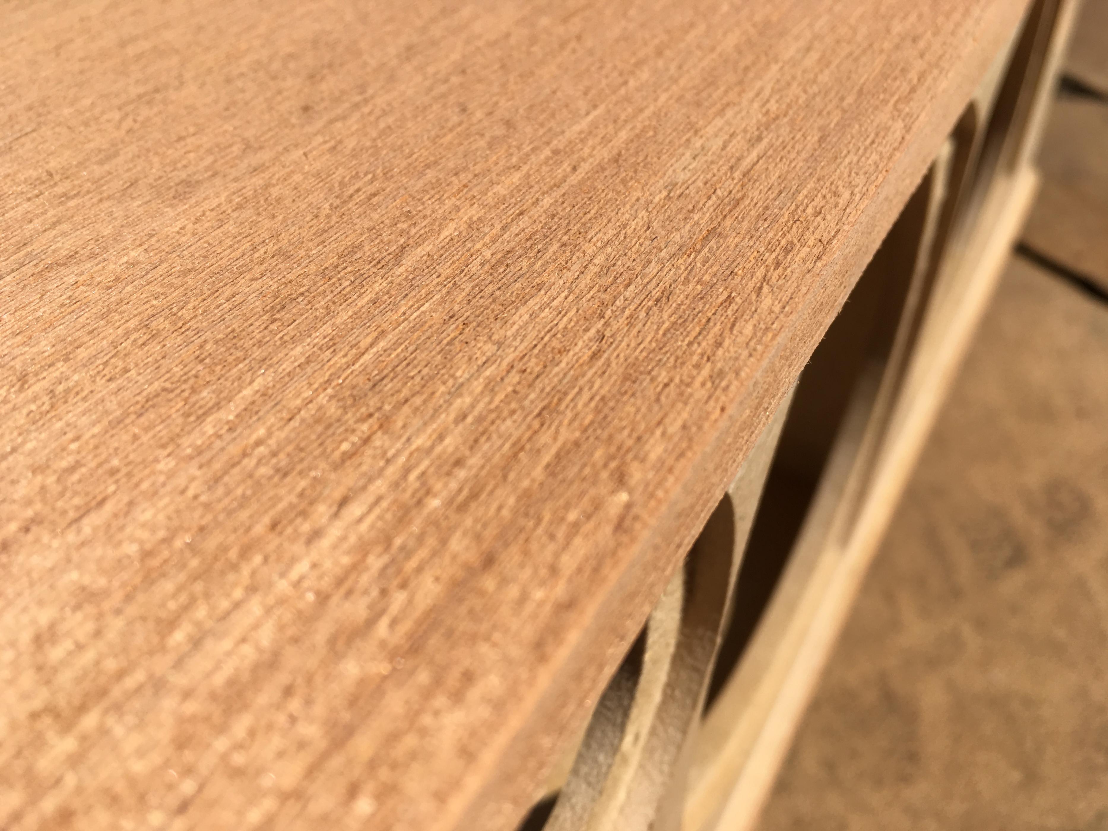

I've still got a lot to learn on the enclosure side of things with regards to tuning. Do you use WinISD for your designs? Also what did you wrap the box in? I was thinking of doing a white enclosure with a grey felt over the front on mine.

I've used Hornresp, way superior than WinISD for more advanced designs, take all possible speakers and simulate them, looking for excursion, how low can you go and etc. And also don't ignore the high frequency response or it will be a pain to make a crossover kater
This a composite veneer from a local store, I don't remember the name but I know its a Brazilian wood
