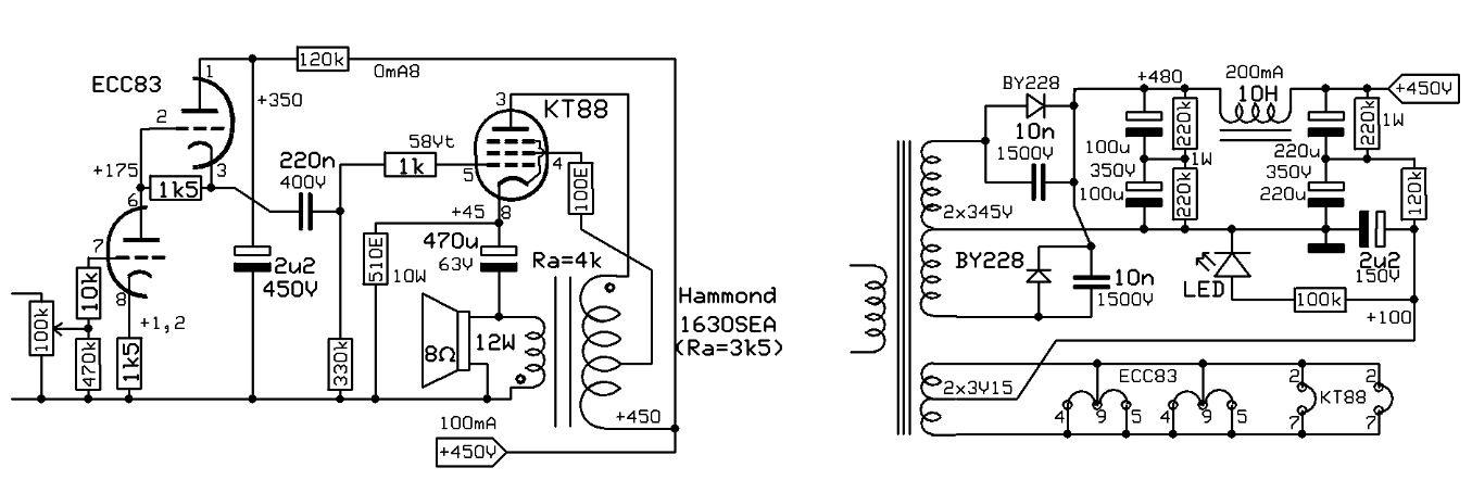

Only joking makes me feel a bit guilty, doesn't help you with your project :guilty: .
So how about something like this ? :idea:
Mona
It's cathode feedback.Lowers the output impedance and distortion. But raises the needed signal level at the control grid (original voltage + speaker voltage)

So that will bring the output impedance level to around +\- 6 Ohms, correct?
