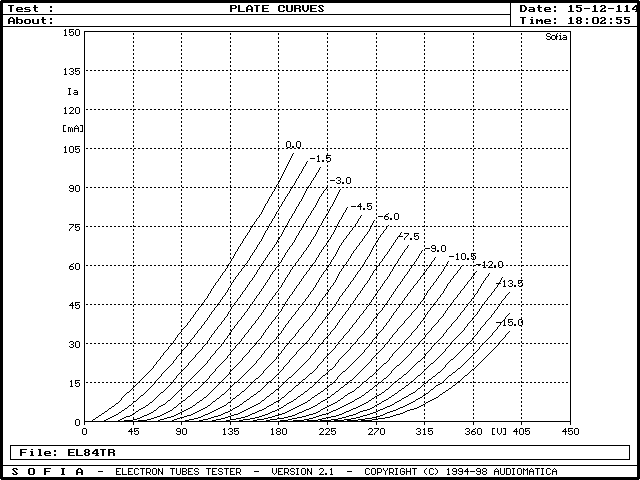

You could also attempt this with the 6P15P russian tube. If you're not going to push B+ to where an EL84 is needed( as in the 6BM8 ) it should do fine. I have these running off a 300V smps with UL output Iron. No issues even at 12W dissipation per tube.
Douglas
This is the EL84 triode
