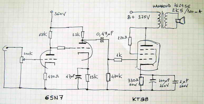

Now I am using the KT88-SE design from Jean Hiraga: http://www.bonavolta.ch/hobby/en/audio/kt88_1.htm with Hammond 1627SE, but I'm not totally satisfied, so I am also going to try Mr. Abdellah's schematic. I suppose the 1627SE will also work for it.

I have built a pair of monoblocks using Mikael's schematic. They sound great! I was struck by the simplicity of the design and felt it would be a good amp to experiment with. Changes if necessary would be very easy.
I used tube rectification with 5U4-G rectifiers. They feed into a 40uF ASC cap, an 8 Henry choke and then a 100uF ASC cap. The result is a very clean power supply. SS rectification would be smaller and less expensive but for this project I wanted to keep things "all tube".
Mikael's schematic calls for an OPT with a 5K primary. I believe the 1627SE is 2.5K. I think it would work and you would have somewhat more power and also higher distortion.
The Hammond 1628SE has a 5K primary but it reportedly has linearity issues. For my monoblocks I used James transformers (6123HS). Here in the US the price was the same as the Hammond 1628SE and most users reported them to be excellent OPTs. After listening for a few months now I have to agree! A real bargain.
Good luck with your project. I'm sure you will be happy with the result, Mikael did a great job with this schematic.

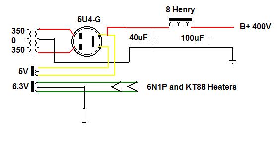

KT88 SE PSU
Mikael, Sherman,
Since I got quite curious about the KT88 you designed/built is it possible to share the schematics for the PSU so we can see how you got your amps powered? Furthermore, can you elaborate about the input sensitivity? Thx in advance.

Here is my PS schematic. Very simple and effective.
As for input sensitivity I haven't measured it but I would guess an input of about a volt would drive it to full power so sources like CD or DVD players or tuners would be fine. For my monoblocks I didn't change anything other than elminating the volume pot and substituting a fixed resistor. So technically they have more sensitivity than a power amp probably should.
A unity gain preamp would be fine as an input. I'm using a preamp with a gain of 5.6 and seldom move the volume control past 9 o'clock but everything works and they sound great.
