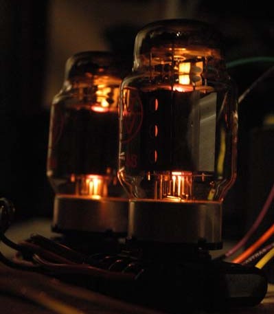

I just finish my SE KT88...
tHIS ONE: http://ptsoundlab.com/sectubes/schemas/kt88/classakt886sn7/classa6sn7kt8811w.htm
http://fr.pg.photos.yahoo.com/ph/icarejy/detail?.dir=9e46&.dnm=cbfa.jpg&.src=ph
The HT=450V so is not too much..it depens of the speaker, you have to be carefullbecause it´s only 10W and it should be good to have at least 94dB for the speakers.

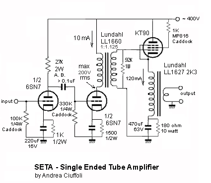

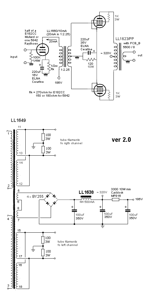

I'm currently building a KT88 amp. Picture attached in following posts.
I'm using a schematic from Andrea Ciuffoli below. This is a push-pull idea, but I'm using a similar idea. I replaced the E182CC with a 6c45pi, running at 10mA with the LL1660, with similar plate voltages.
On the secondary side of the LL1660, I don't use push-pull. Instead, I use SE. Refer to the other schematic from Ciuffoli for a SE circuit on the secondary side of the LL1660. You can easily replace the KT90 with a KT88 with very minor modes (if any at all). I have Plitron transformers.
I also tried putting the tube BELOW the output transformer. You can do it either way. By putting the tube below the output transformer, you have the option of running Triode, Pentode, or UL (if your transformer has a UL tap). I also played with using the output transformer's secondary as cathode feedback on the KT88.
Putting the tube on TOP (cathode follower), you are required to run the KT88 in Triode mode (this can be good). You also get the benefit of cathode feedback via action of the output transformer's primary (which can also be good). The drawback is the input signal to the KT88's grid must be HUGE to compensate for (1) the KT88's triode mode, and (2) the gigantic cathode feedback action of the transformer's primary.
What works for you, works against you. Here's the paradox: the output stage is more linear in this configuration, but the driver stage is pushed harder, creating distortion in the driver stage. By making the output stage more linear, it's forced more of the work onto the driver!
your amp looks fine Kashmire but i won't be using two transformers. Andrea Ciuffoli's designs are worth trying out though, one day i will do an OTL designed by him.
