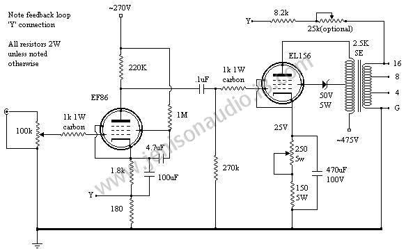

Would this be a better circuit?
The 6550 circuit is much, much more promising.
Thanks ketje. The issues you point out are right and this has made my mind up. The project with that circuit is a no go.

So, what about this circuit? Seems a bit less complicated. Pentode driver is interesting, I have a GM70 amp driven by 6F6. Anyway, please feel free to give me your thoughts about the circuit.

Could function but a bit risky, resistor g1 to ground is 270k where Telefunken says max 100k.You can put the 100k and change the 0.1µ to 0,22µ.Makes the gain EF86 less.Look here, EL156/KT88/6550/KT90 then KT120 Single Ended Amplifier D.I.Y another site from Japan, looks better then the other one.So, what about this circuit? Seems a bit less complicated. Pentode driver is interesting, I have a GM70 amp driven by 6F6. Anyway, please feel free to give me your thoughts about the circuit.

Ok, thanks Mona, wonder why he choose a 270K resistor? There are 2 caps without voltage rating, I guess they ar low voltage. Is there a way to calculate the voltage for them 100uf and 4,7uf from EF86.

I see that the amp designer left the V rating out on the caps 4,7uf & 100uf from the EF86 tube. Can anyone help me calculate the voltage, thanks.

The 4.7uF will see full power supply voltage if the EF86 takes some time to conduct (which they do). I would select a part that's rated for at least 600V.
The 100uF can be very low voltage, but you'll probably find a good selection at 6 or 6.3V.
