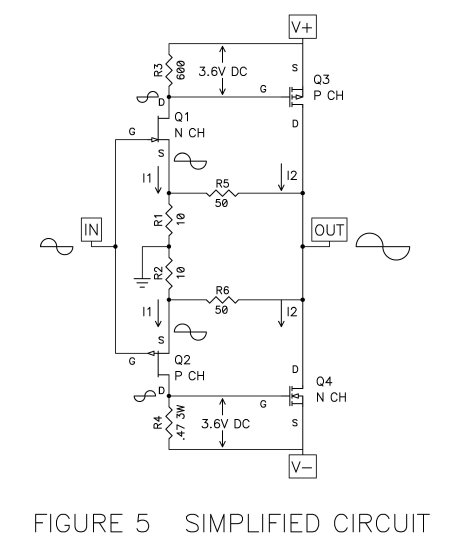

Thanks AJT for posting the schematic. This would be the accompanying text from the manual:
"The feedback mechanism for this amplifier is R3 through R6, a dual pair of low impedance voltage dividers which feed the
output to the Source pins of Q1 and Q2. Low impedance feedback has been (incorrectly) referred to as “current feedback”,
and it is popular in simple high-speed linear circuits. One of the charms of this arrangement is that unlike the classic two
transistor differential pair, the drive current available exceeds the bias of the input stage.
Something different about this example is that each JFET has its own feedback – there are two separate feedback loops to
this amplifier, so that the loop of Q1/Q3 is independent of the loop for Q2/Q4."
The Schade type of feedback (output tube anode to output tube grid feedback) has definitely nothing to do with that topology.
There are two stages in the F5. The feedback goes from the _output_ to the sources of the _input_ transistors. The feedback loop contains both stages, if this is not global what is ?
Its a subtle difference but the reality is that it goes from the source to the gate of the output stage. Its the same as Schade feedback and that generally understood to be a form of local rather than global feedback.
It is a much more significant issue in valve amps where the OT becomes part of the global feedback loop.

Feedback from the output to the source/cathode/emitter of an input transistor looks rather like global feedback to me. Note that there is not a solid dividing line between global and local feedback, although local feedback is often regarded as being around one stage only. Here it is around two stages. It is quite different from so-called Schade feedback, which goes to the output of the preceding stage and so could be regarded as local feedback around the output stage.
So: 'Schade' is local f/b, but this isn't 'Schade'.
There is no "other" version. The schematic AJT posted is the original schematic by Nelson Pass which definitely uses global feedback and bears no relation to Schade feedback.
The simplified schematic by Nelson Pass is no different in this regard BTW.
(It only omits the current limiter and bias regulation.)
If you read the article there is a schematic just above the text which AJT posted. Go check it.
He included it so that he could describe the concepts more clearly without all the added complexity of the helper components.

See above.
There is no direct feedback from the drains to the gates of Q3 or Q4.
