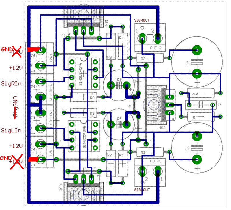

single side layout using 2 single op amp coming from a non EE trained personnel.
Looks nice and compact.
One or two remarks:
-I don't see a continuity between the power supplies and signal grounds.
-If the power supplies are off board, which is the case here, it is a good idea to provide a local decoupling, 2x100µF (or more) for example.
-The inputs are DC- coupled. This may be fine in many cases, but it could be problematic too.
Including an AC coupling on board would be a good idea, it can always be strapped if not needed.
-Remember that in this version, for 8R speaker driving, the total quiescent power dissipated is ~20W, which requires hefty heatsinks (and ~1A supplies).
For 32R loads, R1 could be increased from 1.5R to 5.6 or 6.2R for a more reasonable dissipation

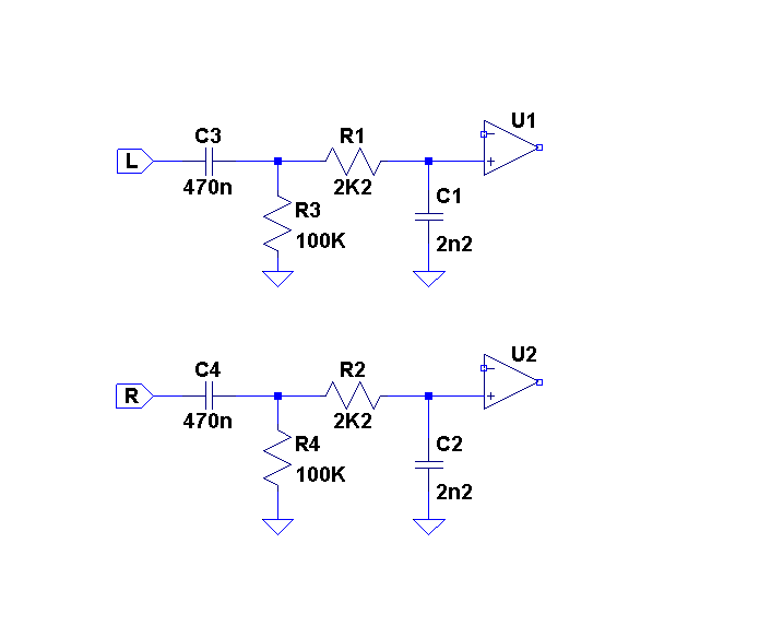

Below is an example of suitable combined DC/RF filter
that RF filter (4.84us) is already down by ~1dB @ 17kHz. It's become an RF + Audio filter.
That is correct, I recognize it is a rather heavy-handed approach.
But the FPW bandwidth is only 30KHz, and by default I prefer to make sure the max SR is never exceeded.
The capacitor can be reduced to 1nF or even less, it will then have no discernible effect on the audio spectrum.
hi,
would like to get the layout correct in the continuity between the power supplies and signal grounds as elvee mentioned.
if i were to use dual power supply with +12V 0V -12V how would it be connected to the schematic?
A to a
C to c
what about B?
Thanks in advance

Now your pic is visible, so:hi,
A to a
C to c
what about B?
Thanks in advance
A to a
B to d, e and gnd
C to c
hi all,
Layout changes to address the below:
1) Continuity between the power supplies and signal grounds (note that signal in & out grd is not connected in the layout and uses dual power PSU).
2) Increse heatsink size
3) Added DC/RF filter to the input.

I think it is better to put all LM317 on one side, at edge of board, so that people could use their choice of heatsink. Also, the trace width for supplies as well as the output is thin.
Using the supply wires to ensure the integrity of GND connections will most likely bring you problems, like HF oscillations and crosstalk.
Also remember that R2 and R3 are the loads, that's where the signal out connections should be made.
And there is no provision for a local decoupling, that's also likely to cause instabilities.
