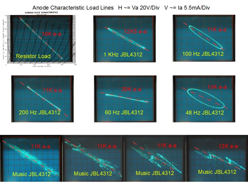

For example, here's what a load line looks like playing music into a speaker. The H axis is plate voltage and the V axis is plate current. This is a triode amp playing on a 3 way box speaker showing various plate load line resistances superimposed, with some sine tones for reference.
Notice that as the plate load impedance goes from 10K to 20K ohms at a speaker peak, the plate voltage swing (horizontal axis) doesn't increase very much. An undamped pentode may behave differently, but here we're talking about triode mode.

Michael, those pictures are great! It's very interesting to see just how much the loadline changes as the frequency changes.
