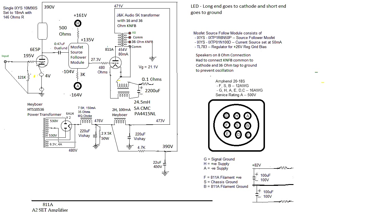

Here is a 811A Amp I have built using source follower to drive the grid of 811
The filament and source follower supply are on a separate chassis. For the 811A filament supply, I was initially using LCRCL supply, and then changed to meanwell's SMPS supply, and did not hear any difference and its cheaper and less bulky
Schematic attached
Can someone recommend a good SE output transformer for 811A.
It should have 10k primary impedance and 8 and 4 ohms outputs.
I have prototyped with Edcor GXSE15-10k, but I am not happy with it's bass end performance, which is likely due to too low primary inductance.
