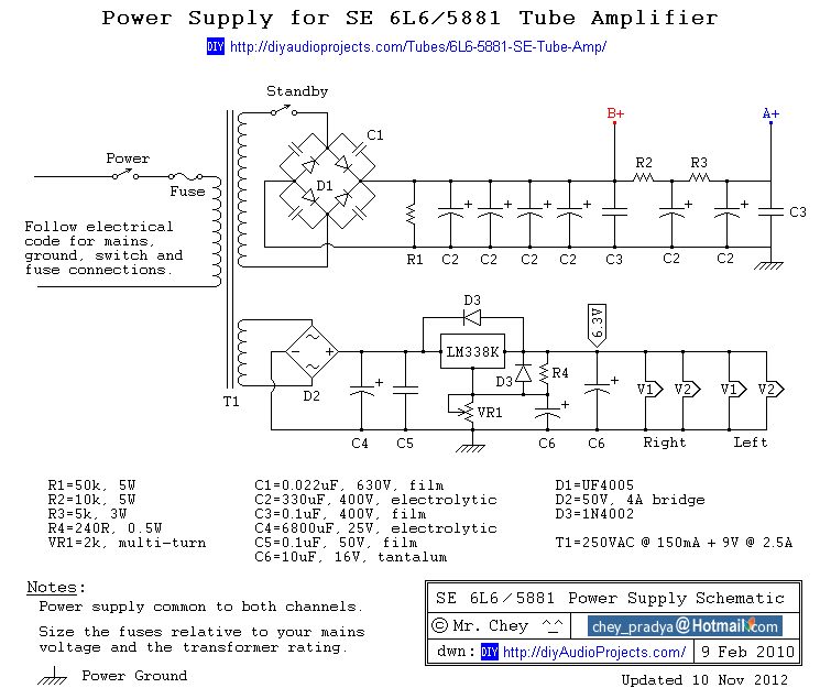

I'm planning to build this amp:
DIY Single-Ended (SE) 6L6 / 5881 Tube Amplifier
I have a 10H choke. So what is better? or what you prefer?

The original designed power supply is for a 250V transformer:
250V*1.41= 352.5V
My transformer is a 260V, so:
260V*1.41 = 366.6V
Voltage drop across de choke is:
0.150*110= 16.5V
My voltage transformer subtract the choke voltage drop is:
366.6V-16.5V= 350,1V
That is very close to the original recommended transformer. This would be correct for my transformer specs?

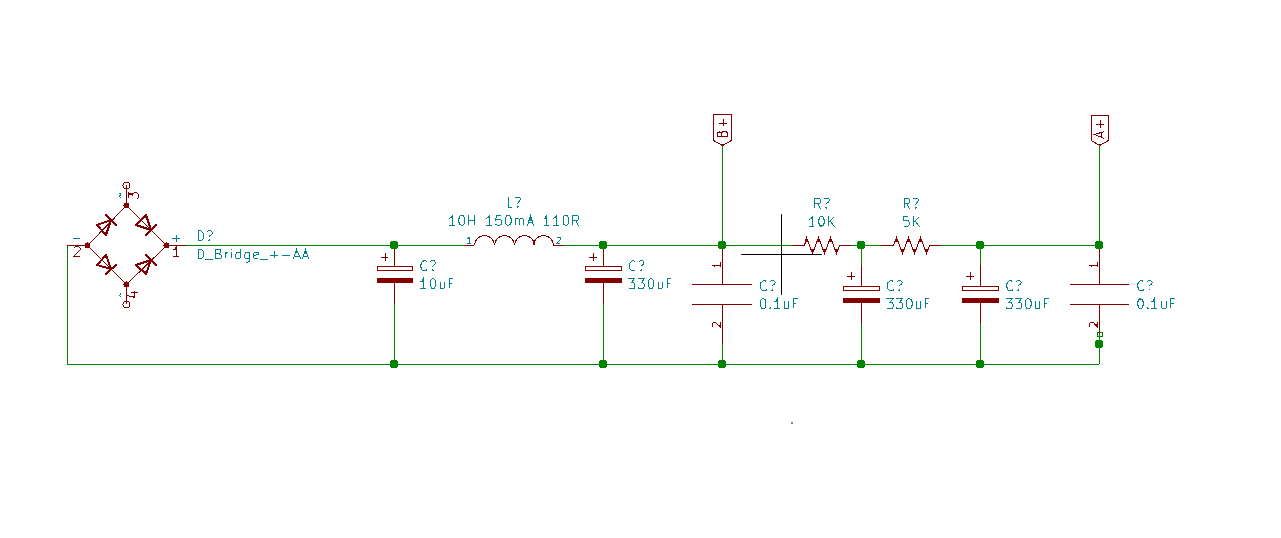

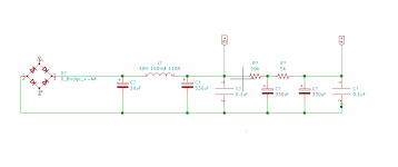

Can’t the OP just use cap input filter, with a choke arter the cap? He has the transformer?
If you Google for ‘PSUD2’, there is a simulator tool that can be downloaded where you can try out different permutations of filtering.

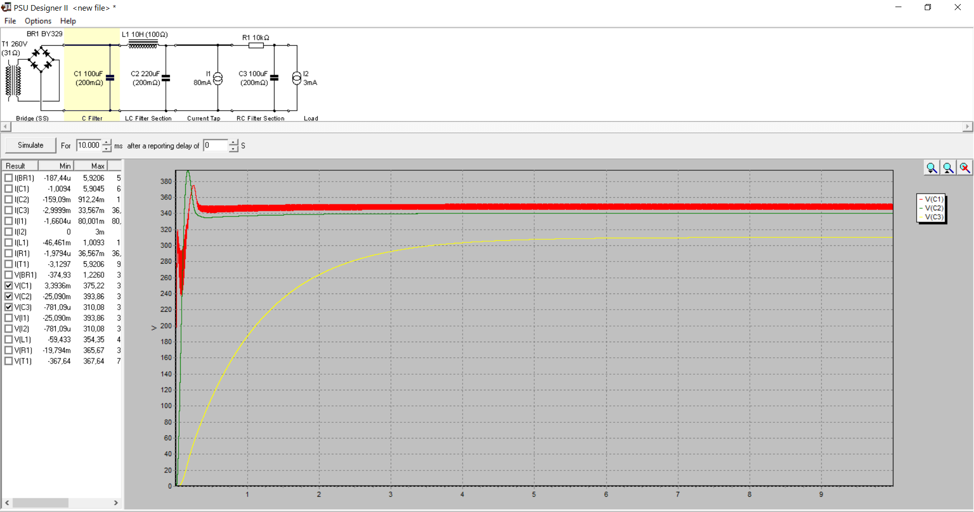

Anyway to answer your question, your transformer can be around 250-270VAC 150mA per channel, so either two single ones of 150mA or one big one of 300mA.
Heres a quick simulation i have done in PSUD2 for the power supply, some more experienced designers will most certainly chime in about the capacitor values.
The program to open .PSU files can be found here:
PSUD2
Cheers!
