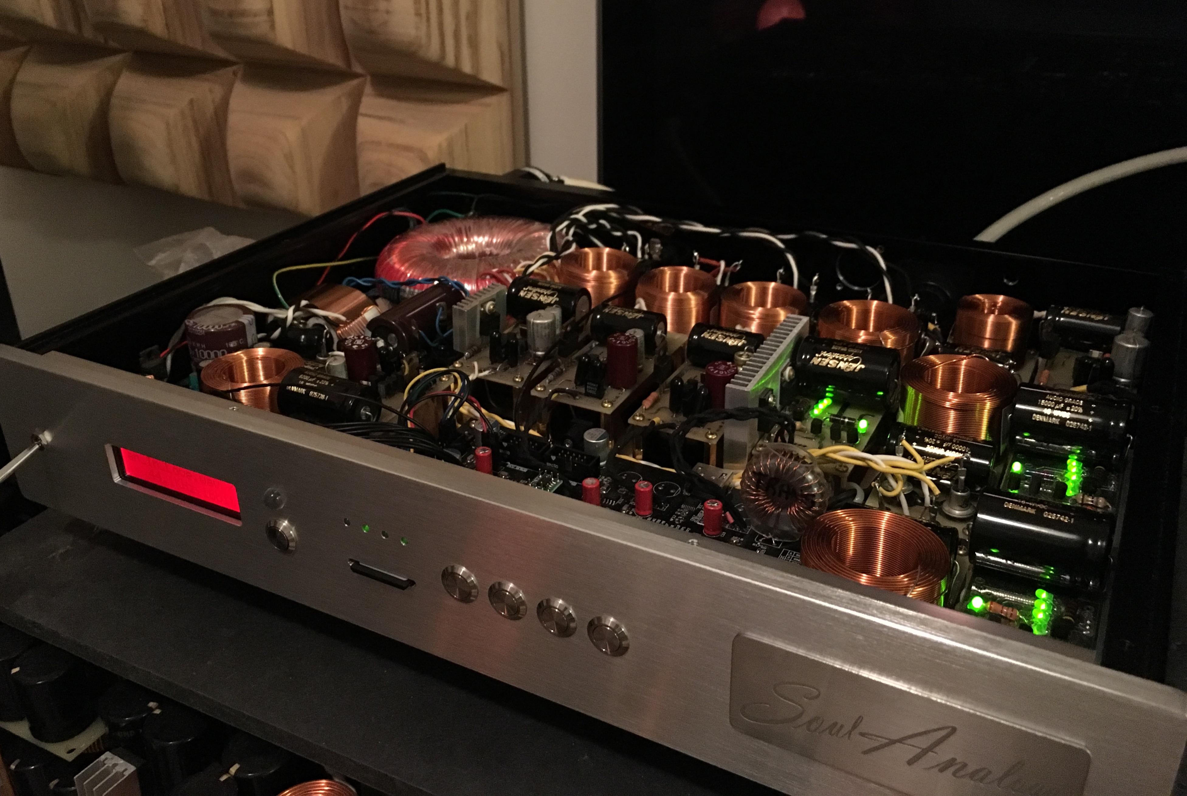

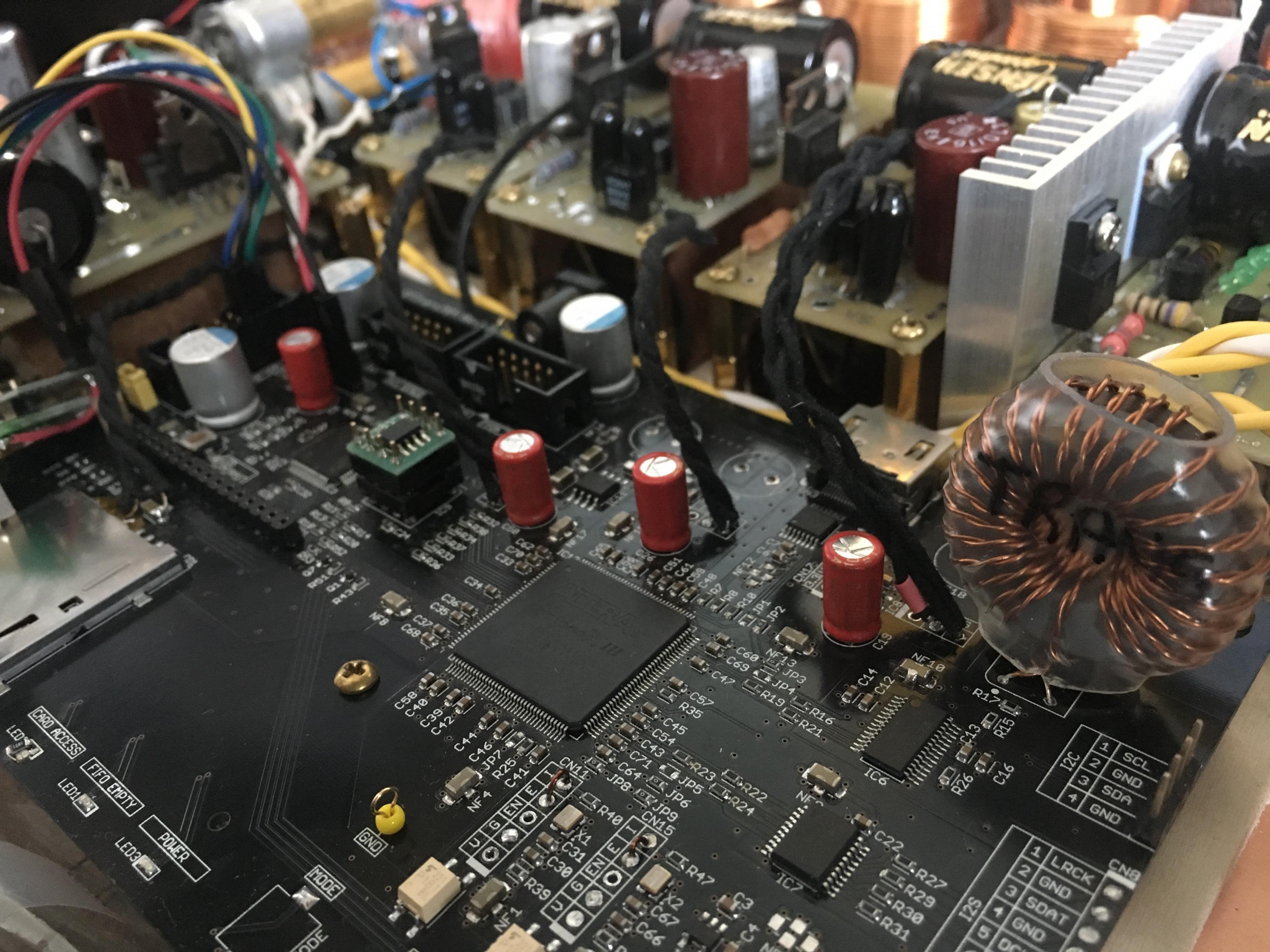

The SDtrans384 player has been one of the best sounding digital player I have owned so far.
I have spent over 6 months on it and just completed the mod with better chassis and with all discrete linear power supplies.
Totally 9 sets of PSU supplying the SD card, FPGA chips, clocks and display + remote module
Onboard filter caps changed to Blackgate NX
attachment.php
attachment.php
Question: is there anybody successfully changed the clocks with better ones? I mean with auto select of clock signal according to the bit rate of the music files...
Thanks!

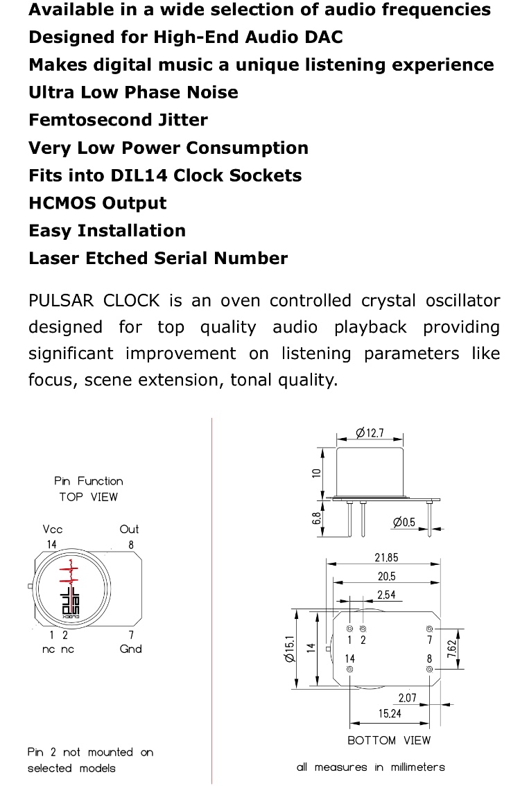

In Japan, there is two users those who tried upgrade of Clocks. Both connected external clocks, Pulsar OCXO as well as NDK DuCULoN OCXO. I’m not sure Pulsar is still available in a market. Pulsar will provide better SQ and DuCULoN will do far better. However, your selection may depend on your DIY policy and budget plan.

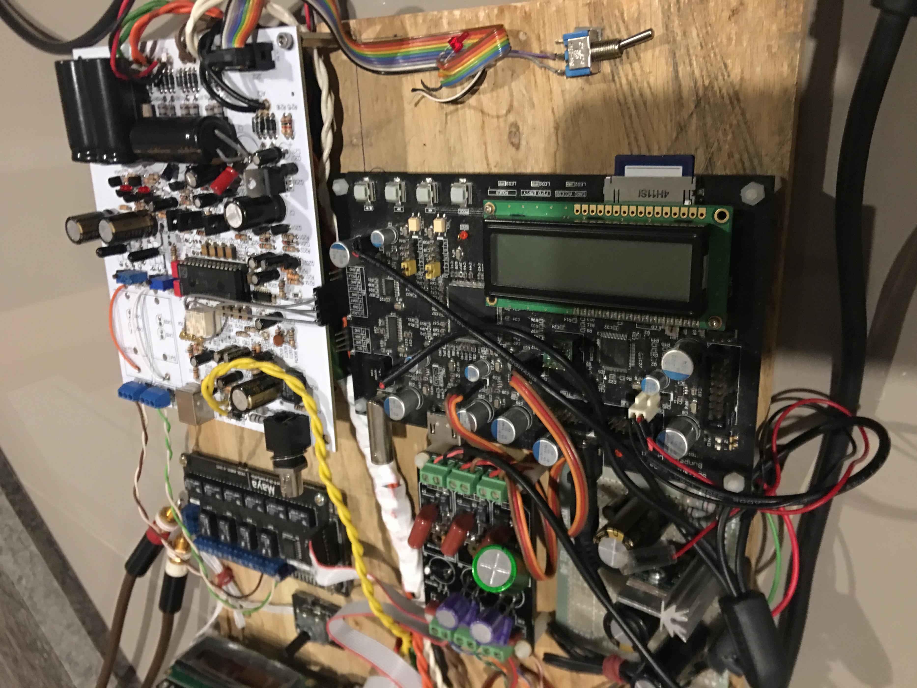

Wow very nice mega work involved. I too have done a fair bit of mods to mine but I've
taken a slightly different approach. Yes I'm running independent discrete regulators too.
On SdTrans just using stock caps with Sun copper bypass caps. What I found affects sound most is at the psu of the discrete regs, real surprise here. For me I've tweaked the SdTrans to work in sync with my AyA DS dac cause I'm running I2S connection. AyA too has been highly tweaked. Still in bare bones plywood mount but looking for a nice box to install.

But anyway the biggest technical difficulty is to let SDtrans to auto select which clock crystal to use, if the OCXO has no EN/SB pin...
Pulsar OCXO has an enable/disable pin. You can use it.
NDK DuCULoN bipolar output type has no corresponding function. In my case, a socket is employed for DuCULoN and two DuCULoN units are manually changed.
Adopting a mechanical relay might be one alternative good way.

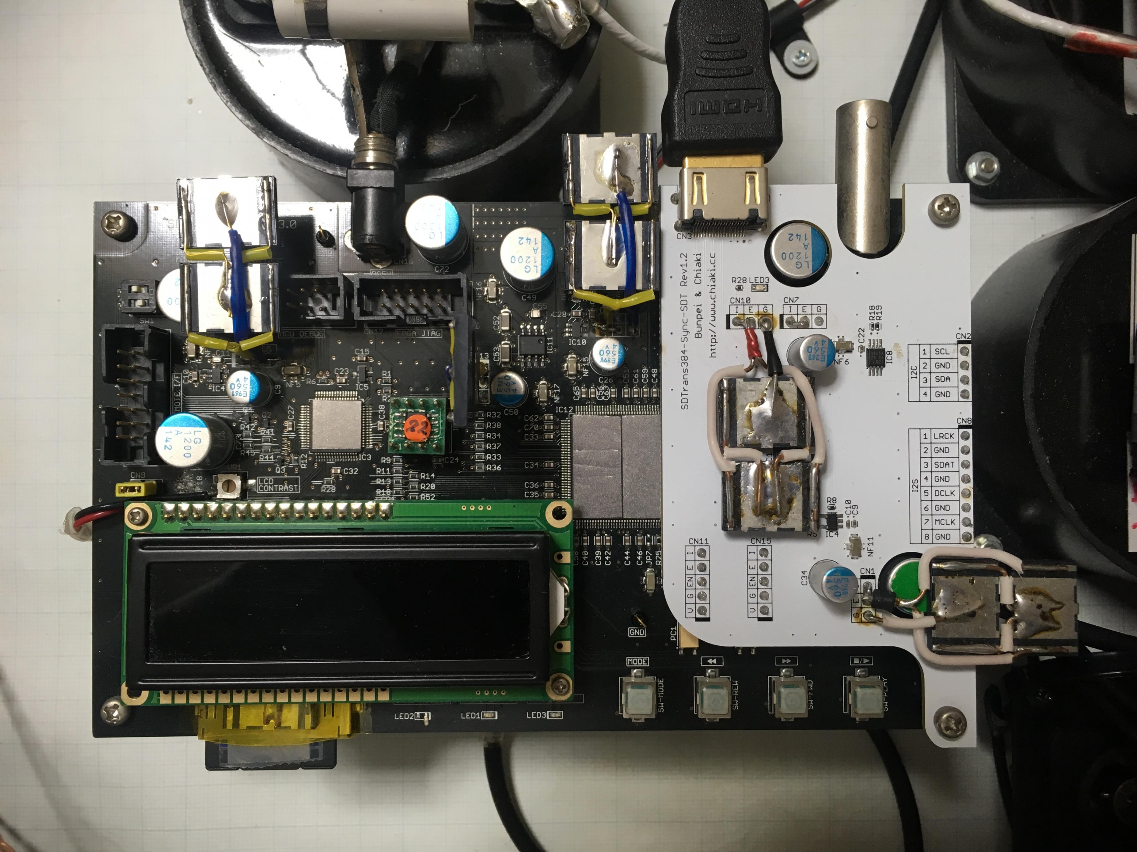

My best mod recommendation is adding this capacitor, NEC/Tokin Proadlizer, to an existing Aluminum Electrolytic Capacitor on board in parallel.
https://www.nec.com/en/global/techrep/journal/g06/n05/pdf/t060514.pdf
The product, Proadlizer, was originally developed and applied as a decoupling capacitor for CPU in a notebook computer. However, they had a quality problem on Toshiba DynaBook and discontinued the product. Some stock pieces can be available in eBay.
Type number, “0E128”, is 2.5V 1200uF. No higher voltage type is available. In my case, I put two pieces in serial when I apply them to DC +3.3V or +5.0V power line.
A typical price in eBay is 5-6 USD/each. Once you experience its effectiveness, you may think that price is reasonable.
The capacitor has a size of typical post stamp.
Attached photo shows my application as an example.

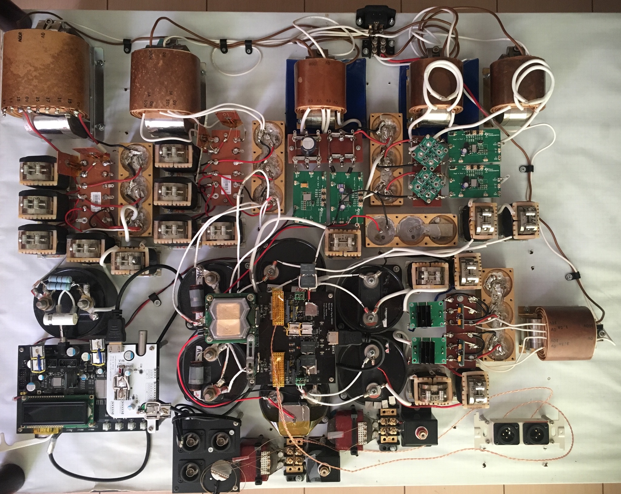

My system is shown on the attached photo. I had been very busy for enhancing PSUs for my DAC part until recent times.
For my SDTrans384 part, I provide two DC +5V power lines. One for main and another for LCD back light.
From now on, I think I can concentrate on PSU for SDTrans384 part.

Thanks again Bunpei. Like you I’ve been tweaking my how set up from speakers, amp, dac & Sdtrans. What I have discovered is no matter how quiet your regulators are, nothing is as important as the main psu caps. What brand, values & bypass, greatly affects the sound. My last tweak was focus on SdTrans cause my original thoughts was since Im already supplying very low noise discrete regs, sound should be great but when I started to play with PS caps, omg how could it be, the sound improve vastly, I was really really surprise that this could happen on digital side. Moral of story, just because you’ve got low noise regs it doesn’t mean that mains noise will not break through. Oh another thing the 2.5 & 1.2 v are highly sensitive I use higher uf value PS caps on 1.2 over the 2.5v

Checking from the pulsar ocxo datasheet, i still cannot figure out how to enable/disable the ocxo by its pins
Please shed some light .... :cheerful:
Hi, insatiable!
I’m very sorry that I left your question unreplied!
My memory was incorrect and you are right. According to the data sheet, Pulsar OCXO has no output control pin.
I think the best way is to incorporate a mechanical relay designed for high frequency applications.
