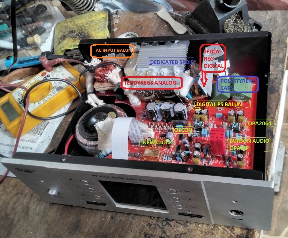

Fortunatelly, I have here a humble but well built SD Card Player of Chinese Origin, a HiFi360.cn machine, with two SD Card slots and which has dual PCM1794 DACs (IF I remember correctly) had a passable sound in stock version and a competent Headphone out.
Of course, it did not stay in stock version for very long....I list below the upgrades which made it a very decent (as My Mom says) player...
-Reicherts Bifilar Current Baluns on AC input (varnished with Heavy Duty Varnish), and between PS caps and Voltage Regulators, both to Digital and to Analog (on PCB bottom) sections: 4 in total.
-Replacement VRegs for teddyregs, due to space cosntraints. The Heatsinks occult the former.
-Precision Clock.
-Dedicated 5V SPDIF out, to be used as transport with Elektro-optik connection to an outboard DAC.
-Many other caps, Pana FM and Rubycon Z on the output section.
-OPA2064 in class A, 3 in total: 2 for the stereo unbalanced out and one for the Headphone out, which receives the signal from the former.
The upgraded "Baluned" Regulated supply took it to a level where I could use it as only source for a whole week during my recent holidays, using my Beyerdinamic DT990 PRO.

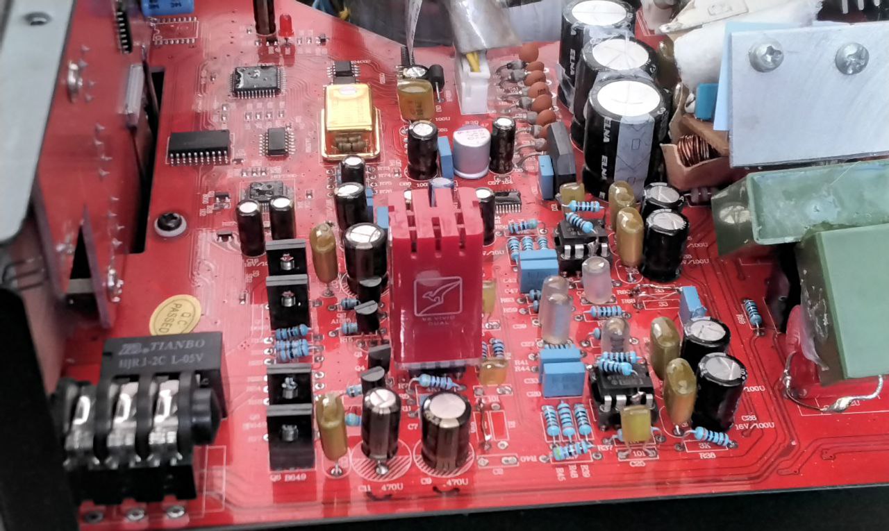

I swapped the Headphone section opamp from OPA2064 to Burson Audio V6 Vivid very easilly, though I consider that the pins that come with the unit are slightly thinner than what I am acustomed to. Looked fragile to me so I was careful.
Luckily, the overall tonal balance of the Burson mirrors the one of the OPA2064, which is no surprise you might say, as this opamp receives the signal from the previous unbalanced out opamps which are indeed OPA2064 (more on that later), yes but it sounds like the OPA on steroids, and after a week or of use I confirm that this is a significant upgrade, soundwise.

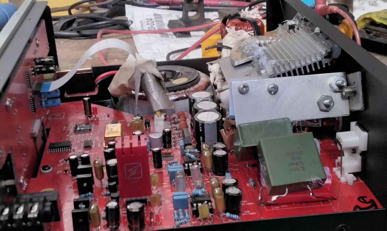

I did not mention that I also paralleled a 280nF Polystyrene Russian Military surplus cap (the green box at the lower right corner of the last picture) to the stock unbalanced output cap. It looks awful but sounds great.
These Polystyrene caps are very good and affordable for this task. I use them a lot.

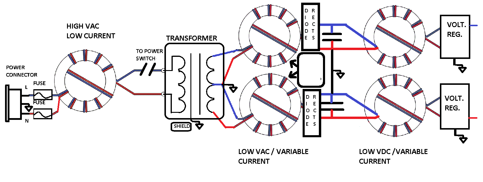

I did not explain fully my present aproach to the power suply: it is a modified CLC, with the L being a Bifilar winding Reisert Current Balun that treats obviously the power rail but also treats the Ground current, which IMHO deals with both common and differential mode noise.... Now that I have a High Temperature- High Voltage varnish, there will be no safety concerns from the part of our distinguished coleagues.
Edit: I attached a pic with description of parts. As I said, the Baluns for the analog supply are on the bottom side of the PCB, well protected.
Edit 2: I found one conceptual diagram of the said power supply. Here, the baluns for the TX secondary windings are not fitted....

As I stated before, this players has its stock VRegs changed for TEDDYREGs, discretes Voltage Regulators designed by Teddy Pardo. I have other special type of VRegs but they are larger so they do not fit in the limited space of this player. If you look carefully, you will see on the last picture I uploaded the bottom side of the two PCBs of the ones marked as "TEDDYREGS ANALOG", meaning the VRegs for the analog output section, and the side of the "TEDDYREG DIGITAL" for the PS of the digital section, all secured though big heatsinks to chassis.
Teddy Pardo has other VRges. If you are not aquainted with his work, here is a link:
https://teddypardo.com/product-category/diy/
