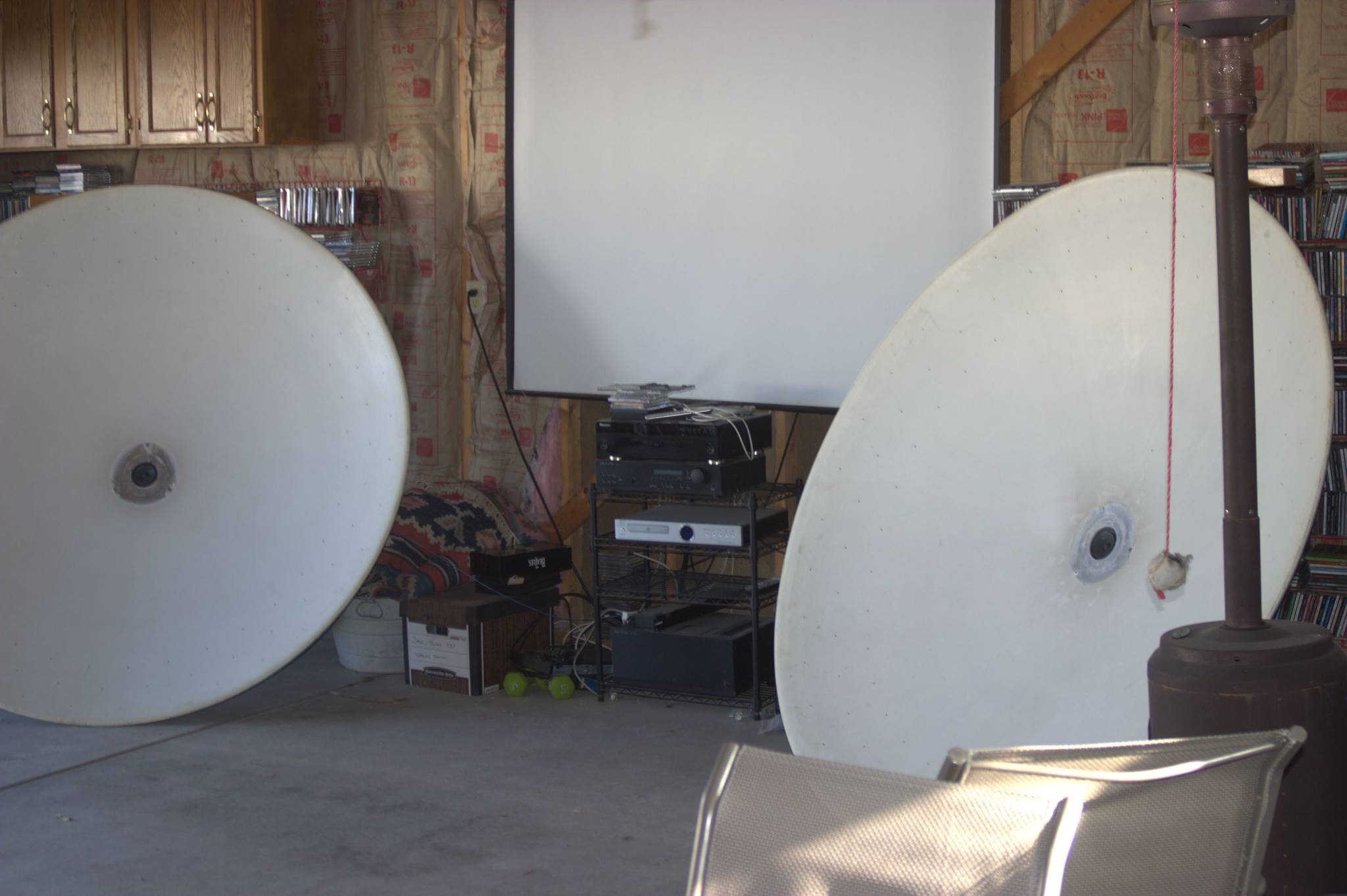

I've had pretty good luck with the Dayton Audio point source drivers. Here are 3 inch drivers with a 6 foot baffle/horn (not sure what to call them exactly they are aluminium light reflectors from an industrial building), but they are fun and get better all the time as they get broken in. The frequencies 100hz and down is covered by a subwoofer.

Good creativity there. 🙂

Love them 🙂
I don't quite have room for 2x6' circles though 🙁
