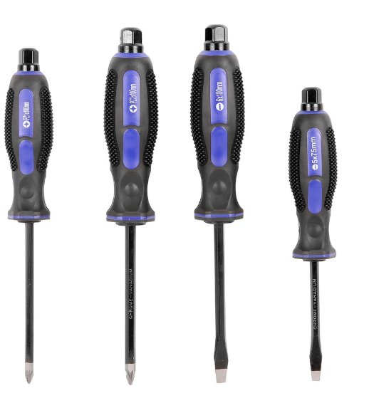

At work usually a few hard taps with a hammer on a hammer through screwdriver is enough to shock them free.
