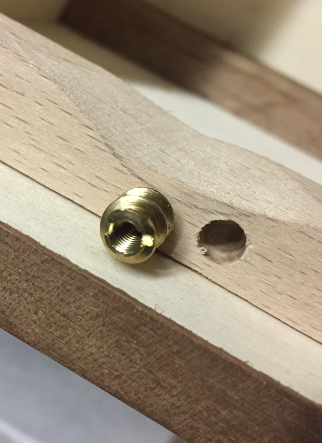

the chromed ones are butter. these pure brass ones, used for a version of my LS 3/5a box, are perfect.
in my case, they are mounted from behind / inside. the slats of the box frame, where the front rests, are drilled with a 4.5mm bit before being glued, then I drill the hole to insert the 6mm inserts from the inside without coming out on the front. in practice the insert works in the internal half of its thickness (ls3/5a - slats of beech wood / or hard wood of 16/18mm squared) at this point when the brass insert reaches the stop it blocks and does not move anymore. I have seen many try to use the threaded inserts on the front and since they are things to be made with extreme precision, they ended up tearing the insert while screwing the front LS 3/5a.
