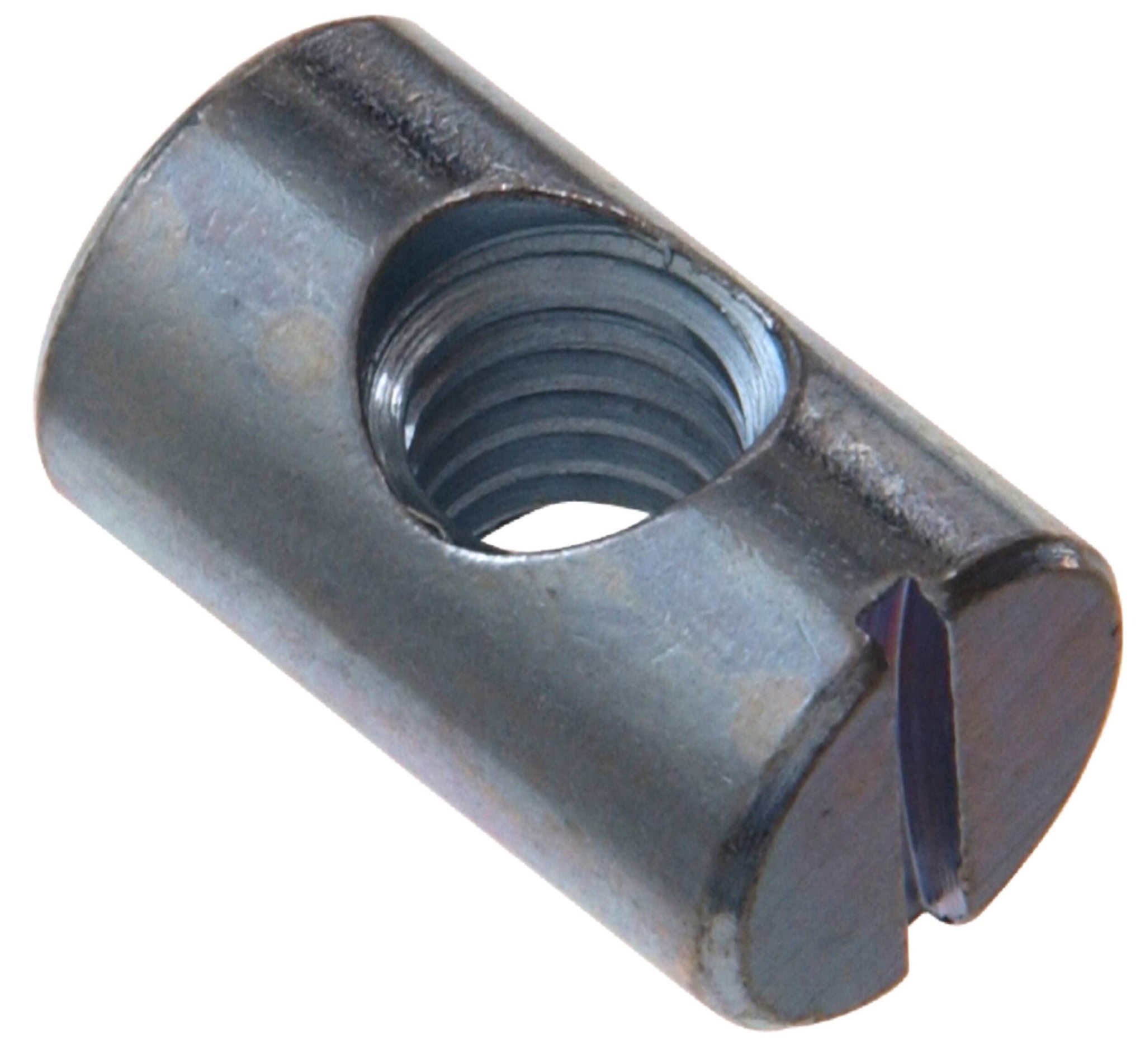

We get nuts for MDF here, basically a small pipe with internal threads, and a sheet metal piece with notches, M6 is a common size.
When you tighten it, the notches hold the nut in place in the wood, as the nut is pulled in from the side of the screw (usually a washer is used)
A random net image, so you can understand, no ties.

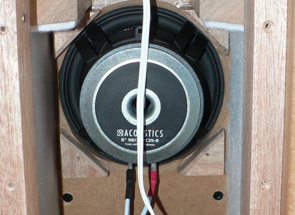

I've used the PVA method for decades and has never let me down. Drill the hole, drive the screw and remove to form the thread and add PVA pushing through with a wire as required. It soaks into the thread adding strength. Some builds have hardwood blocks glued behind to baffle which also allows for long screws. The other thing is to countersink the start of the hole to prevent raised mounding and can be seen on the back panel supports.
If a hole ever strips then drill out and add a non flanged straight ribbed masonry plastic plug.
The idea is not to over tighten. I've never had luck with inserts or T-nuts.
