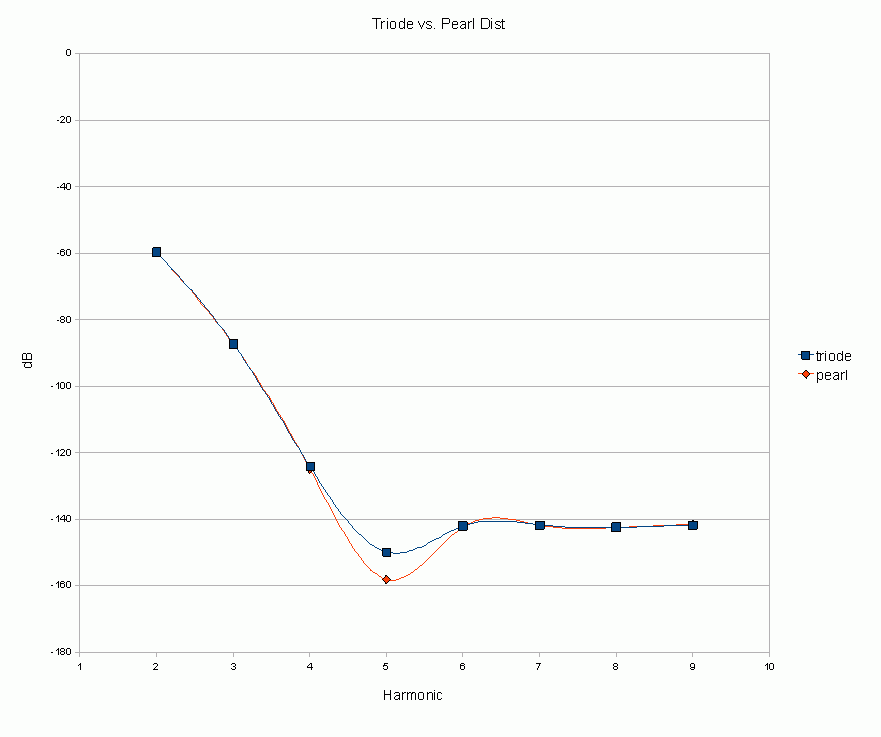

For fun I ran a Spice analysis of an ideal version of Pearl's config against a true triode connection. An EL84 was driven directly by an ideal AC voltage source. Ideal DC voltage sources provided cathode bias and plate-screen bias. Distortion figures were compared between the plate-screen voltage set to an arbitrary low number (0.001 VDC) and a 31.5 VDC approximation of Pearl's circuit. The plate load was an 8kohm resistor, input set to 2 VAC 0-p. Pearl's circuit required a grid-cathode voltage of 6.42 VDC against the triode's 8 VDC to maintain the same 41.5ma IP and 250-251 VDC Vpk. Results below, conclusions none. =D
Johan Potgieter said:Seems you and I missed something in our technical upbringing, Anatoliy.![]()
