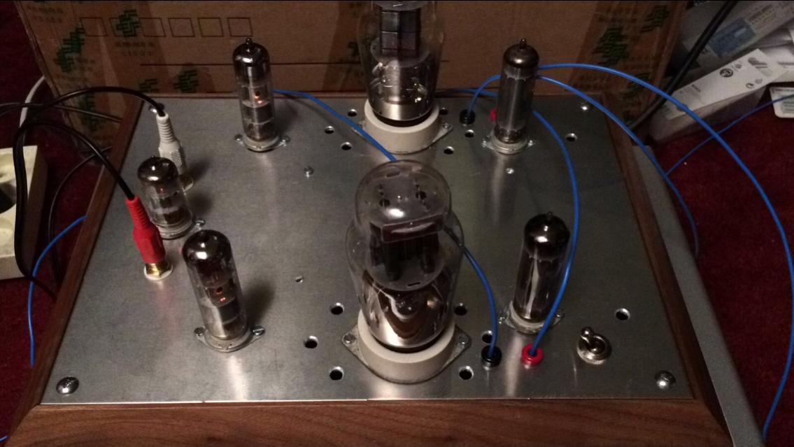

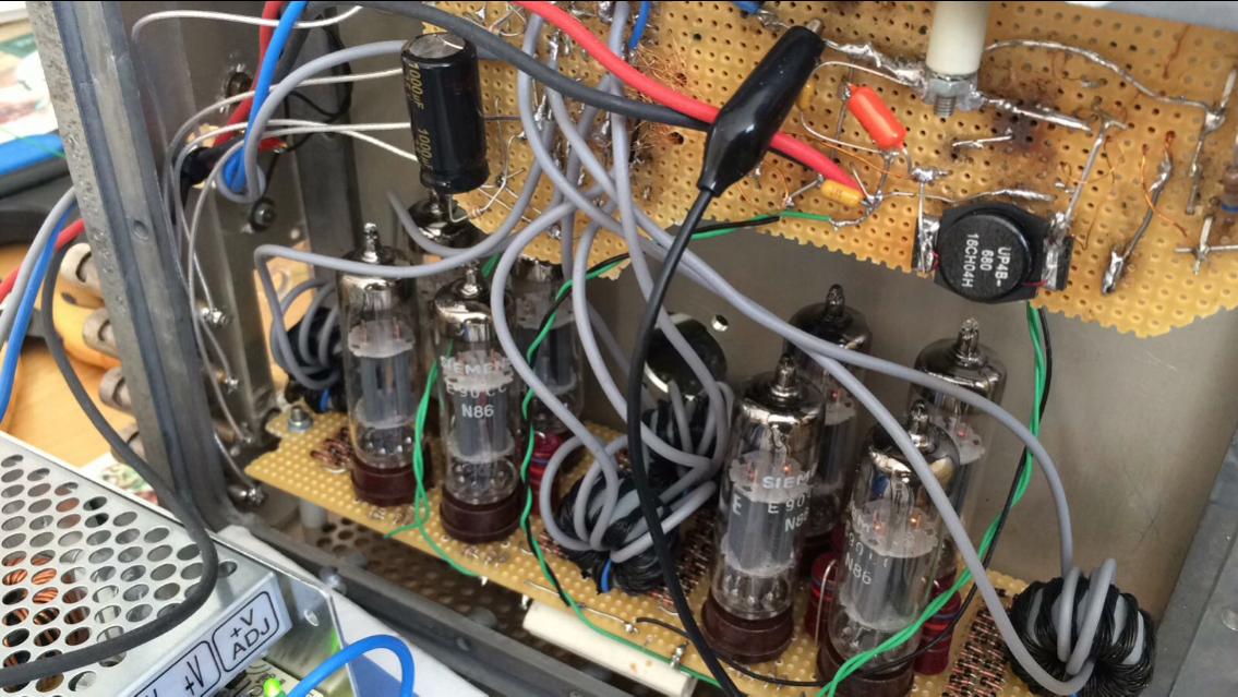

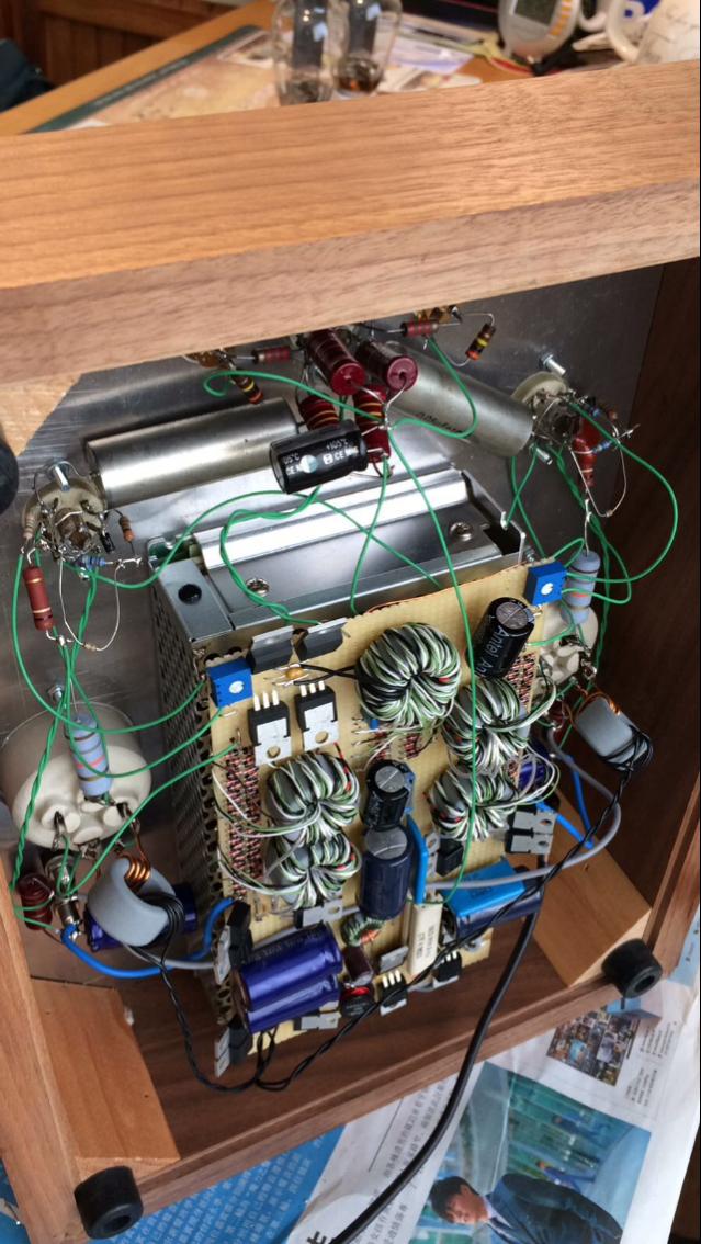

Screen driven 6V6 SET a la ZOTL
On the pictures stil with a power triode but 6v6 in this amp is better still when driven on screen.

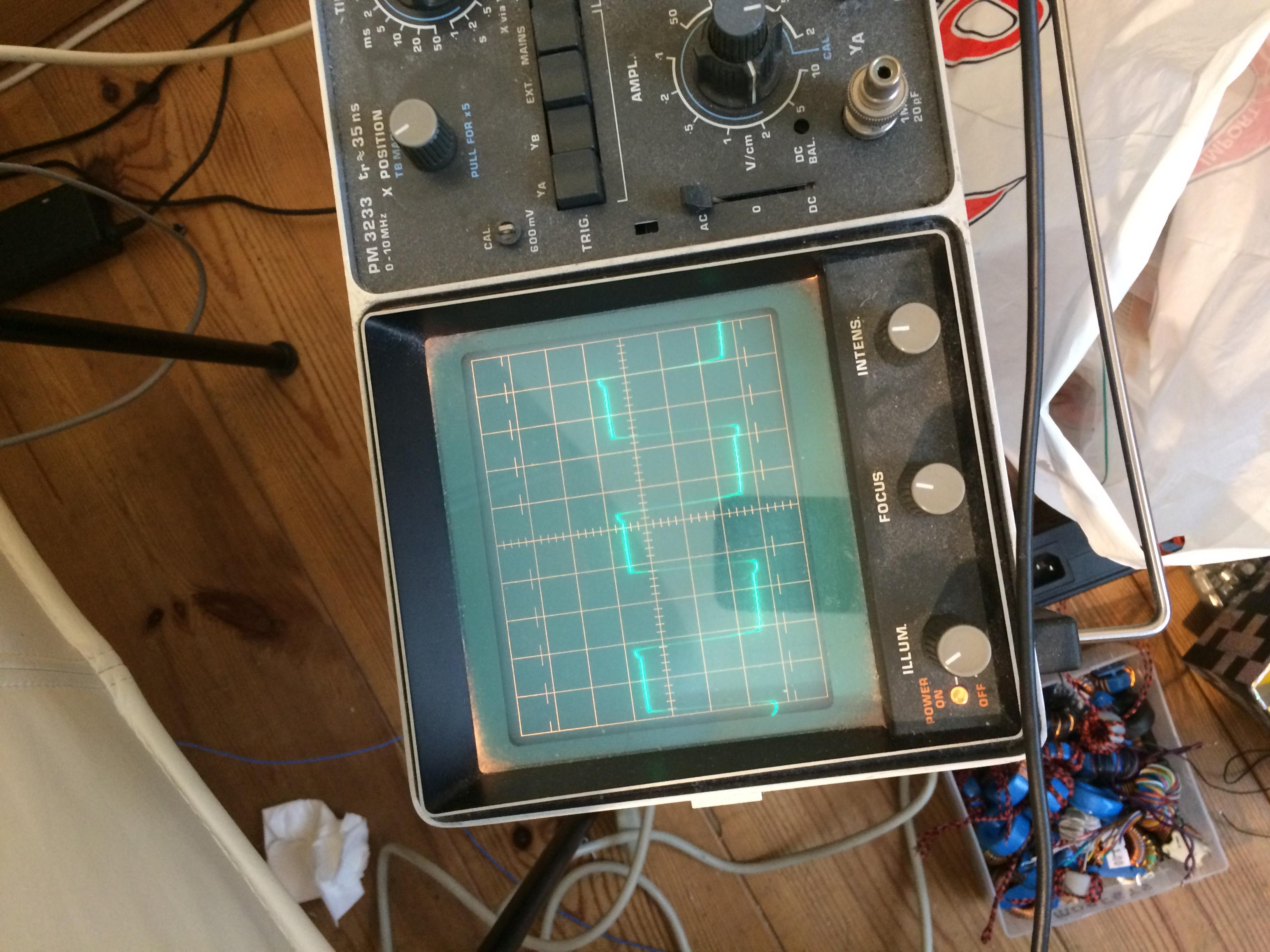

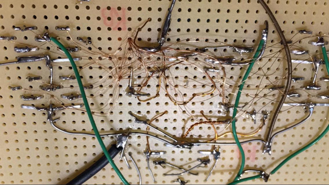

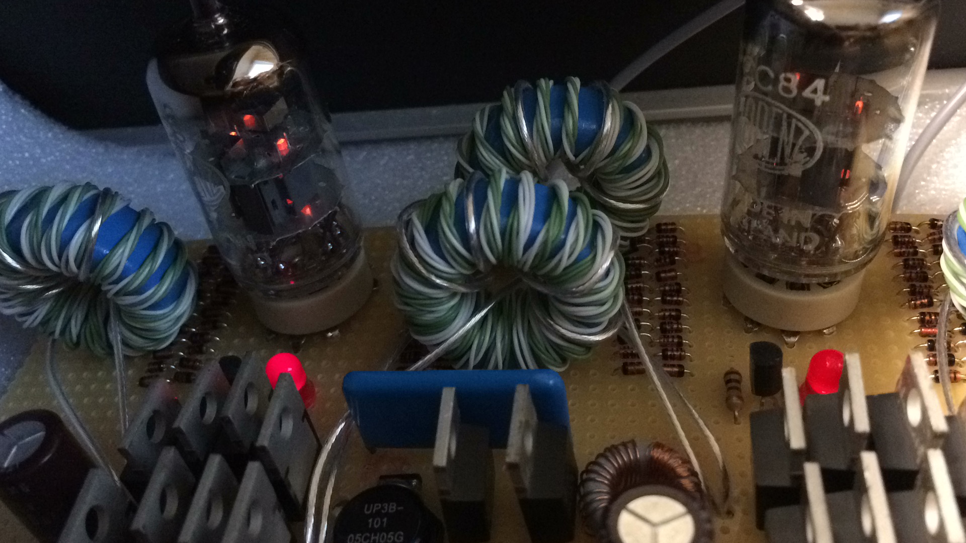

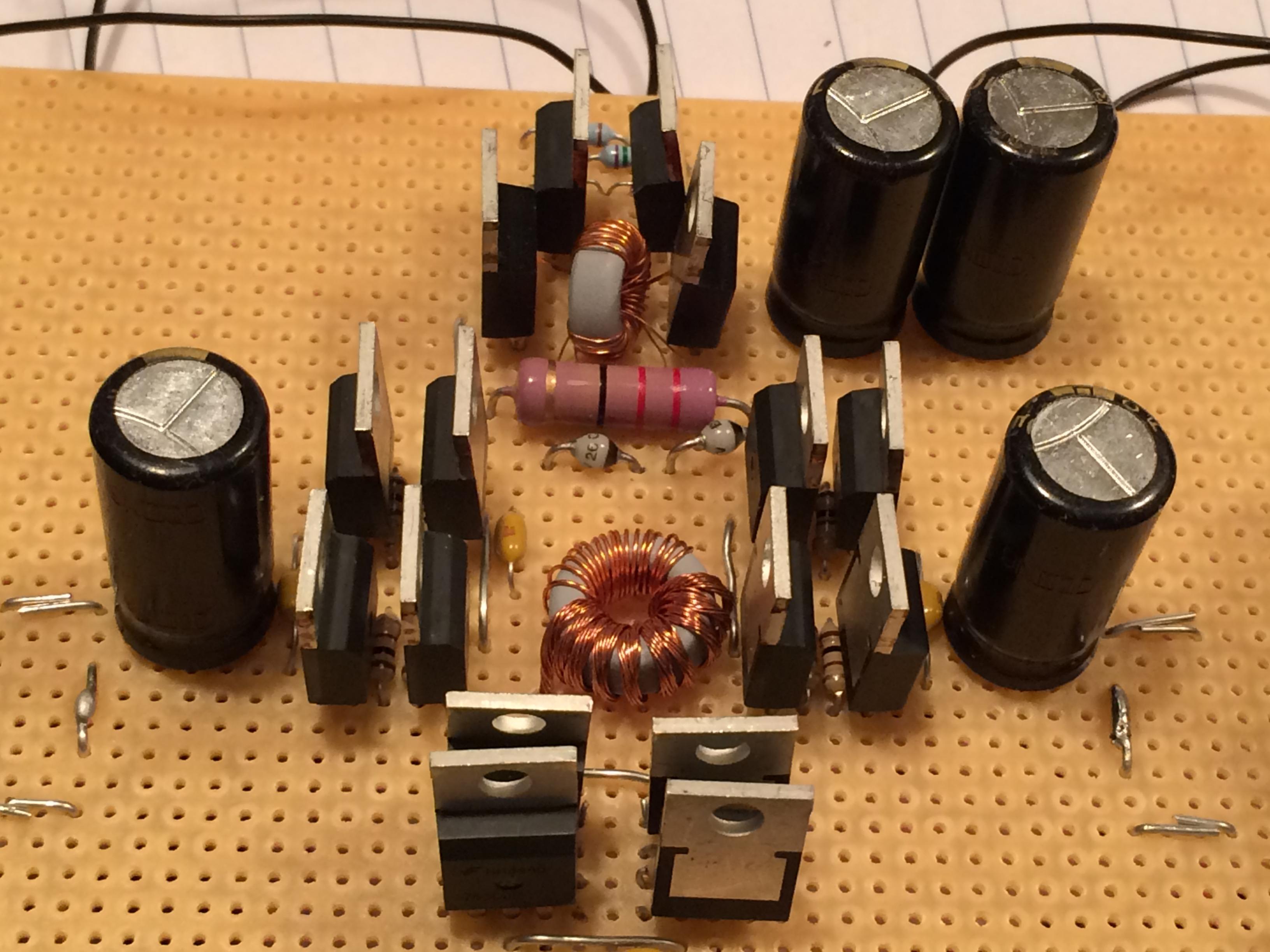

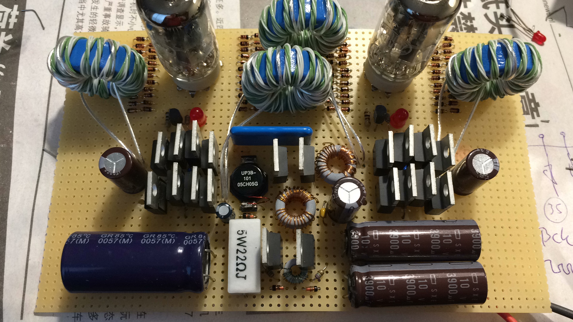

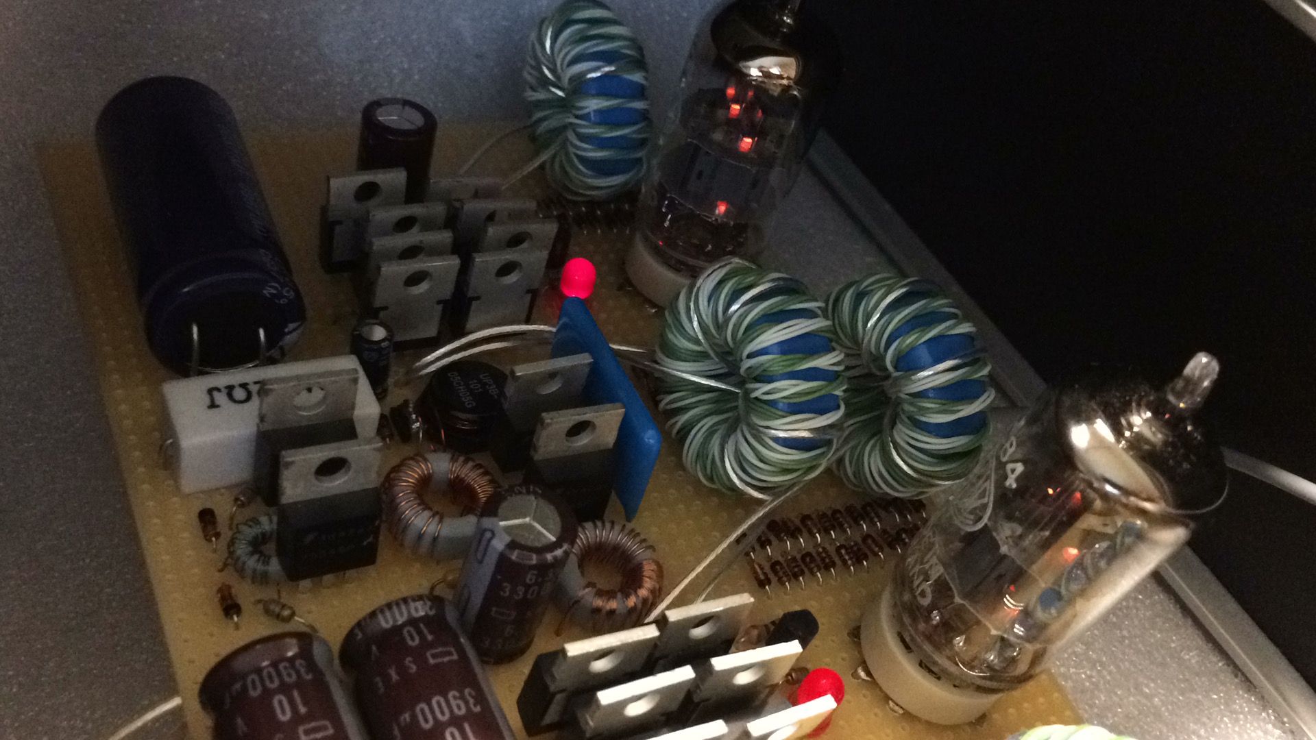

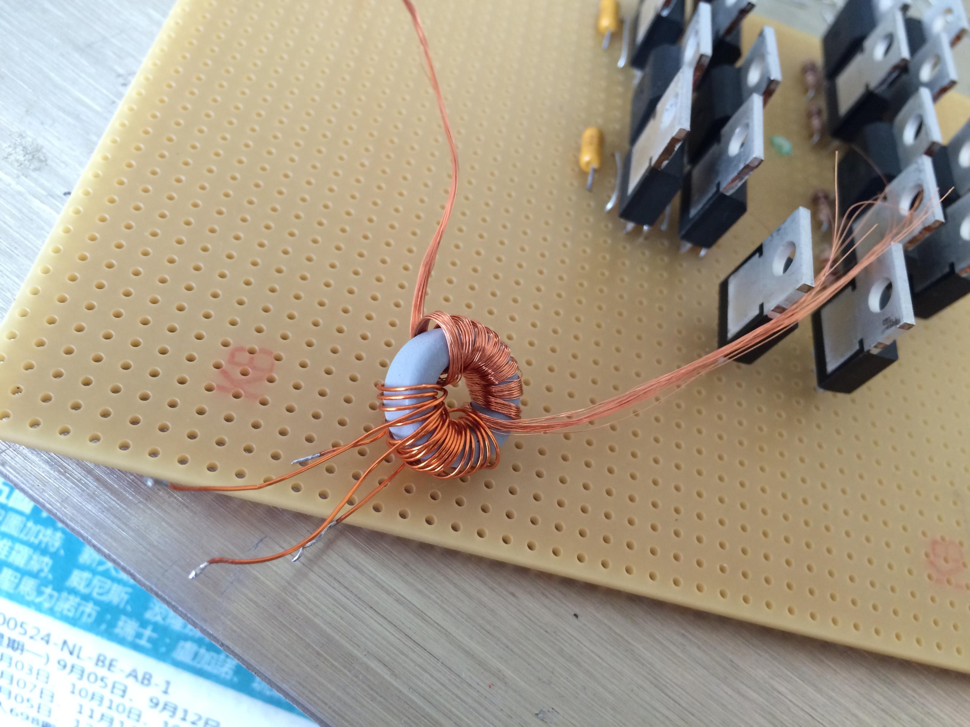

Additional images that can help building this amps. I used common mode choke cores for the transformers. 500Khz oscillator and resonator.
The amp itself is very simple. Some of my amps do not even have a phase inverter as my preamp has a symmetrical output. The "power" tubes are sensitive enough, therefore no driver stage is needed as well.

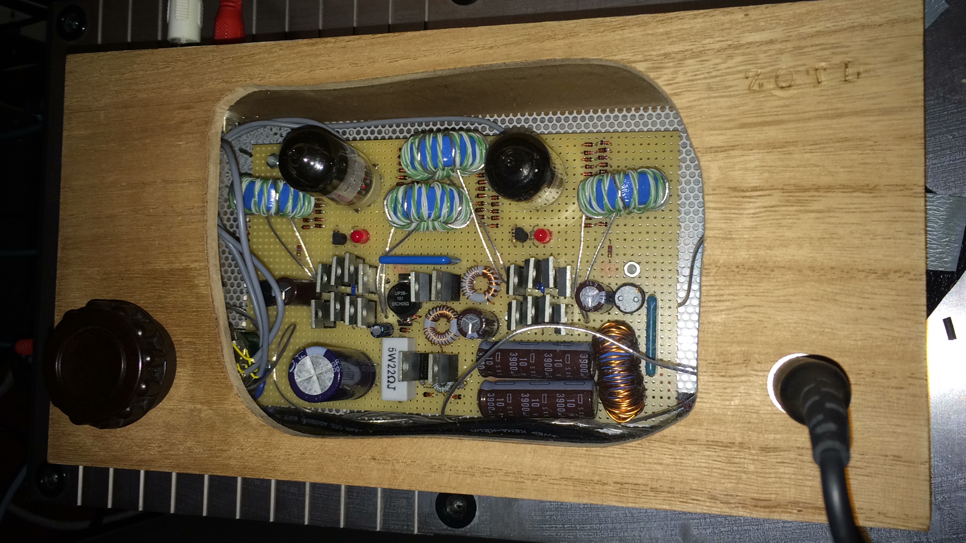

Yes, simple isn't it? That is the entire "power" 1W amp (it can drive my B&W Rock Solids easily).
My advise if someone would like to start this "adventure" : Use a low voltage (max 12V) power supply (short circuit proof).
In this headphone amp i have used a 5V PSU. It can be adjusted to about 7V max.
For this amp it is sufficient.
It is the best Zotl project to start with as it needs no High voltage PSU at all.

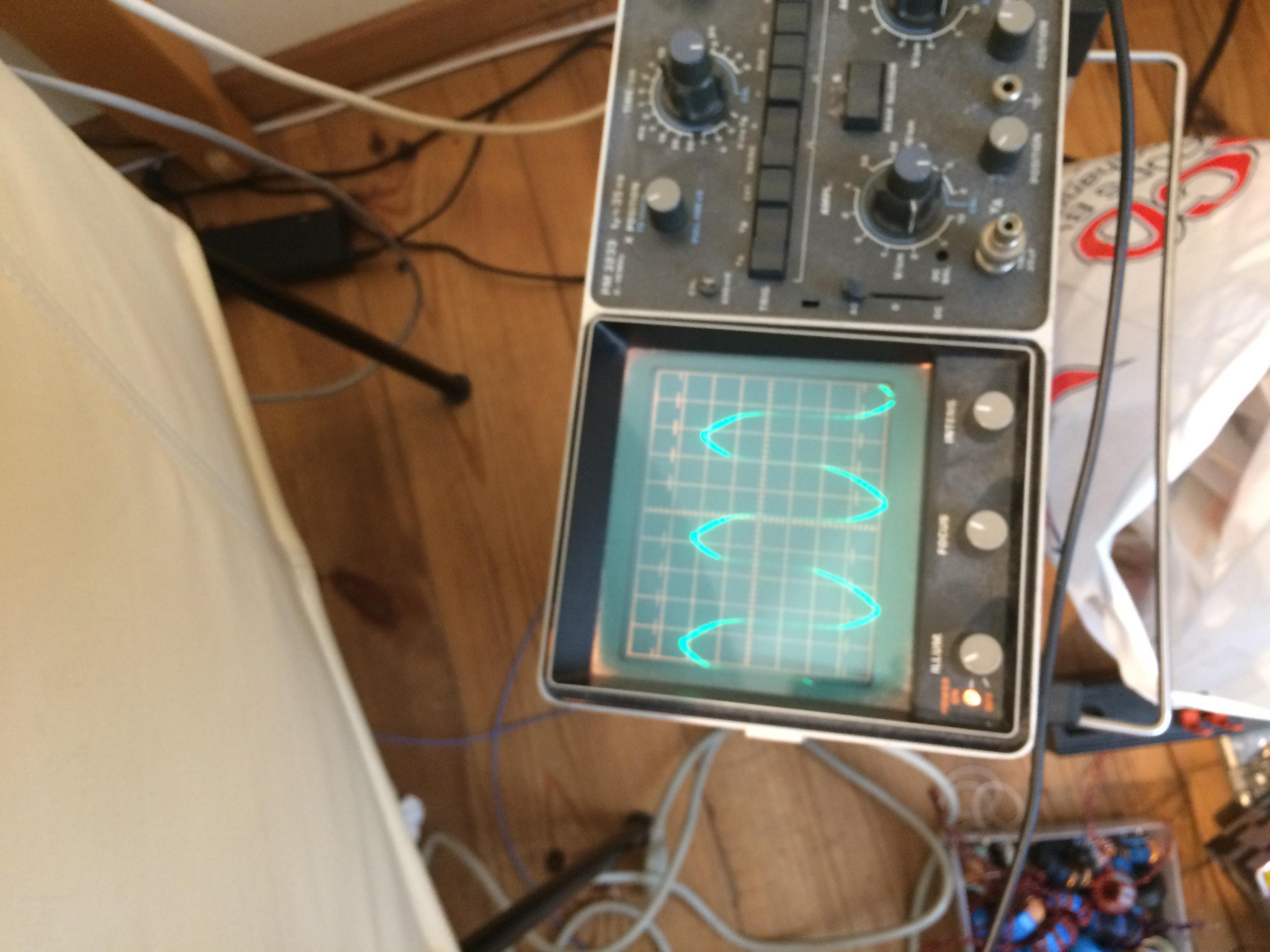

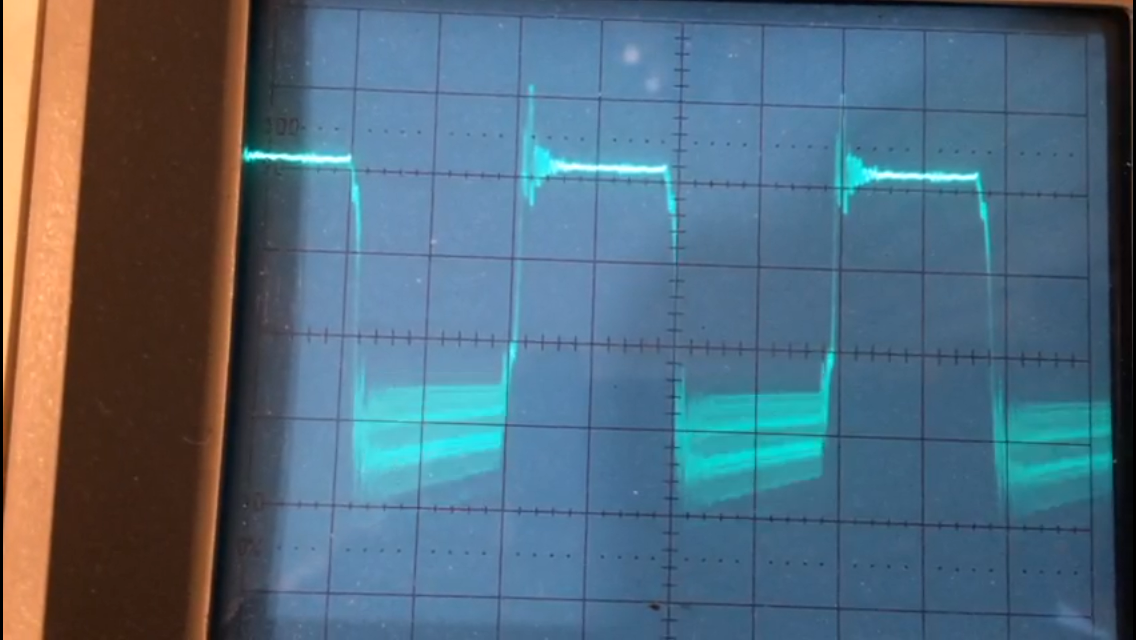

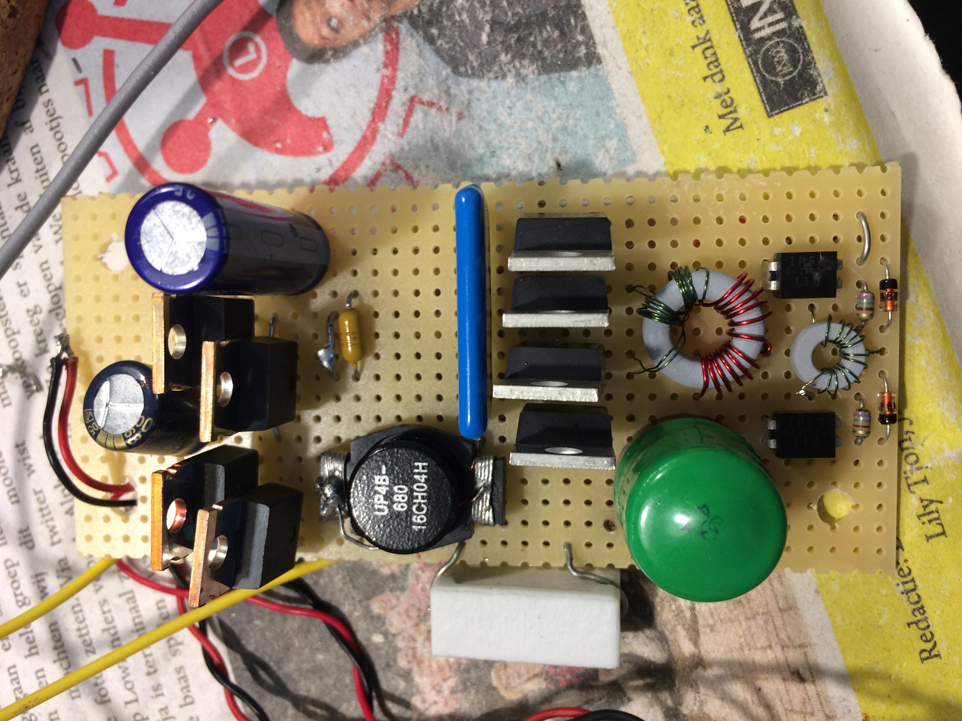

first build a (half) H-bridge and a oscillator. Make sure the square wave form looks good without any harmonics as this would heat up the FET's and could indicate saturation of the ferrite cores. It will burn your FET's in time and the frequency will "run away" causing even more heat dissipation.
