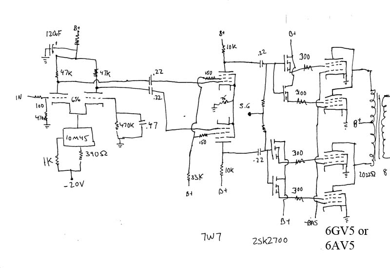

Ok. Spending some time on Upgrade Island has cooled me off to the whole interstage transformer thing. I do intend to go off the ranch though. New idea.
6J6 --> Triode strapped 7W7's --> 2SK2700 (x4?) --> *AV5 (x4)
No tubes that cost more than a buck.
With PPP on the output I shouldn't need as much swing to get up to the OPT's 100w rating.

You have a 2022 ohm CT primary. To get 100 watts RMS you will need 635 volts P-P at each plate. This is ohms law regardless of how many tubes and what kind they are. Ohm will aslo tell us that the peak current will be about 1.25 AMPS, a bit much for one 6AV5, so two per side is about right.

So I whooped up a schematic for entertainment sake. Half baked, but you get where I'm going with this. It's sort of a chimera of the Tubelab Universal and the PMillett 307a PP.
A photo of the current cast and crew is below too.
I'll be watching your project with interest. I have a small stash of 6JM6's here, which coincidentally appear to be virtually identical to your 6GV5's, except for some of the internal connections.
Jeff

Tubelab if you're reading, what kind of 20k 5w resistor did you use on the screens? Wirewound (inductive/non-inductive), MOX, film?
For the pots, I would guess that 1/2w is sane?
You mean the resistors that are missing from your schematic (SG to ground or negative supply). I have used whetever that I had laying around. My latest experiments have been using some 10K 6.5 watt WW resistors that I got for Tubelab SE amps. I have also used the white Xicons that I use in the Simple SE, but they are hard to find in 20K (although I have some in another brand) I have also used some 20K 3 watt MOX parts from Mouser. All work good.
For the pots, again I used whatever I could find, mostly leftovers from Tubelab SE amps. The issue with most pots are their maximum voltage rating. I usually use additional resistors on each end of the pot to lower the voltage across the pot. I have been running the mosfets on a lower supply voltage to keep their dissipation down. You need resistors from grid to ground on the 7W7's. I'm just guessing, maybe 470K. Put a 10 ohm in the cathode of each output tube so you can measure the cathode current.
So, you screen drive guys find optimum G1 at cathode potential?
That has been the accepted norm, but my findings dont exactly concur. I find that a slight negative bias can improve distortion especially at low currents. Increasing the negative bias improves the distortion but causes another problem. More negative bias means more positive screen voltage is required to get the same tube current. At high power output levels, on positive signal peaks, the screen grig voltage will be high (maybe 250 volts) while the plate voltage will be very low. This is the recipie for a melted screen grid (or worse). Actually this isn't much of a problem with normal music, but it led to a nuclear event inside a 6BQ6 as I was extracting 100+ continuous watts out of a pair. There is a happy medium here and it sems to vary with tube type, but I haven't had the time to experiment lately.
