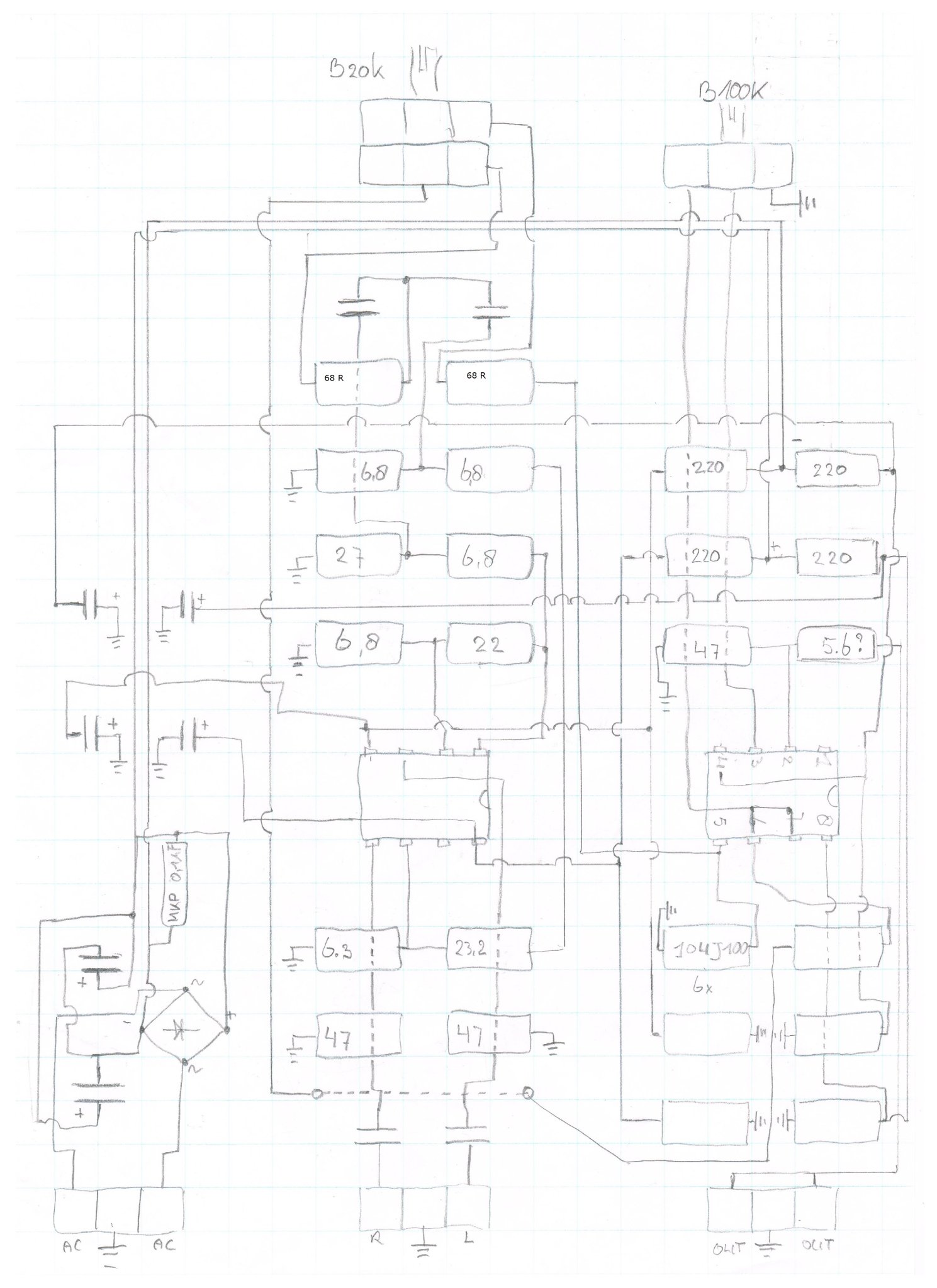

This is the schematic based on the PCB photos, please check if there any error. I hope someone with insight can make suggestions to improve this circuit design and eliminate scratch noise.
Hi Chris,
The only error I can find/measure is that pin 1 of the right hand IC and pin 7 of the left hand IC are not connected.
DC update: fluctuating between 1,9 and 2,9mV.
Regards, Jan.
Hi Jan,
No, the pin 1 of the right hand IC and pin 7 of the left hand IC are not connected on the PCB layout and schematic.

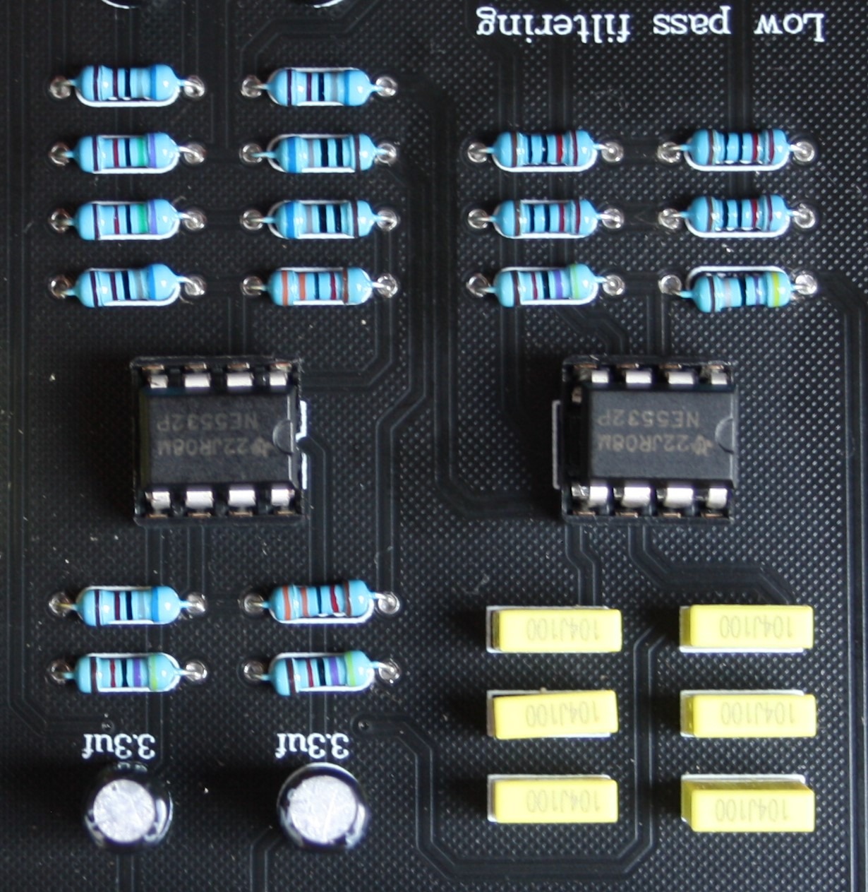

Bypassing the two 3.3µF capacitors suggested by @MarcelvdG does the trick!👍
You can remove the capacitor on the volume pot as it is not needed anymore.
Hi Marcel,
The board is now working with just the two 3,3uF NP capacitors bridged.

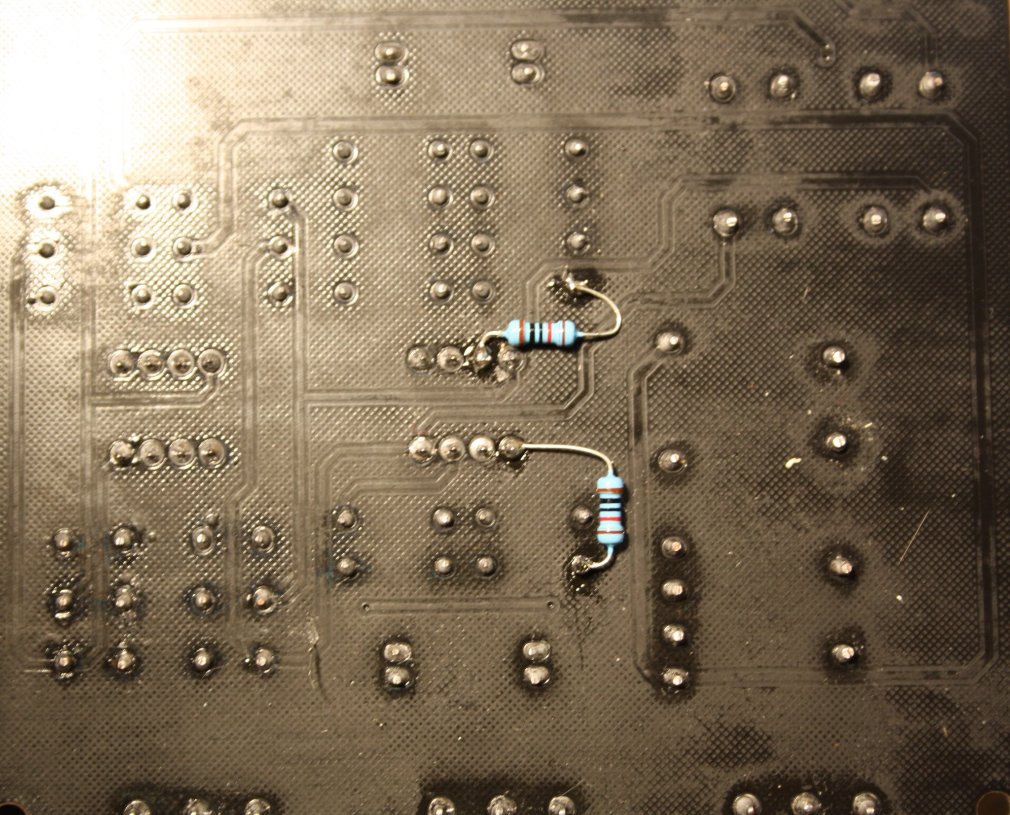

I left the NE5532P in place; I did swap it for a TL072 on a previous occasion, which had no effect on the scratcing pot, so the NE5532P was put back, see post #5: https://www.diyaudio.com/community/threads/scratchy-pot-on-tenghong-low-pass-filter.401145/
The board that is operational, is the one I added the two 10K resistors to (no effect); these have been removed, together with the two 3,3uF near the volume pot
The board I removed the volume pot from and added the capacitor to the wiper doesn't work (at all), after I put the pot back in it's place. I'll have to check if I damaged something to cause this, I had to use a large soldering iron to have sufficient heat to get the leadfree solder off, this may have been too much...
