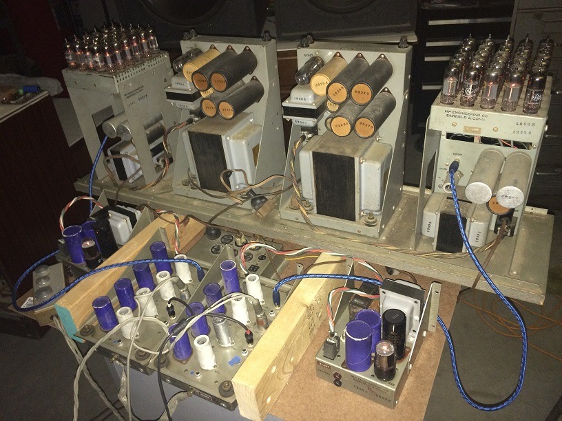

What I meant was that the amount of work wiring together 60+ tubes just doesn't justify the results. The tubes are so small that the load overwhelms the parallel output Z to the extent that little remains of any triode "magic". N Fdbk is essential to get any semblance of linearity from this and many other OTL Amplifiers. Now, maybe with 3 to 5 times as many tubes in parallel. But that would only be practical with bigger tubes to reduce the # of sockets. If one is pushed to use big pentodes instead, then a more appropriate design would be one that emulates ( via special N Fdbk ) some quality triode model. Efficiency would improve as well ( at higher spec output only however. )Is Everyone crazy?
Reminds me of this crazy project. https://www.diyaudio.com/community/threads/100-watt-sweep-tube-circlotron-otl-wip.358700/

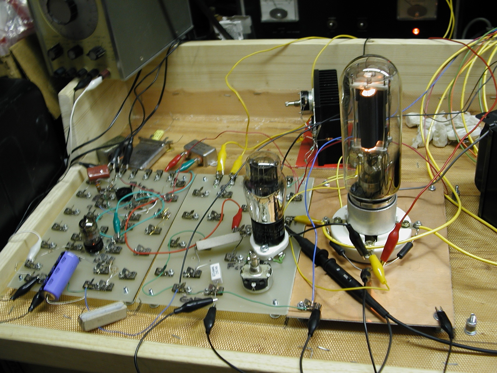

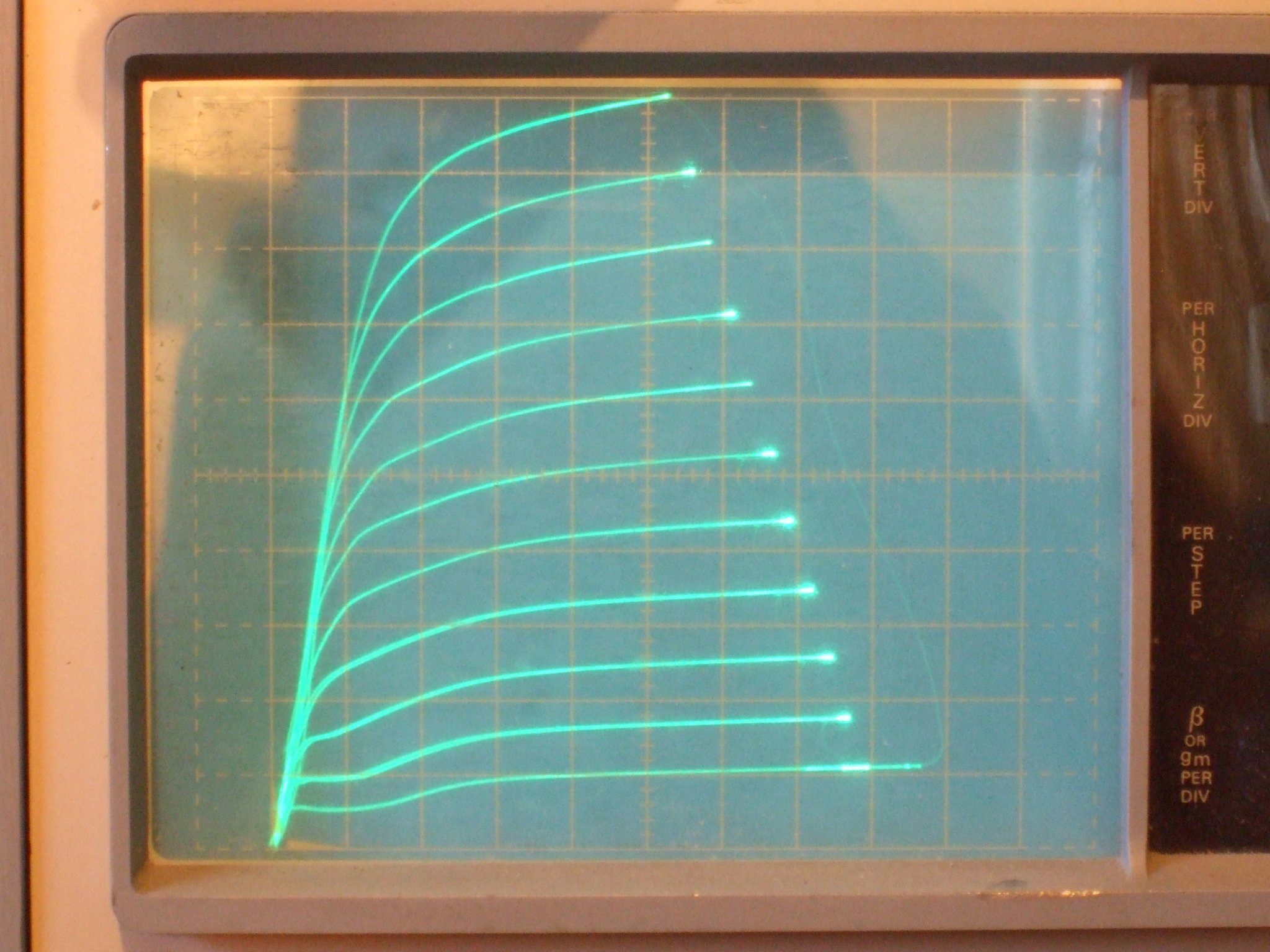

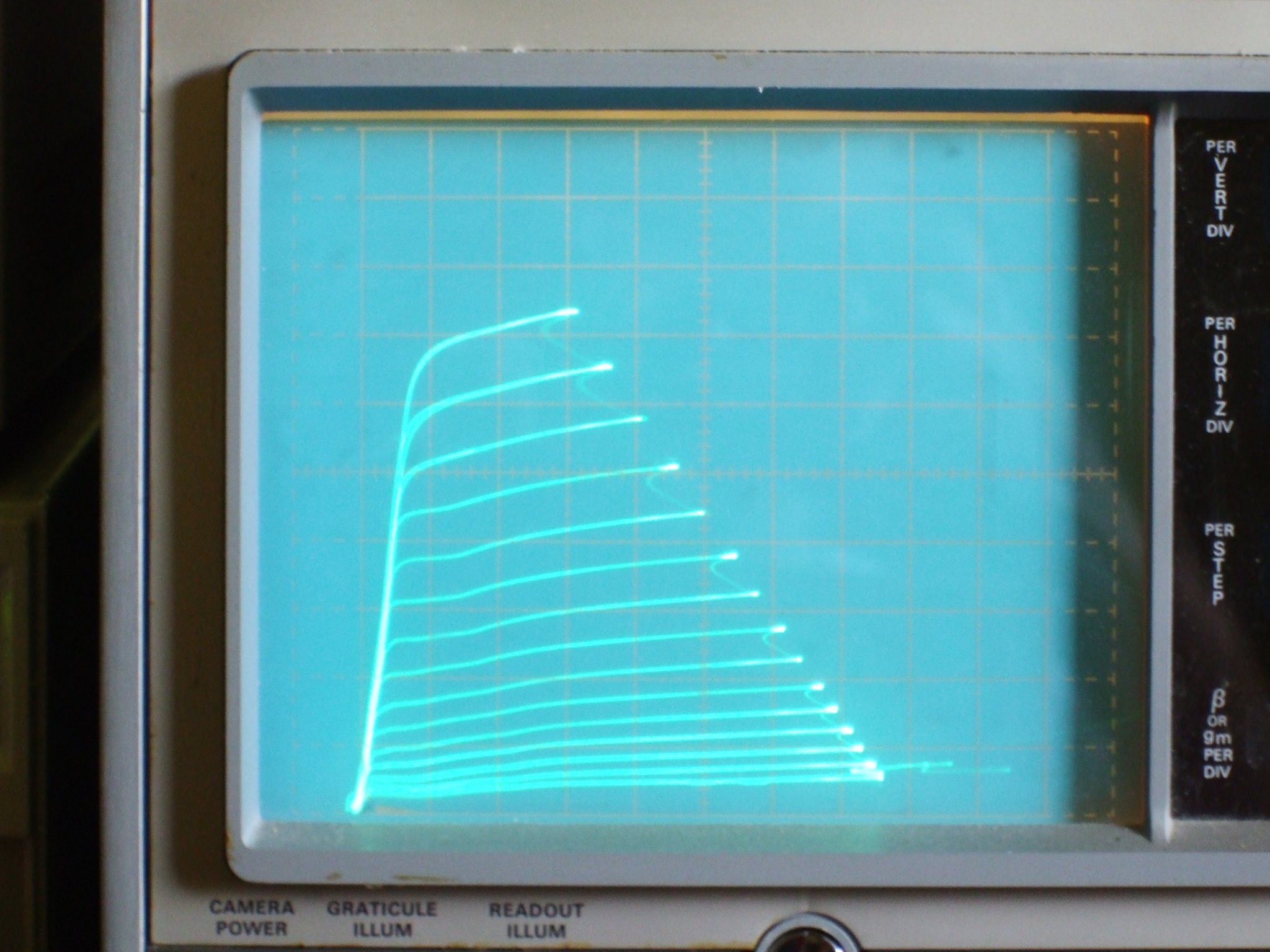

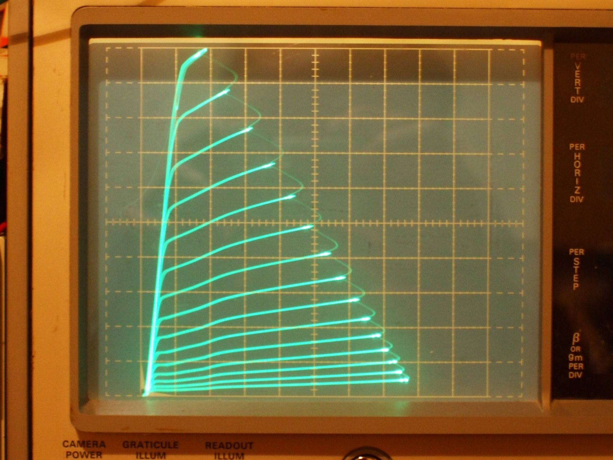

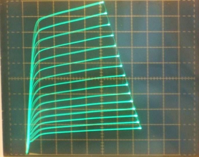

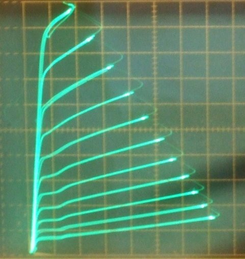

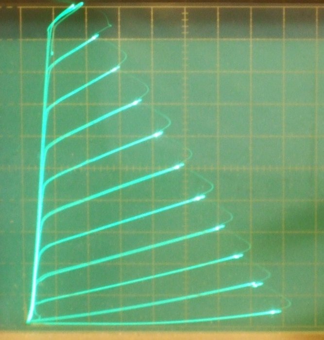

Normal Pentode curves (6HJ5 )
6HJ5 with UnSet:

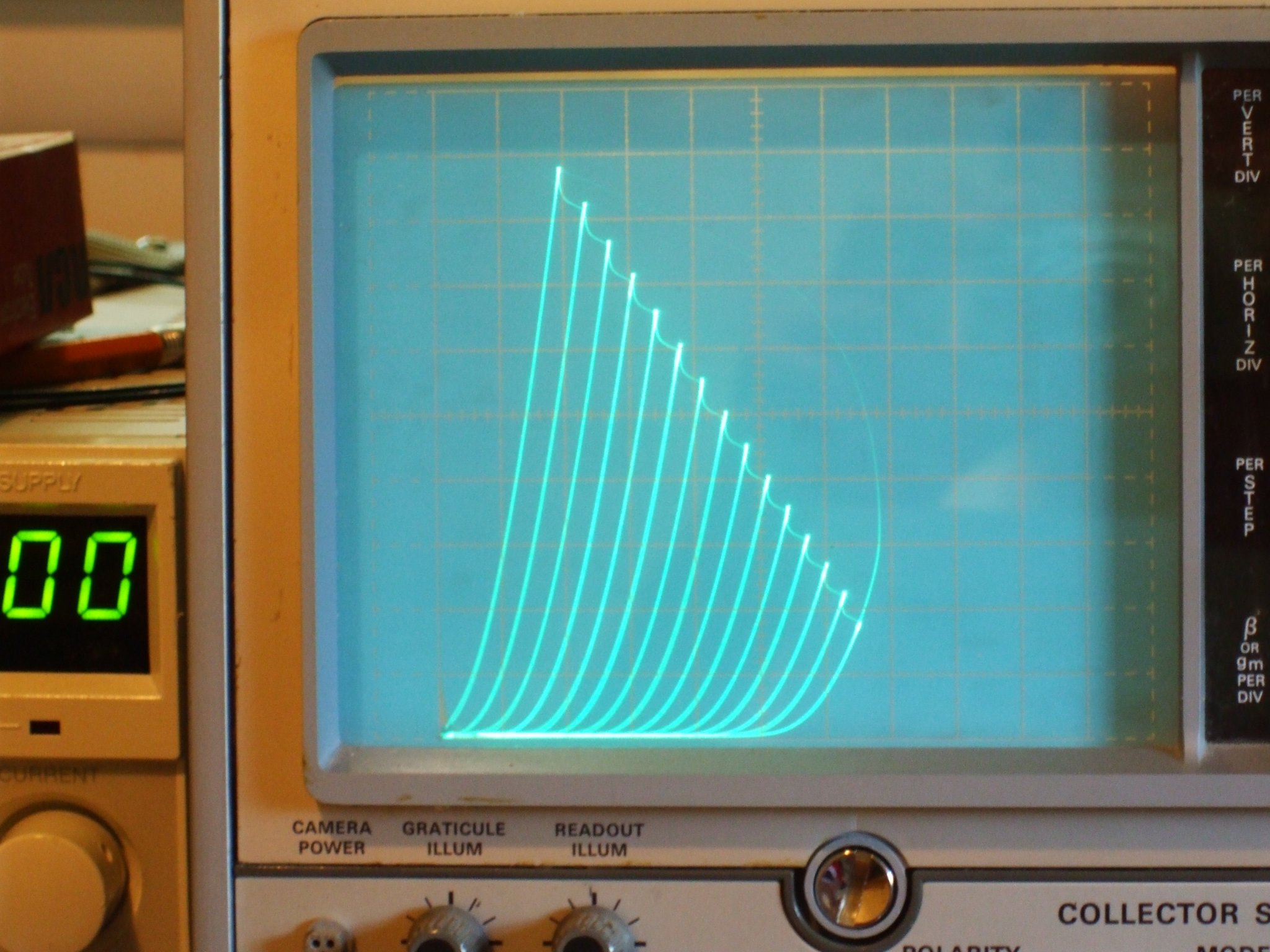

A $4 trioded tube for emulation:

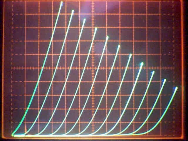

Crazy Drive of 26LX6 :
Normal 26LX6 pentode curves:
6197 normal pentode curves (for driver stage)
Normal pentode curves for JJ KT77:
6HJ5 with UnSet:

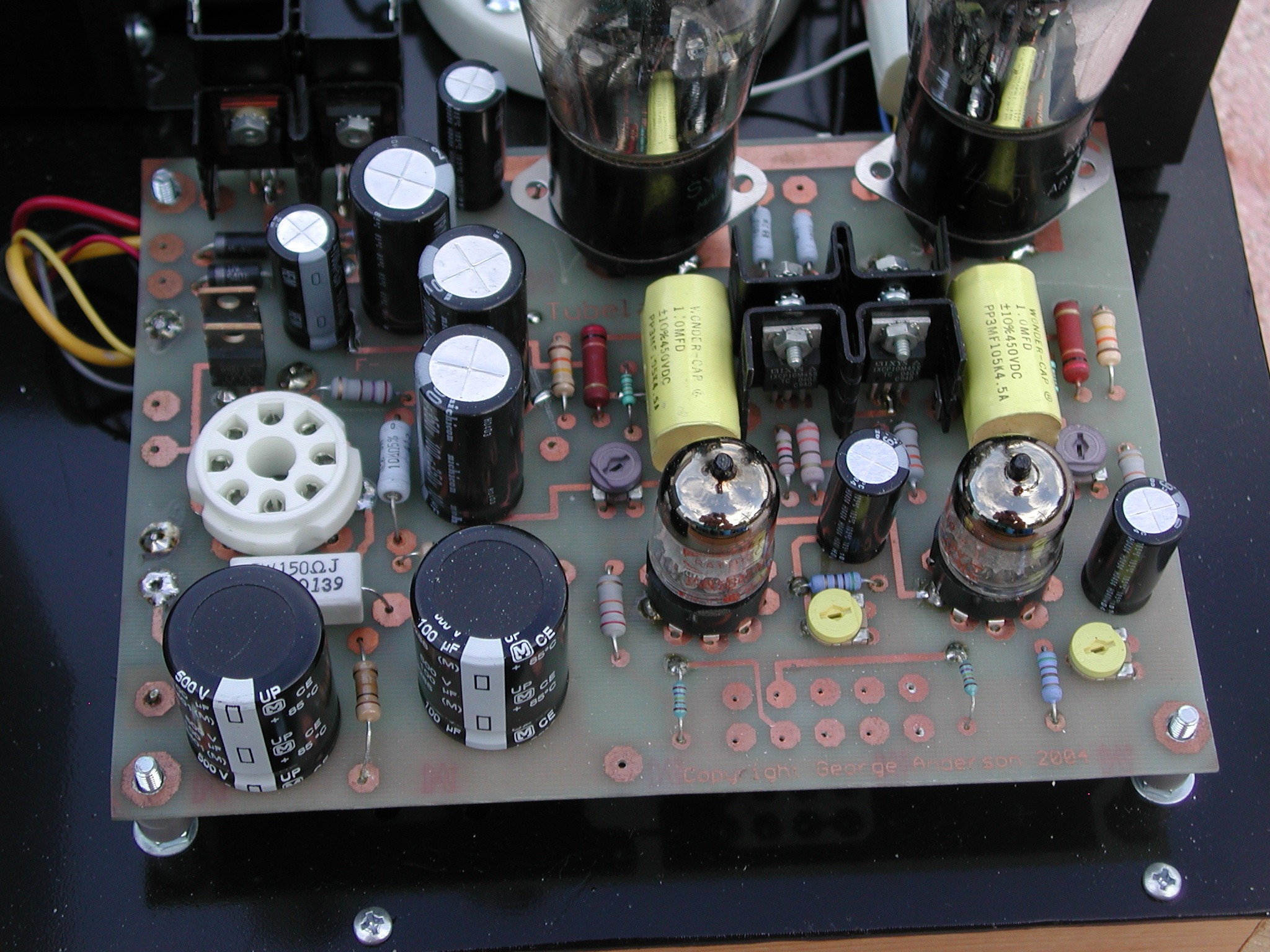

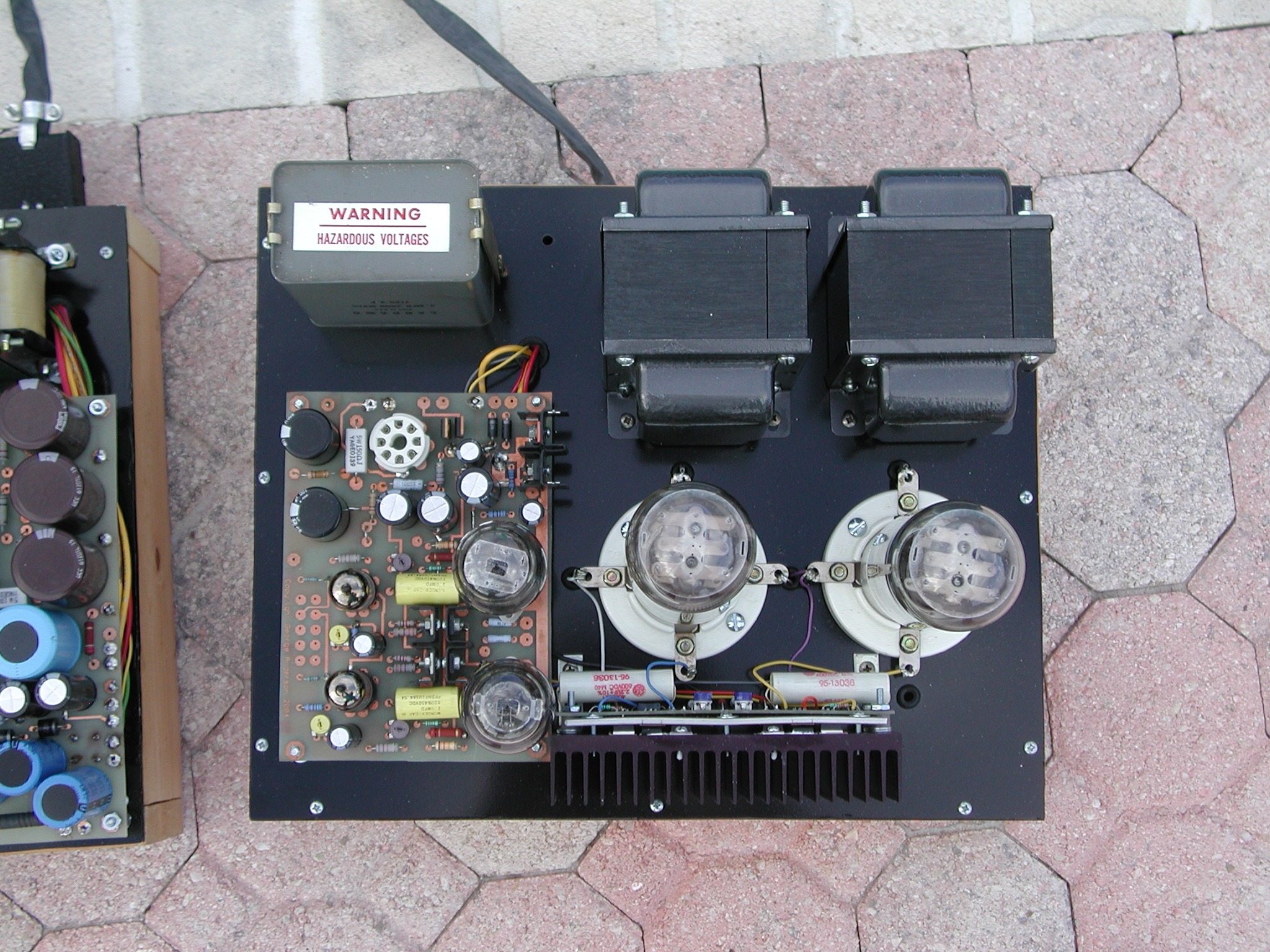

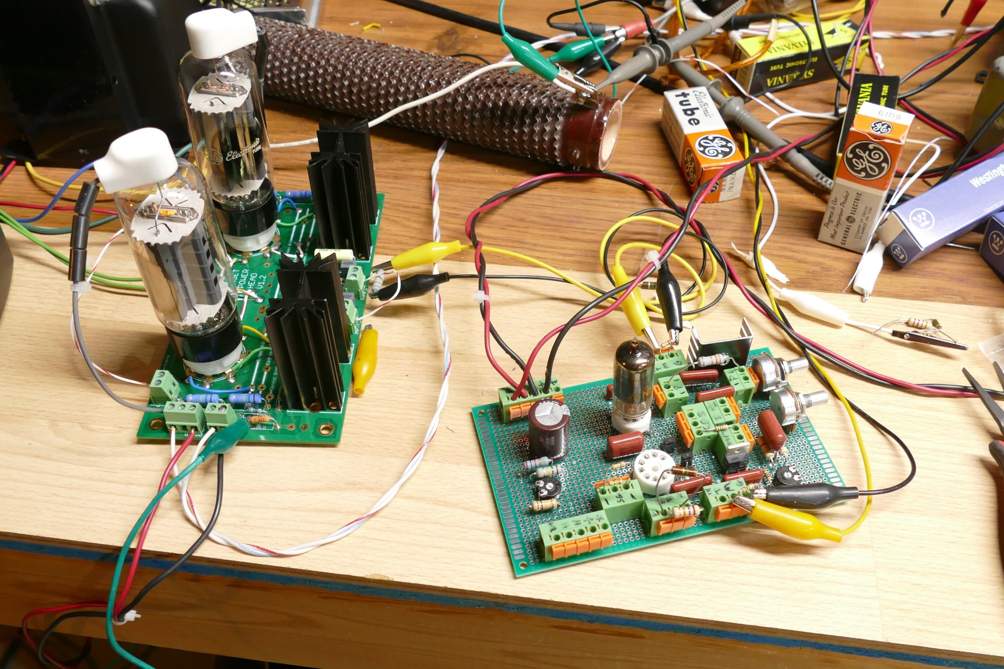

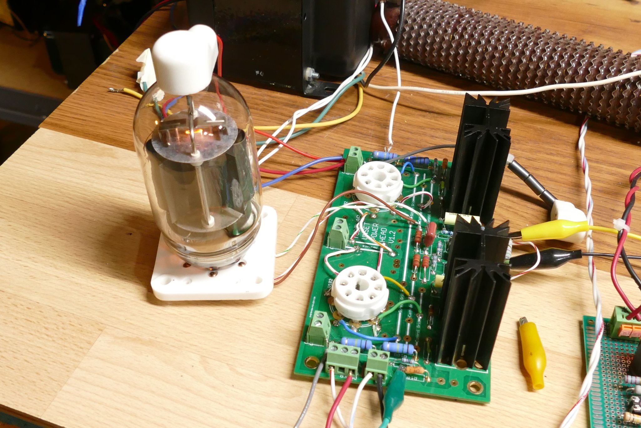

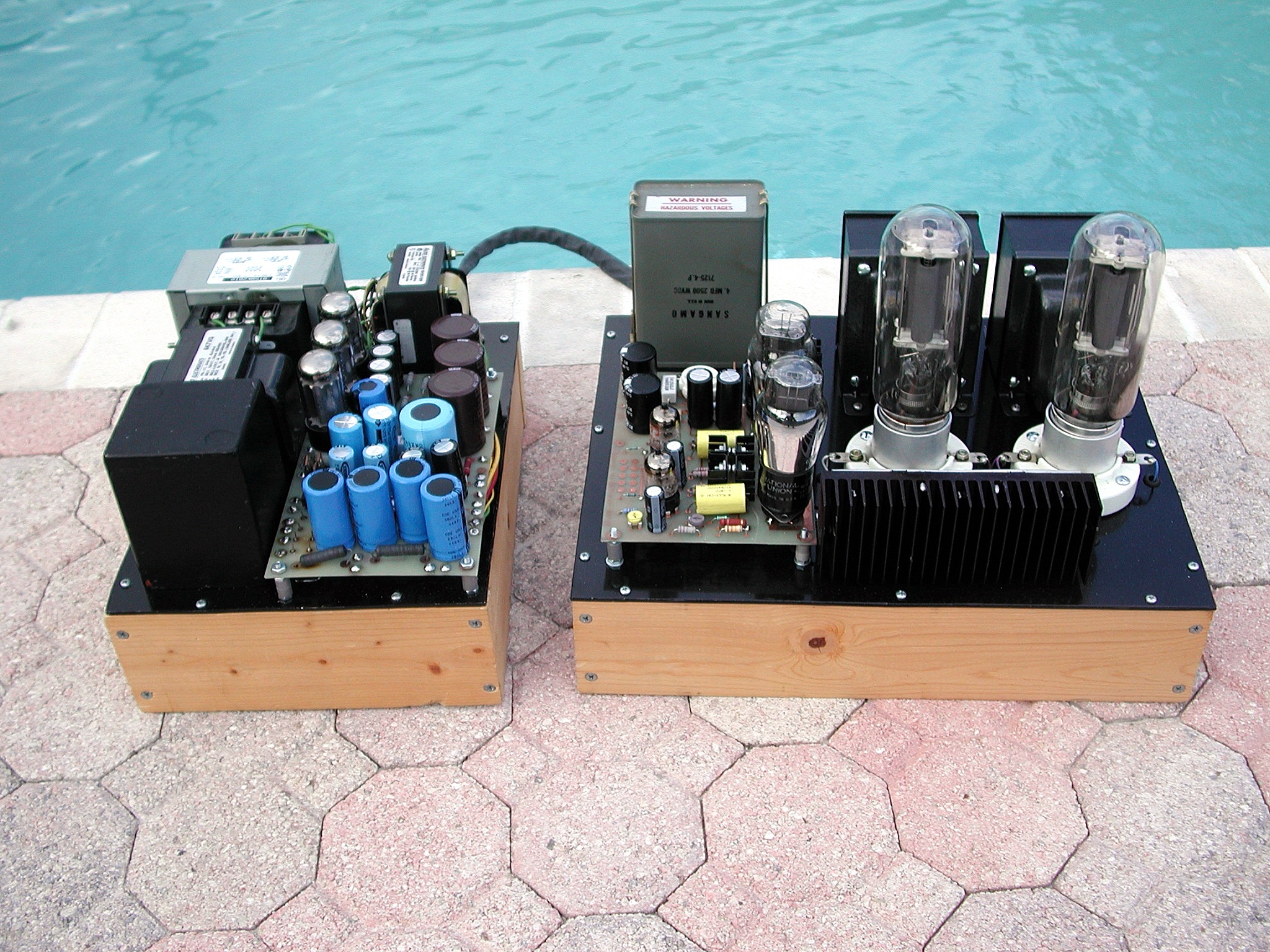

About 23 years ago I caught the SE fever. First it led me to build a small SE amp with 45 tubes (they could still be found for under $10 each). Then I stuffed 2A3's in it followed by 300B's and it eventually evolved into the original Tubelab TSE and now TSE-II. I found a schematic for "The poor man's Ongaku" a 211 SE amp on the web somewhere and build one on a prototyping system that I called the "Tubelab." It sucked, so I redesigned it by replacing the entire driver section with a PC board design I had been working on that would become the TSE. It ran on 1050 volts, made 30 WPC, but dumped about 500 watts of excess heat into my 100 square foot room, which limited my listening time to an hour or two as I lived in south Florida. Eventually it saw no use at all and wound up sold at the Dayton Hamfest just over a year ago. By this time, I had found far simpler means of making 30+ watts of SE goodness, and I now have a 2000 square foot basement 1200 miles North of Florida. I sold most of the 845 and 211 tubes too. So far nobody has shown an interest in the Death Amp 2000 parts that I have dragged to the hamfest several times. The monster that I was playing in my avatar picture is a single channel SE amp that used an 833A transmitting tube on 1500 volts. Power output was about 200 watts through a custom one off Transcendar OPT. Pictures from 2003. I don't need or want a huge SE guitar amp, but if I ever run out of projects.........
The picture shows the two-chassis amp and power supply combo. The amp chassis used one of the two DIY PC boards that became the TSE. Note the 2004 copyright date and the first use of the Tubelab name. This amp started out on the Tubelab Breadboard and prototyping system. Yes, I was stupid enough to run 900 volts through Radio Shack clip leads.

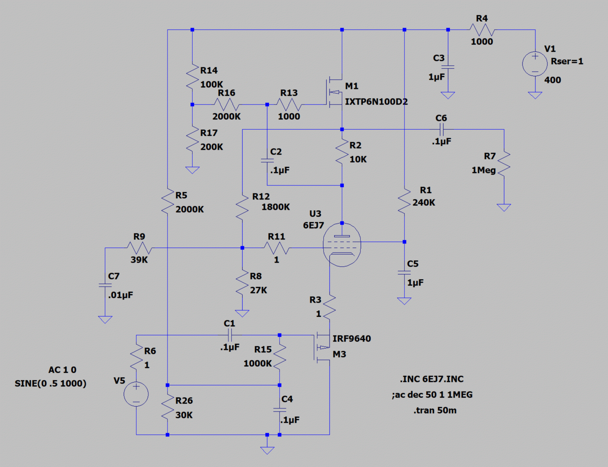

The modern design, vintage....last month, uses a $1 tube augmented with a pair of mosfets to make 50 to 100 volts RMS of drive (yes, it will drive a truck!). Seen here in prototype stage driving a pair of 26HU5 TV sweep tubes wired in parallel UNSET to 35 watts at 1.23% THD on just over 500 volts. Still tweaking on it, but If I had to build a big SE amp now, this would be it! The driver board can use one of about 15 different cheap tubes. Drives a fat transmitter tube to 30 watts too, but it (the 4D32 tube) wasn't too happy about it.

I measured some info for the Hammond 1640SE 1250 Ohm OT here:
at 54V 60 Hz excitation, Lpri = 27.646 Henry
Rpri DC = 84 Ohms
so 84/1250 = 6.7 % loss (not including the secondary loss )
8 Ohm sec has 0.7 Ohm and 1.0 Ohm (DC) windings in parallrl, for 0.411 Ohm sec for 8 Ohm, so another 5.1% loss in sec.

I've measured the frequency response of the Hammond 1640SE and it looks flat from 30 Hz to 30 KHz per spec, with either 4 or 8 Ohm load on the paralleled 4 Ohm sec. windings. No valleys until 33 KHz. 8 Ohm loading gives a somewhat higher output V level as you would expect.
Looking at tubes for it: 26HU5, 26LX6, 26LW6 they all are around 286 Ohms Zout at 125 mA. ( I likely would use UnSET configured for a mu near the inherent mu of about 4 ) The OT is rated for 200 mA DC. Typical DC Imax for the OT would use up half the magnetic flux. So Lpri would drop to half of 27.646 Hy, or 14 Hy. giving XL = 2 pi 30Hz 14Hy = 2639 Ohm for XL, about 9.2 times the tube Zout. Probably OK, but the air gap spacer could be thinned a little for 125 mA DC. 8 Ohms on the 4 Ohm nominal secondary would similarly give 2500 Ohms loading at the primary.
The 6528 V reg. tube ( 30W + 30W, triode, mu 9, gm 37000 per sect. ) gives 245 Ohms Zout (per section ) so looks good too. I probably would use a tube emulation driver for it to get super triode curves, but the mu 9 might leave some room to try UnSet also.
Seeing how the 200 mA Imax DC rating (when DC is present ) would bring the primary inductance down to the 14 Hy rating of the newer Hammond 1640SEA, what Inductance configuration does Hammond quote for these SE OTs? I'll bet that most home L measurements don't take DC current effects into account.
I also just measured the 1640SE OT with an 8 Ohm load on the full-up 8 Ohm configured secondary, and the response -begins- to visibly fall off at 20 KHz now. But, no valleys below 20 KHz still.
So this 1640SE OT will work better as a 2500 Ohm Zpri OT.
