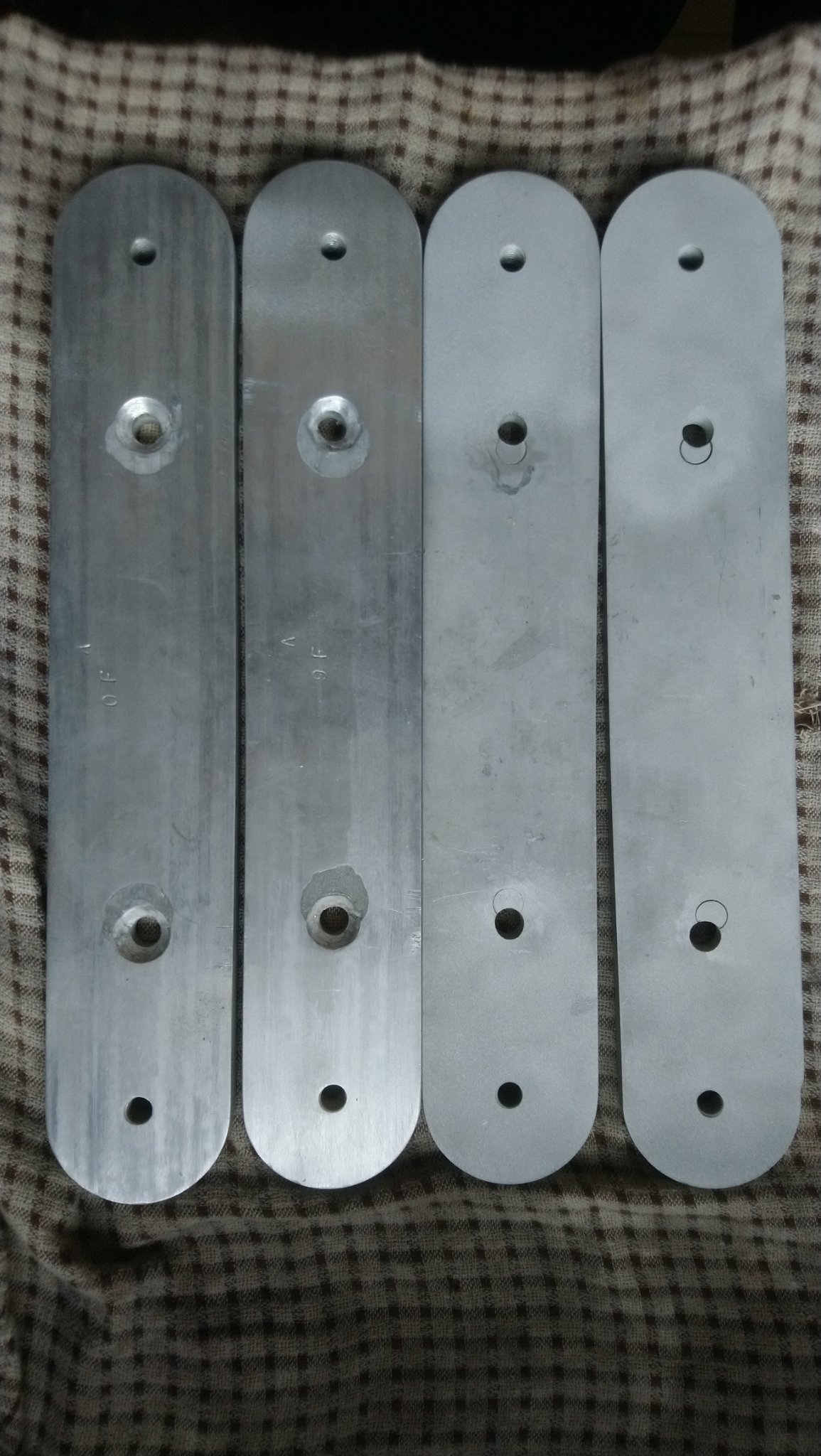

FYI These are base plates for PMC speakers someone else made for a different model to mine so the original holes filled in by tapered aluminum rods then redrilled to move the holes further apart.
