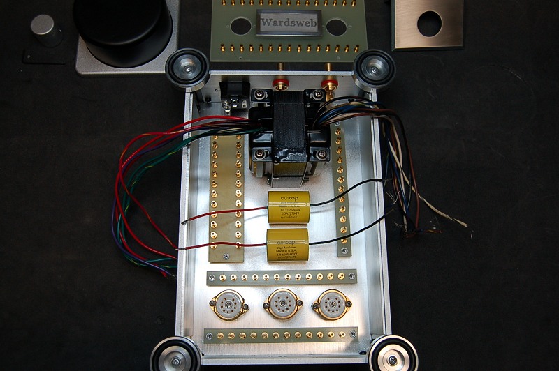

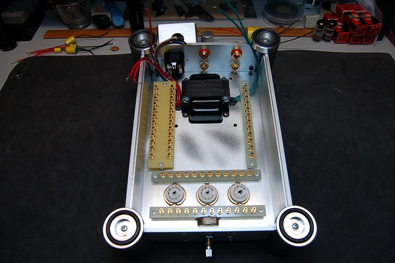

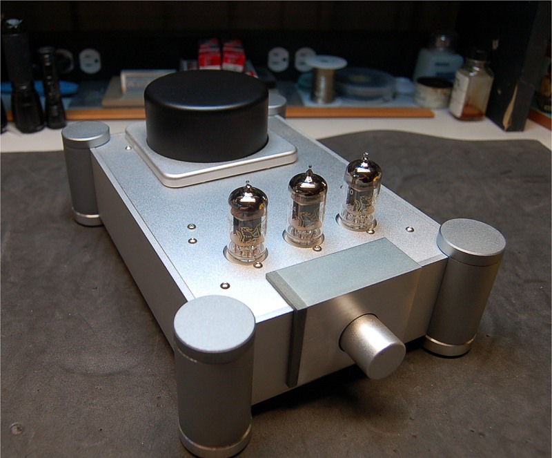

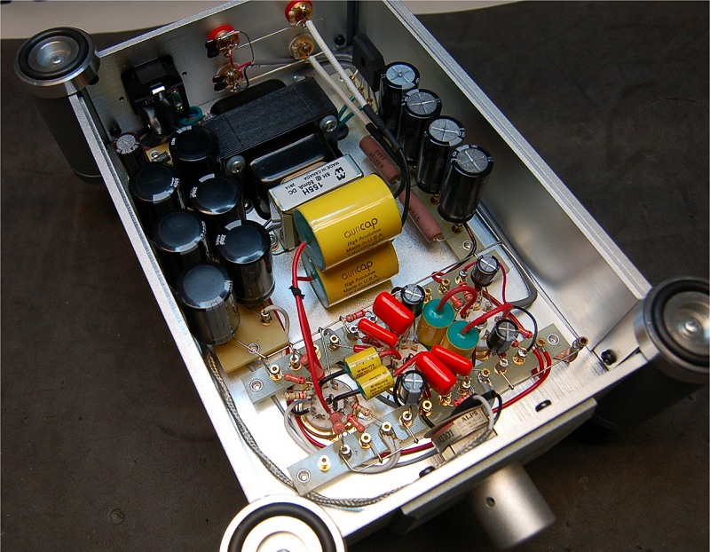

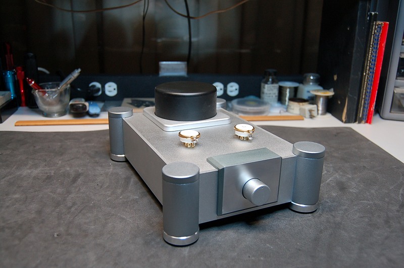

Here is my latest project. A three gain stage (12AT7 - 12AX7 - 12AT7) with passive RIAA phono pre.
OK, obvious question: so where did you get the chassis and the turret strips?
The chassis is from China off Ebay. I asked for one without holes already drilled, so I could do my own custom layout. I used a rotary Alps on/off switch in place of the originally designed preamp volume pot.
The turret strips are from AES: https://www.tubesandmore.com
