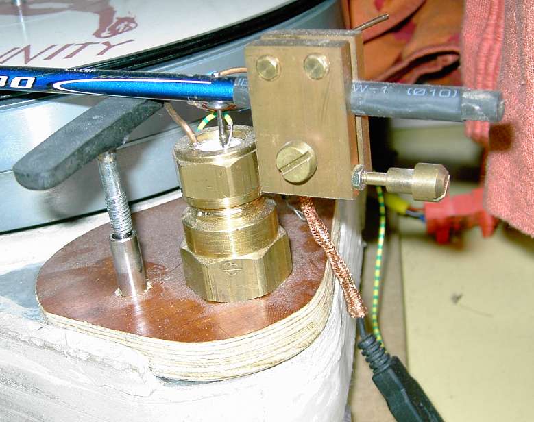

I understand that the Thorens type bearing cannot take much more than 1 or 2 kg without excess friction and wear.
Ok, but with a well balanced platter, this wear should be on the bottom plate of the bearing only? (I've once seen widia bottom plates for this bearing for sale). Then I could drop in a little teflon plate which I can exchange when it is worn. Right or wrong?
After casting the plinth, did you have to clean it up- remove material from it, or is it just 'as cast'? What concrete did you use, and why will you not use it again?
I did go for a distinct lo-fi look. So I took it out of the mould, and that was it. If you want a smooth finish you either have to make a very smooth mould and/ or will be looking at a lot of work with the grinder.
I used fibre reinforced concrete meant for the top layer of floors, so it sets to a plane and smooth surface and it densifies itself.
This particular type I wont use for my kitchen sink (I will use it for other things though). This type is especially for great strength. It allows constructions up to 5 cm in one go (the normal type for floors allow 1 - 2 cm at most). So from a construction type of viewpoint its is very good. But: it does NOT give a smooth surface on top (where it is not confined, but open to air). I think a smooth surface is important for a kitchen sink (as I have 6 meters length of sink, I don't want to do too much grinding).

I'm building the phonoclone. I've left some space in the plinth for it, so I can have very short leads from arm to phonopre. I believe that will do something for the quality.
I also planned to do some more concrete casting: a sort of shelf or bottom plate for the turntable to put in on. In this plate I'll leave 3 cavities, where the feet of the turn table will land. These cavities I want to fill with rubber, air bubbles, or something to decouple the turn table from the surface. Still thinking on that one.

Certainly putting a teflon disc in the bottom of the bearing will reduce the wear associated with the heavier platter, but it probably won't reduce the extra noise and friction.
Due to the laws of physics, every bearing will have extra friction with additional platter weight. The Thorens bearing as well. And yes, extra friction gives extra noise.
But... bearings designed for larger platter weights do suffer from the same laws of physics. Is there anything special with bearings designed for heavier platters except for the extra hard materials and probably the closer tolerances?
Marco
The larger size ball that the spindle rests on is another thing, but apart from that I can't think of anything. However, a PTFE disc is quite soft, while most bearings for heavier platter will use hardened or stainless steel, or something even harder.
Just a thought, you will probably find that the extra mass gives more benefits than it causes problems.
For the record: the Thorens spindle doesn't have a ball. It pointed in a rounded sort of way (so the profile is comparable with a ball on the end).
Harder material gives of course less friction but: How hard can we go. I suppose we don't want to get harder than the spindle material or even close to it, to prevent the spindle from excessive wear (a bottom plate can be exchanged after all).
Does anyone know how hard we can go for a bottom plate in relation to the hardness of the spindle of a Thorens?

Based on pure logic, the trust plate, if yo use one, should be softer than the end ball, loose or fixed. Otherwise the wear will be on the ball, which you don't want.
If you look at the DIY-Teres thread, the Teres bearing uses a loose trustplate, - several versions have been tried, -PTFE, Delrin, brass, bronze, all claiming to have somewhat different sonic signatures, which I cannot comment, as I haven't finished my own yet.
Oil bronze or PTFE makes sense to me.. and the average Teres platter is usually a LOT heavier than a Thorens platter.

If you look at the pictures, I use TWO stacked thorens platters. The top one I plan to fill with either Acryl, concrete or even some other substance to increase inertia.
I would love to use concrete as it is cheap, heavy and relatively easy to work with. But then, the whole concoction becomes heavy (which is good) but the bearing issue is not trivial any more.
I'll be looking in the Teres thread, and studying the magnetic supported bearing. It might be a good solution to take much of the (Extra) load off my magnetic levitation.
You need to calculate the maximal stress in a Hertzian point contact of dissimilar materials.
The relevant calculation is available online through the brilliant work of Anton van Beek at TribologyABC.com.
If you need a guide to how to use the calculator, just post the radius of the spindle end and the material from which it's made and I'll run you though it.
Wow, thank you, I'm impressed. It would be great to find the right material for the bottom plate.
The spindle has a diameter of 10 mm, and the end is pointed in a rounded sort off way (so the end resembles one half of a ball).
I've no clue as of which material the spindle is made. Sure it is some sort of steel, but what alloy?
On better inspection: there seems to be a little ball in the end of the spindle. I never saw it due to the oil on it.
The spindle and sub platter is from an old Thorens with a composite rather than metal sub platter (I think it was a TD150).
MArco

Today I did a quick test with a magnetic bearing.
In a loudspeaker shop I'v bought two compensation magnets (the ones you can put on a driver so it can be put close to a TV set) with a diameter of 9 cm. The shop owner told me that would be more than strong enough to lift a heavy platter.
Nope, it is string enough to lift a single Thorens platter, but not the stacked one I use. Let alone it would lift a stacked platter filled with concrete or something similar.
Besides that the overall thickness of the two magnets is to large. I have to replace at least one of them with a ring of neodym super magnets.
To be continued ...
That's all the information you need, alloying steel does not change its modulus appreciably. Since the force required to be supported by the bearing is an unknown we can use the calculator to determine the maximal force which can be supported by bearings with different materials.
The remaining data required are the modulus and the shear strength of the possible counter materials. I'd suggest we look at Teflon, Delrin, bronze and steel for starters. If you intend replacing the ball with a ceramic one we then need to do the calculations again with the different material pairs. I don't have time to do this right now, Ill return to it this afternoon.
