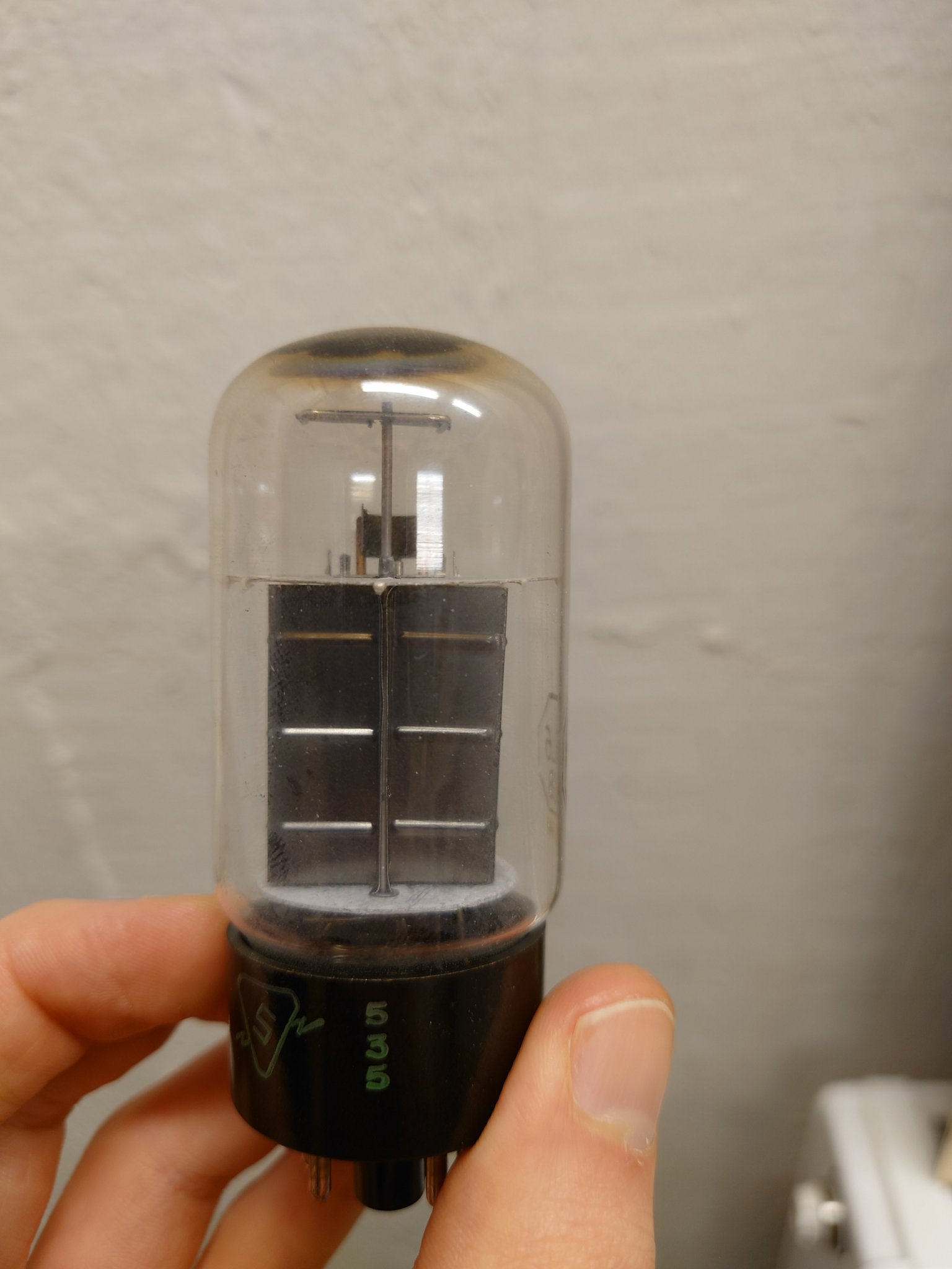

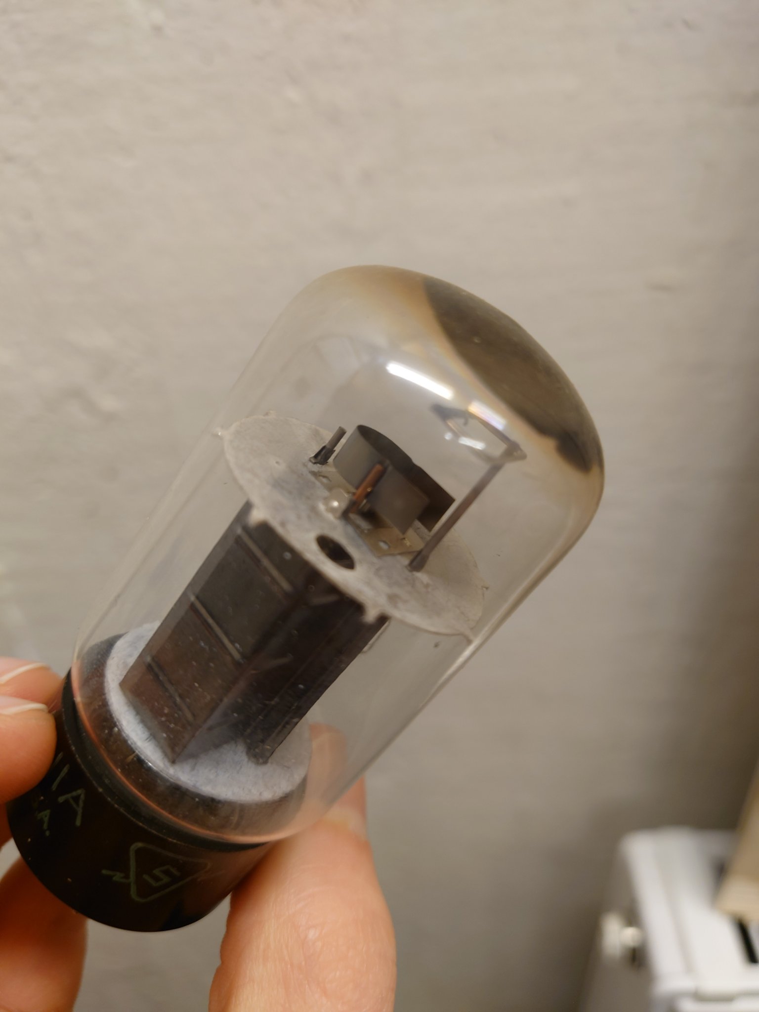

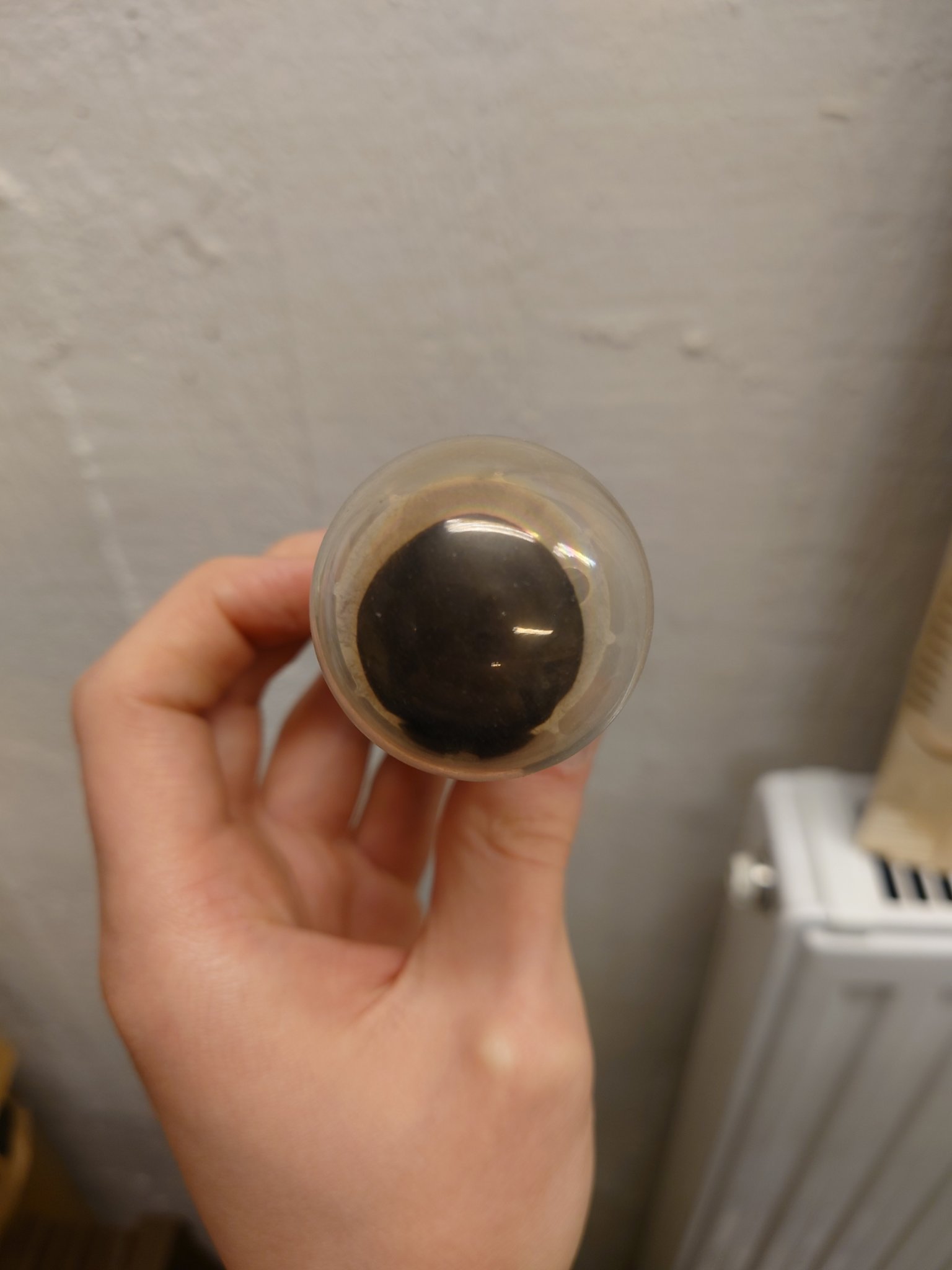

It has some 6L6 GB tubes(couldn't find any picture of the GB variant online so I've attached some 🙂 I think it's quite nice looking!) and a OD3 after the filter but I don't think I'd want to keep that part, seems like a waste of 6L6s to me. I'd rather use those for output tubes 🙂

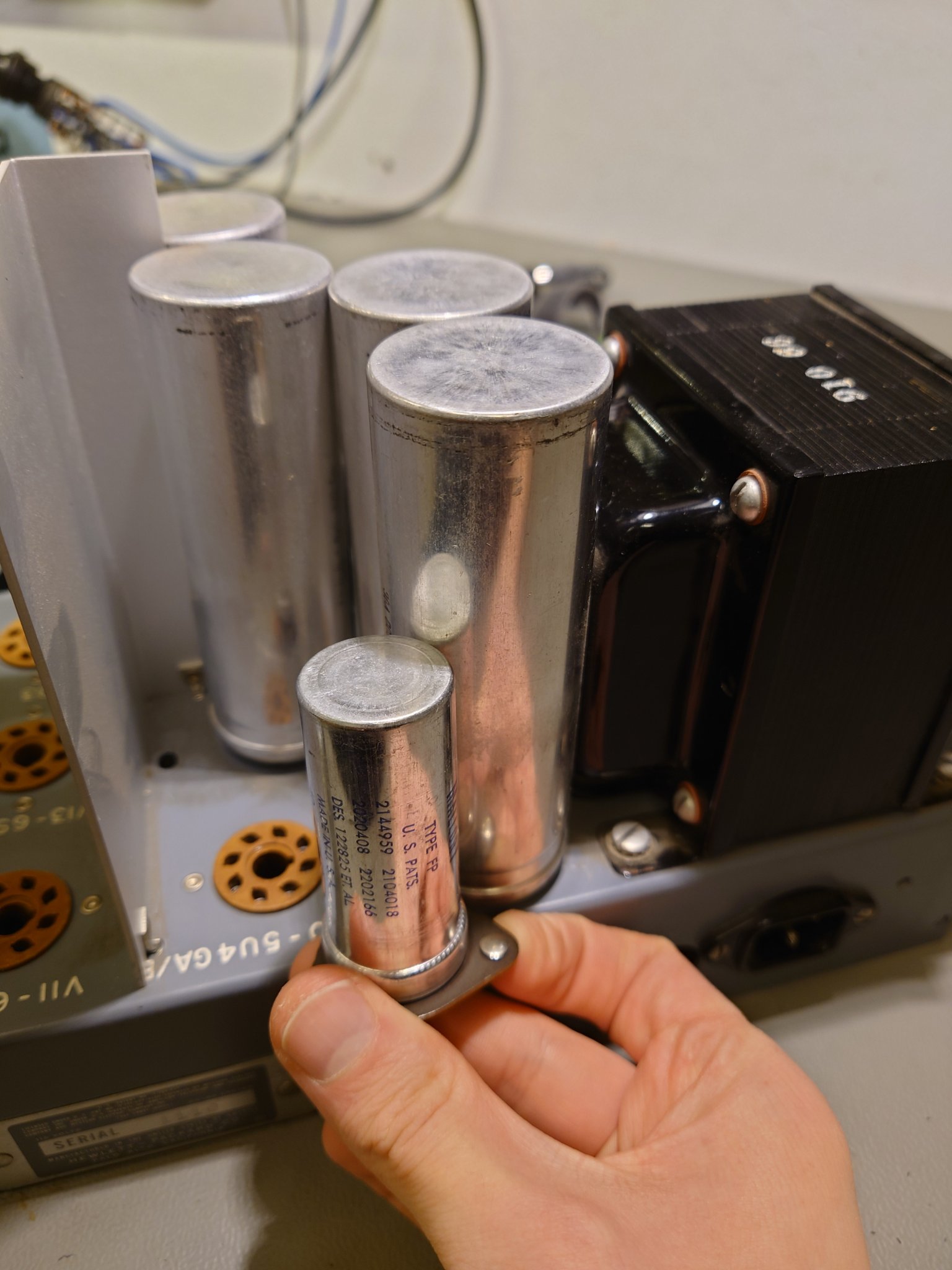

Attached a sketch of the part of the PSU I'd be interested in keeping. I don't know what voltage the output would be though but if i finish salvaging/scrapping the rest I could potentially turn it on and find out. A bit worried about the caps, not sure if they are electrolytic or some other type. They are very large for being 4uF electrolytics even for 600V rated caps, but my references are more modern capacitors.

And that is definitely a lot of voltage, I was expecting more like 250V because of the 150V reference in the PSU, that's also way above the max rating of the PSU capacitors. They are all rated 600VDC whilst some other caps in the circuit are rated 450V(not specified AC or DC)
Perhaps they are oil filled capacitors, not 'lytic.
I thought so at first but I have never seen a round oil cap, they are always very nice looking boxes in my experience. The 450V rated 40uF capacitor that's also in the circuit is not even half the size though...
edit
Manual says they are paper caps! So they are not electrolytics but polar paper caps! Mystery solved 😄

Take into account that a choke is usually specifically designed for a specific job. Core size, turn number, gap, AC voltage, wire size, DC current, fiirst element or second in the filter, etc.
Not any choke will perform ok in any circuit.
Definitely something I'll keep in mind, I plan on using them in a very similar application though. They are most likely going to be run with the same diode, but at a lower voltage and probably around the same amount of current.
Going to play around in simulation and see if I can get acceptable results using just one of them though, that way I can have two good tube rectified PSUs 🙂 maybe make the caps a bit bigger, I'll have to look at what the diodes I want to use can take.
