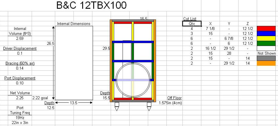

ScottG, check out this B&C 12TBX100 design
I copied your tips from the Perceive 2.0 thread but modifying them as did Ant. I would like to use the sand but we're talking at least 500lbs worth. So here's my basic cabinet design so far.

Its OK to alter the construction.. BUT it won't be nearly the same.
You would be better served by reducing the spacing for sand to 1 inch spacing on all sides but the top, and 2 inches on the top. It would still be extremely heavy of course.. but that helps out quite a bit.

You have about the optimum volume to spl for 20 Hz at 2.25 internal cubic feet - so if you have calculated volume correctly then it should be good.
In any event - do what you want, I'm only here to make suggestions. The bottom-line is this is your subwoofer (or at least the one you are putting the sweat equity into), so only do what you feel you are capable of. 😉
I feel a little slow but how does your suggestion about the sand apply to the driver baffle? It would obviously leak into the inner enclosure unless there was some sort of barrier. You mentioned concrete which is something I was trying to get away from doing but how is that implemented as well? I really need a visual here.

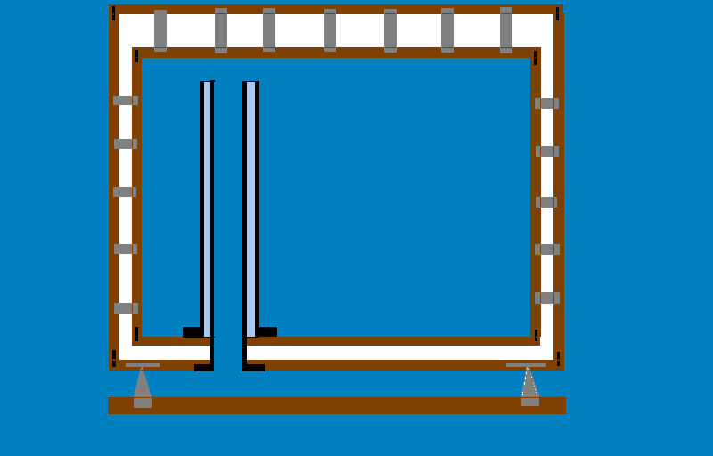

This is a side cut-away *without* the concret side baffle.. I'll get to that in a little bit.
Note that the only intended "scale" here is to show the difference between the 2 inch Top fill of sand vs. the 1 inch sides and bottom..
Key:
brown = mdf 3/4 inch
grey = bolts & spikes with support "plates"
black = vent tubeS with connection "plates", and screws (at the "but" joints of the mdf)
white = ultra fine sand
light blue = pure silicone caulk
blue = air

Ok, here is a side view with the concrete (actually just cement) baffle.
The Key is the same except:
Light Grey = cement baffle. &,
The little bit of orange'ish color is actual still just mdf - this time however it is 1 inch instead of 3/4 inch mdf.
(..and note that 1 inch mdf isn't really a full 1 inch - this means that the air space that is to be filled with ultra fine sand should be almost exactly the same "thickness" as the actual dimension of the 1 inch mdf.)
I'll provide a view of that orange 1 inch mdf from another perspective in the next post.

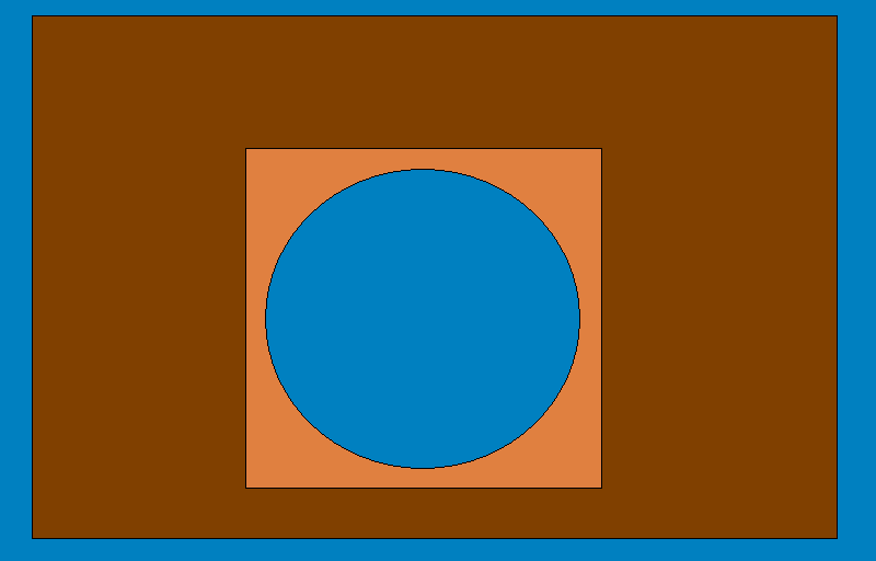

Here is the "spacer" (orang'ish brown) portion of 1 inch thick mdf:
(..note that the ultra fine white sand is absent in the picture here.. its just the 1 inch mdf spacer on top of the 3/4 inch mdf "exterior" box panel. That same 3/4 inch mdf baffle would be on top of the cement baffle.)
