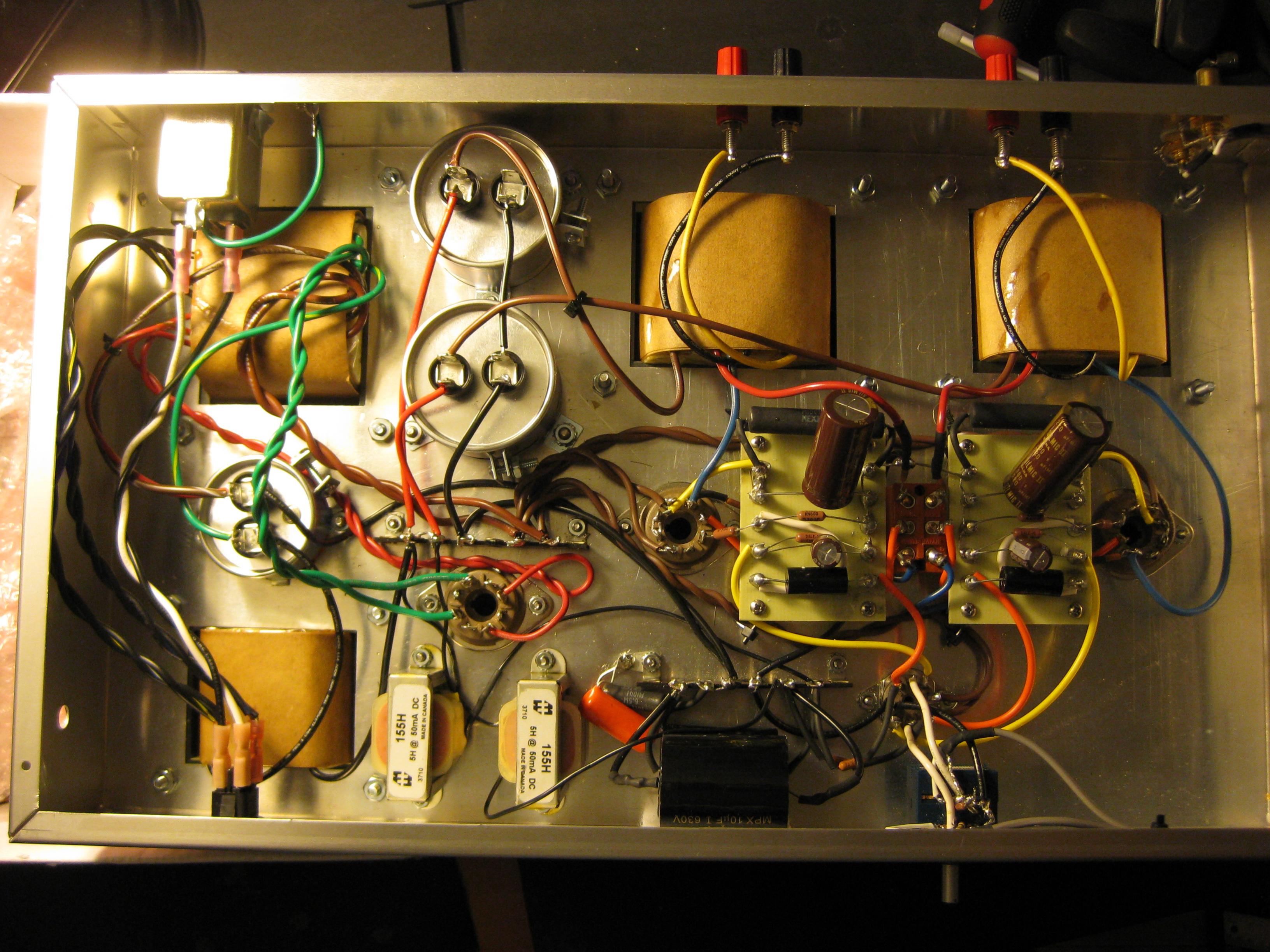

So this is long overdue, I apologize! School has been really busy, and any time that I've had away, I've been listening to this fantastic system I now have on my hands 🙂

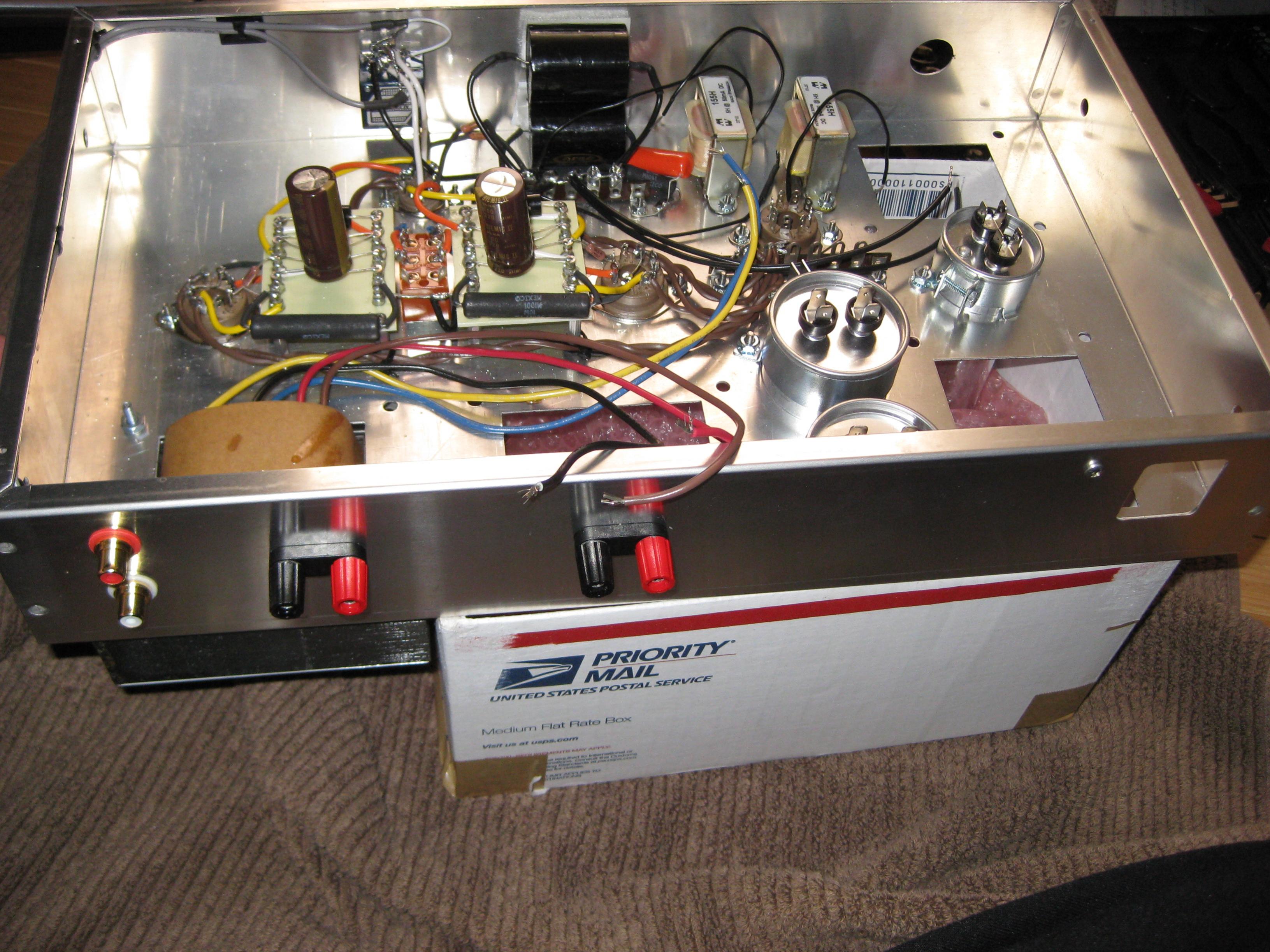

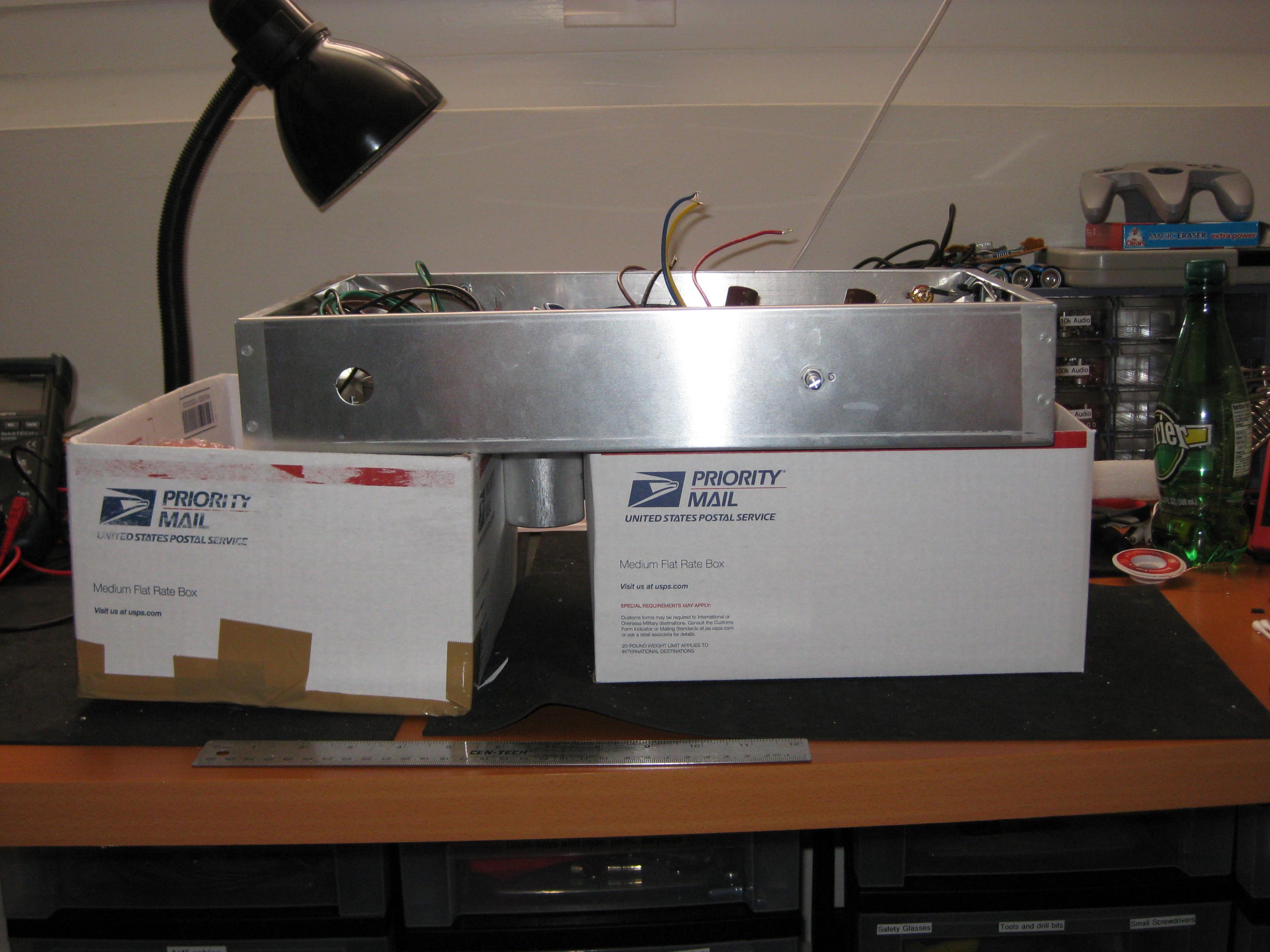

So I've found that two medium flat rate boxes make an excellent stand for working on the amp upside down after installing the motor run caps 🙂 (Figure 1).

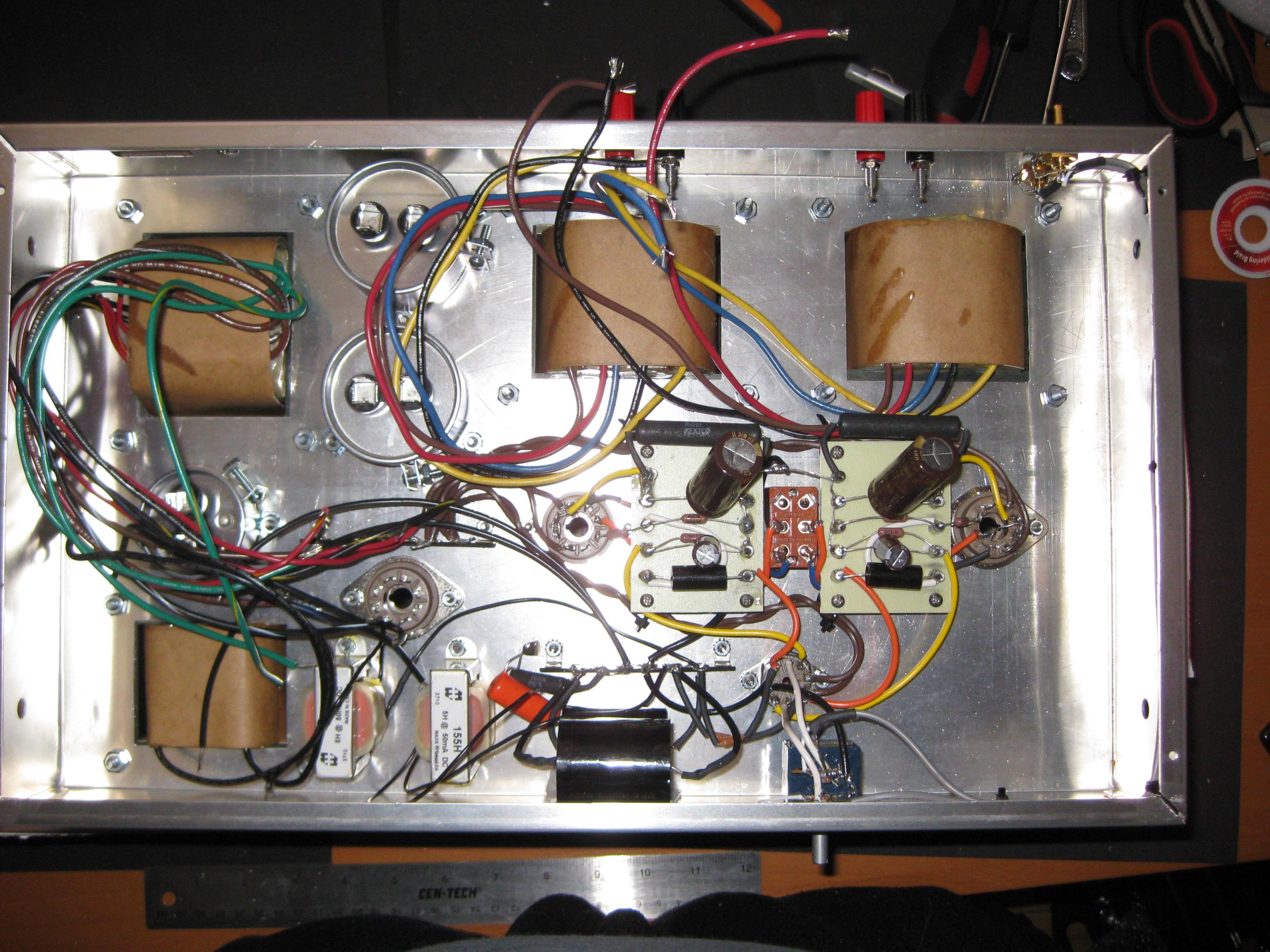

So I installed the first transformer (Figure 2)...and the rest (Figure 3). Then I wired it all up...only after ruining two crimp connectors and going to Radioshack to get new ones during the aftermath of the New England blizzard (of all things to get hung up on...crimp connectors...yeah...) (Figure 4).

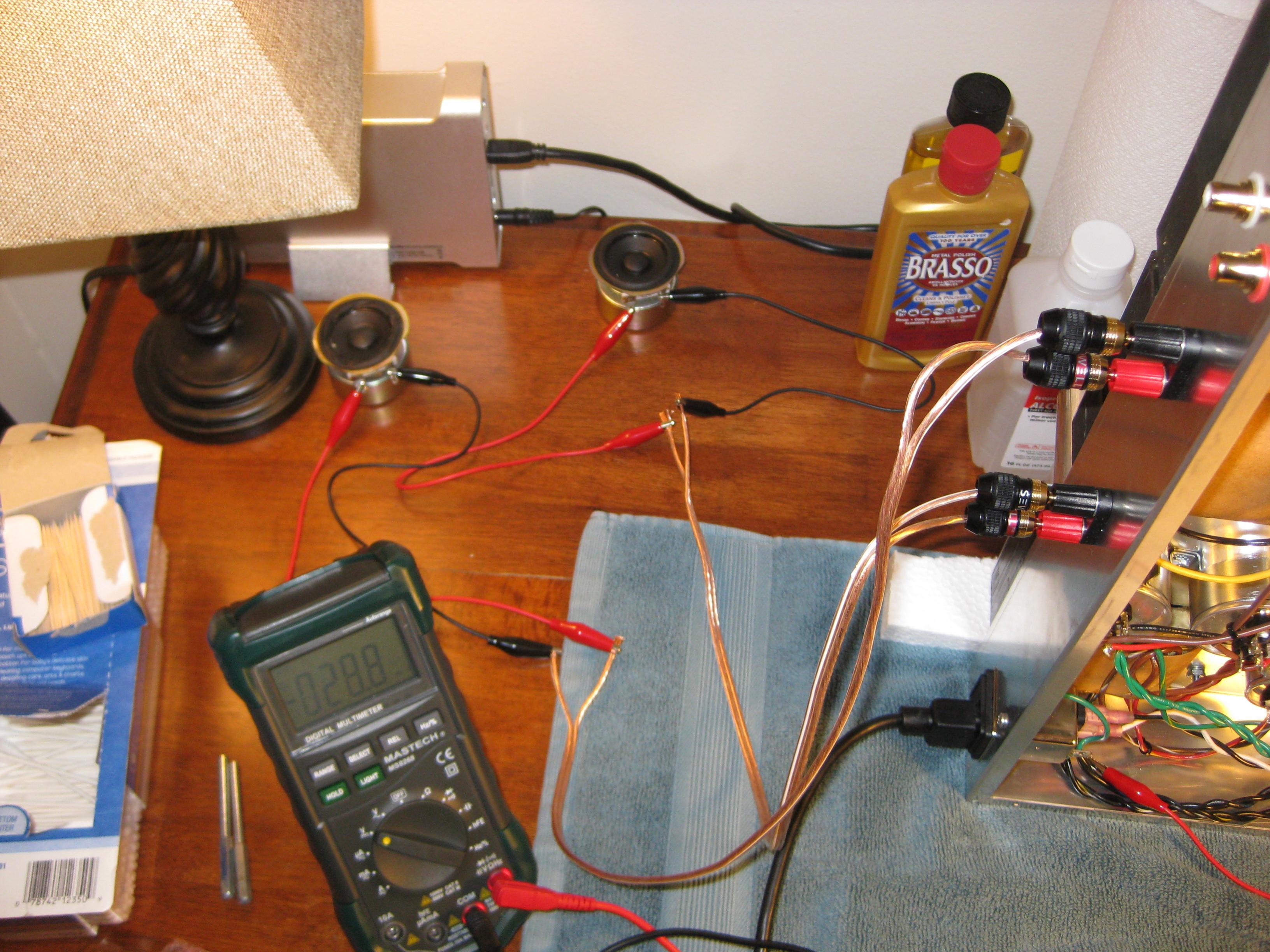

Thus, it was time to test! So I set up my multimeter, and my lovely Boston Acoustics surplus 3W 8ohm speakers 🙂 (Figure 5).
I then installed the tubes with shivers of excitement coursing through my veins... (Figure 6). I finished the testing...(SPOILER ALERT: Everything tested out 🙂 ).

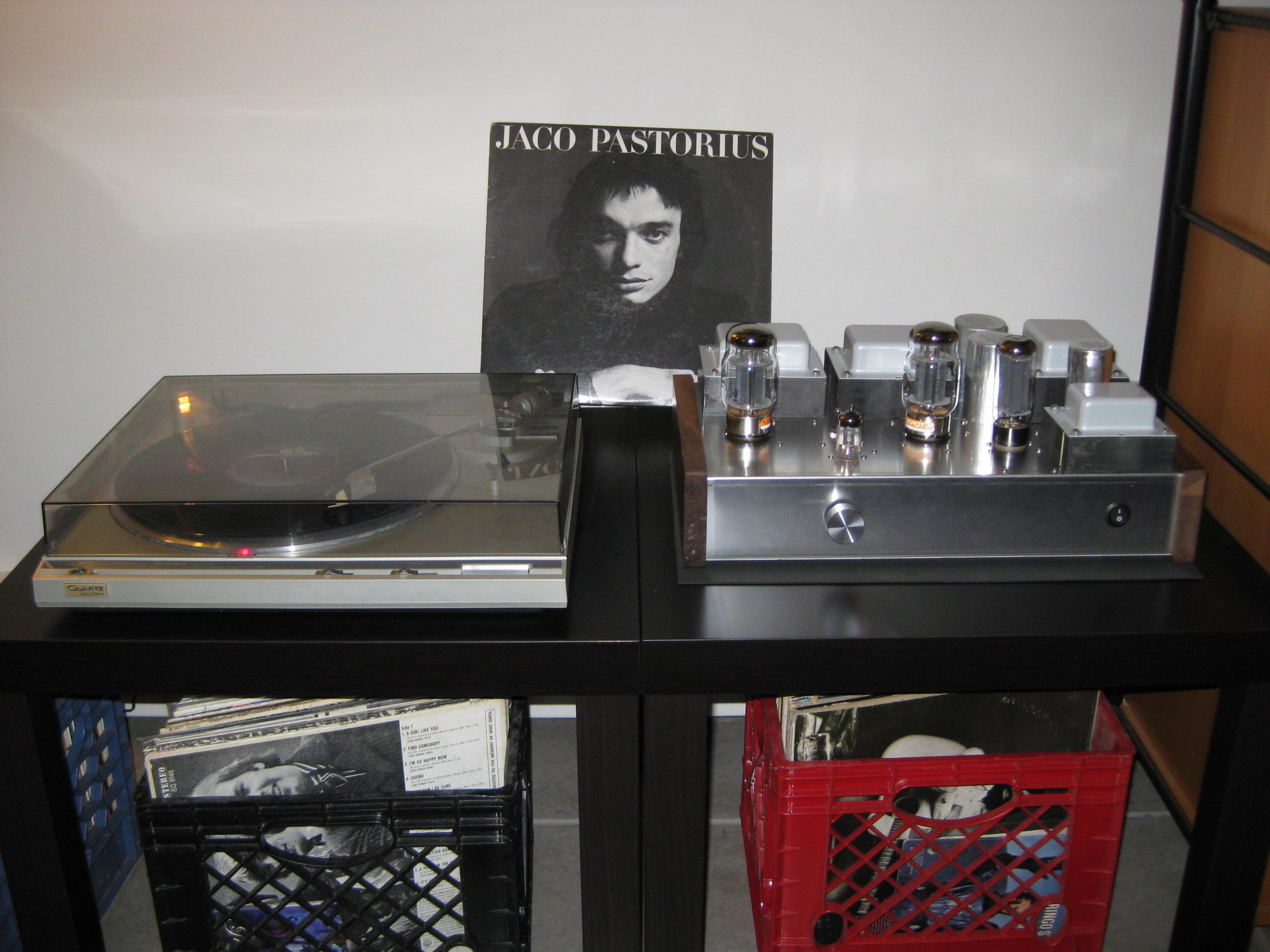

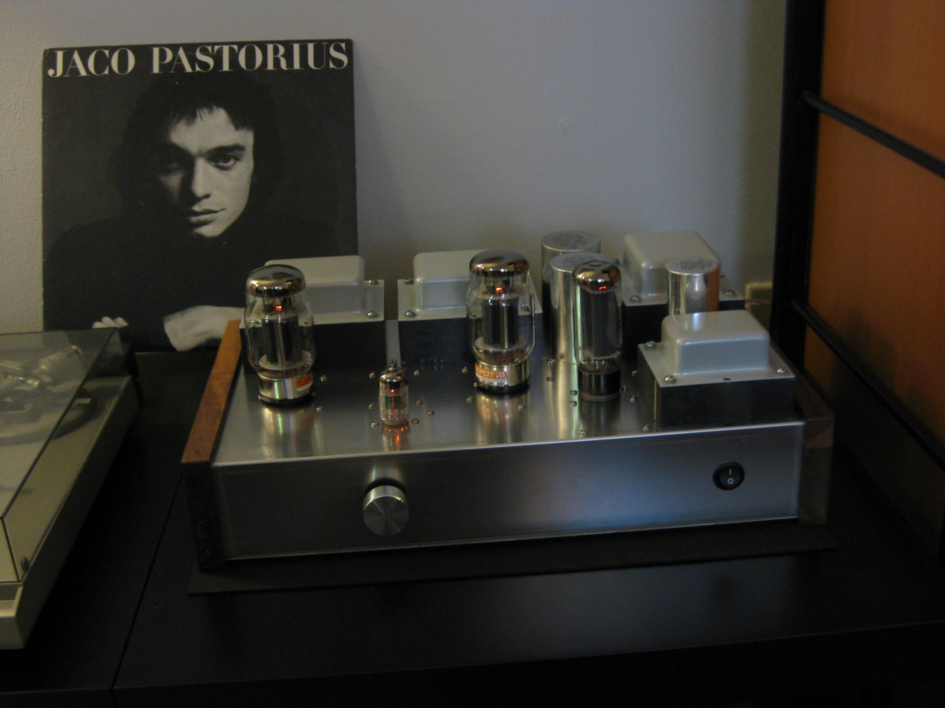

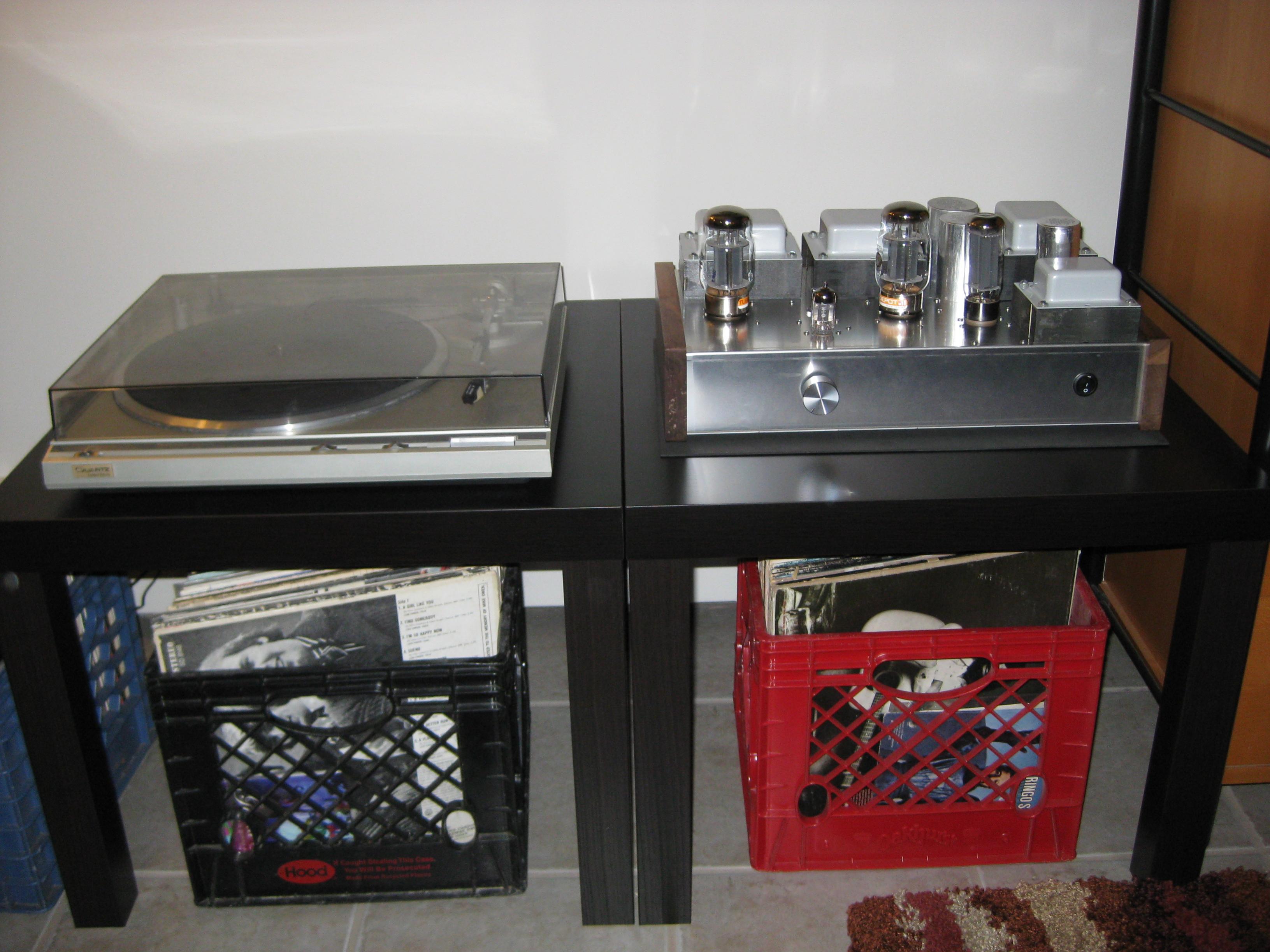

I then proceeded to hook it up to my system. Figures 7-9.
The first record I listened to is an important one to me. As shown in the picture, it was Jaco Pastorius' eponymous debut from 1976 (well before my birth 🙂). My father used to play Weather Report for me in the car when I was a very young child, and I simply did not understand it (as most 3-4 year-olds wouldn't). However, in high school, I rediscovered Jaco and simply couldn't get enough. Next to my dad, he became my musical hero. A love of Jaco's music has lead to me meeting and playing in bands with some of my best friends in the world. I used to say "If I am able to play the bass like Jaco, the guitar like Hendrix, and the drums like Billy Cobham, I'll be able to die happy." Not a lofty goal eh!? 😉 The harmonics in "Portrait of Tracy" were seemingly more beautiful and haunting than ever before.
After listening to the album (I was so excited, I couldn't be bothered to run it through my spin clean record washer 🙂 ), I listened to another very important album to me: Little Feat's "Waiting for Columbus." This is another album my dad played for me as a kid. I used to beg for him to play the "bathtub song," (referring to Fat Man in the Bathtub) when we were in the car. My dad happily obliged, and played a game of "find the beat" with me...despite the songs obvious innuendos 🙂.
As I sat there, and texted back and forth with my dad describing how amazing the new setup was, I could tell my dad was excited as I was that I had a new HiFi stereo system. He and my mom are going to be visiting me over Easter, and I can't wait to show the new stereo off to them!
Needless to say, we'll be listening to some Jaco, and some Little Feat 🙂

It makes me very happy to hear that it worked out so well for you.
Now, just finish school, enjoy the great music, and save up for those Klipsch Horn 105dB La Scalas!

Congrats BE on your pretty amplifier.
I finished mine too, and the power testing went perfect. I am having trouble with one of the channels though (left). It started with no sound, and after going over all the connections a couple of times, I have about 1/3d volume on that side over the other. I have ordered another driver tube. Swapping the power tubes did not change the imbalance.
Open to any other directions from Scott. I took some pictures, and will try and upload them this week of my build.

Absolutely Beautiful work there BE! Looks it was store bought at a High End Audiophile Outlet.
Your pals will certainly be envious of you!

What anode and cathode voltages did you measure for both channels of the 6N1P?
If you have a 6922 or 6DJ8 you could temporarily install one of those. It won't be ideal but it will be fine for verifying that it is indeed the tube.
I'll be glad to send you another 6N1P if it turns out to be bad.
Scott
Scott

Just my two cents,I like this amp better with el34s I might be wrong but I think the kt88s are not driven hard enough?
Yes, the amp as designed is about 62% of the maximum plate dissipation of the KT88. This allows for extended tube life.
A 3K or 2K7 3W resistor can be paralleled with the 560R KT88 cathode resistor to make a ~470R resistor. This will give you 70% of max dissipation, about 80mA.
Apart from that, the B+ would have to be increased.
