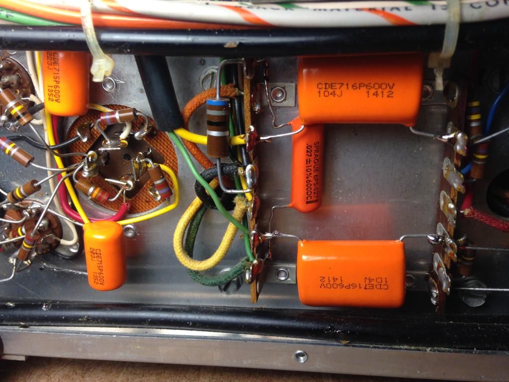

IMO, the only "Orange Drop" caps. allowed in the signal path are the 716P series. 716Ps are made with discrete polypropylene film and aluminum foil. The leads are copper, not steel. 716P caps. come in 400 WVDC and 600 WVDC "flavors". AES carries 716P series "Orange Drops".

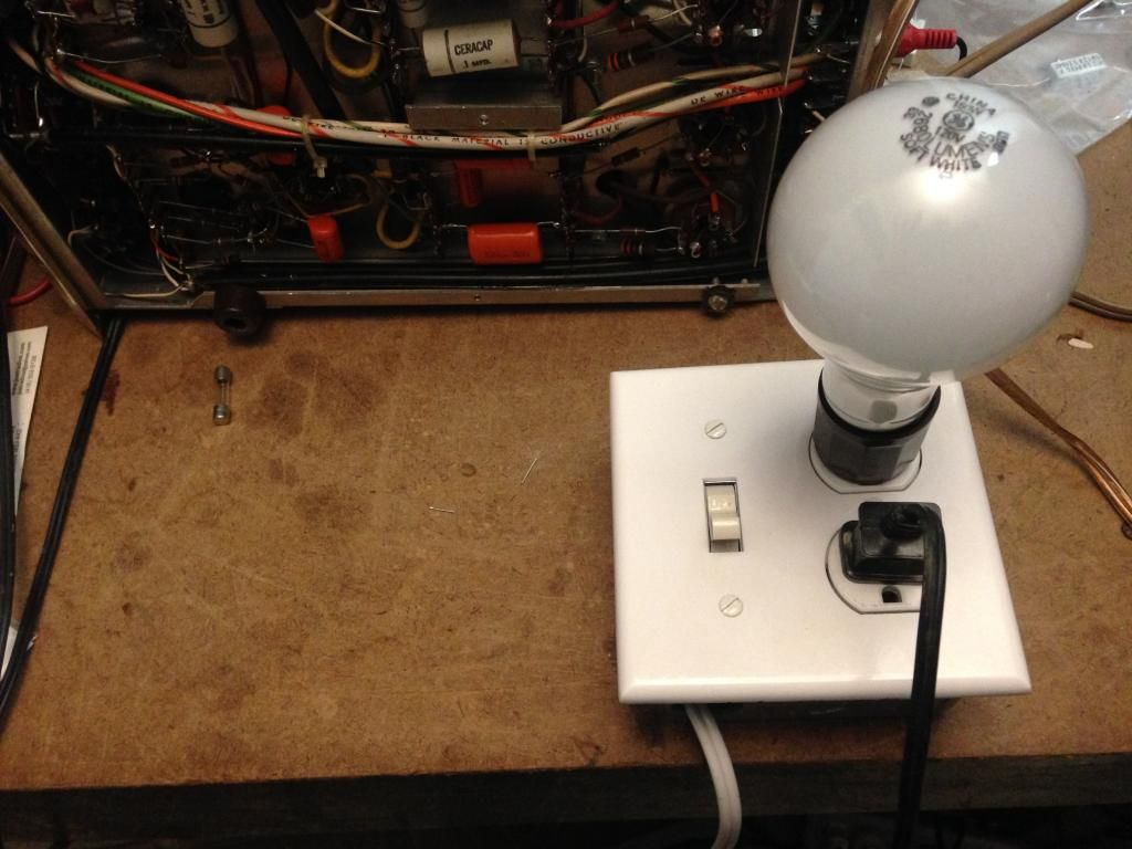

Never, ever replace a fuse with one larger than the one originally installed; power transformer HV secondaries do short under duress and if you are lucky the transformer is OK, if not you've created yourself a boat anchor.. You should never just replace the fuse and power it back up without figuring out why it blew in the first place.
Grab an extension cord and wire a lamp socket in series (not parallel) and install a 100 - 150W incandescent lamp and plug the amplifier into this for all future trouble shooting - it will protect expensive and irreplaceable components in the amplifier from damage. (Search for dim bulb tester etc here for more details)
As you've discovered variacs without some means of current limiting (the lamp I mentioned) don't provide a whole lot of protection in the event of a fault and lull people into a sense of false security..

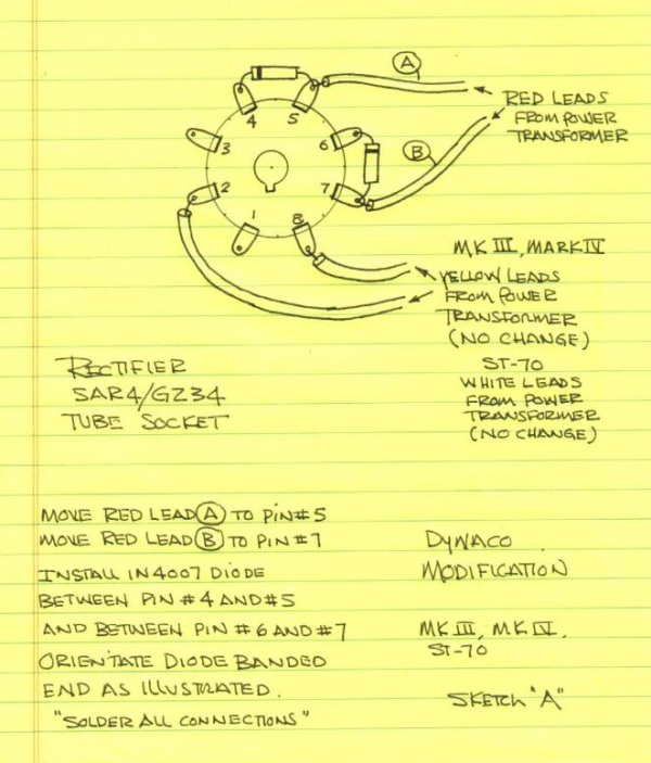

Put a Sovtek 5AR4 in the unit. Also, if you haven't already done so, add the SS diode tweak. Instead of the 1N4007s shown in the uploaded graphic, use UF4007s. UF4007s generate much less switching noise than 1N4007s. Even though the vacuum rectifier should suppress the SS generated noise, less noise, from the outset, has to be better.

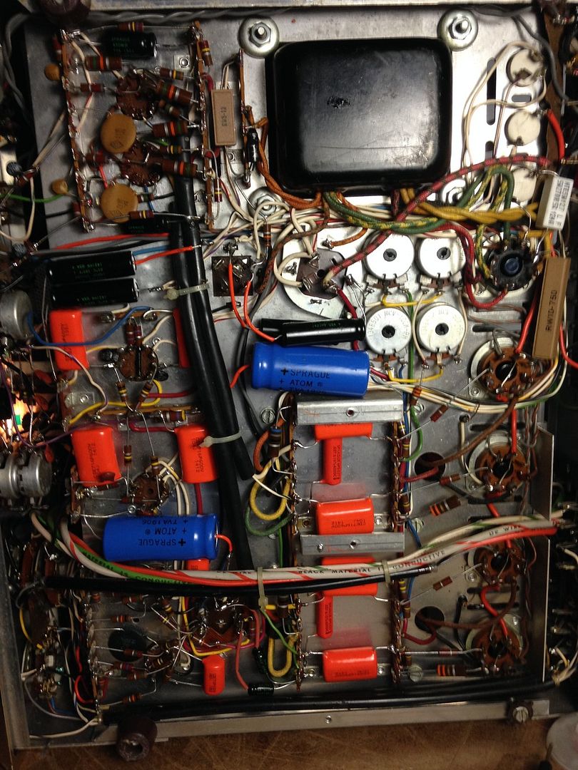

I would be more than willing to help you fix up your stereo. With the help of some strong coffee I did my 299A in an afternoon. That included replacing the selenium rectifier with silicon for the preamp tubes, their associated capacitors, as Kevin pointed out you will not find a can replacement for this one but as myself and others have done is fit discrete caps along the tag board, there is plenty of room. I also replaced the coupling capacitors and other filter/decoupling capacitors.
I have some documents for you that I will scan and use some graphic editing software to show you visually what and where to replace. If you can follow directions and solder this forum will get you up and running🙂 And to think, when it's all done and you are enjoying some music on her you can look back and think to yourself "I did this". That my friend is the best feeling in the world.
First things first, since the rectifier arced and maybe damaged, floating the PT secondaries and using a dim bulb tester is a good way to start before ordering any parts. In any case if AC did arc from plate to cathode inside the 5AR4 all polarized caps could have been damaged so I would not try to hook up anything after the rectifier, especially without a dim bulb tester.
If you don't have a dim bulb tester this would be the time to make one, As stated a variac does not limit current. Not only does the dim bulb tester give you a visual indication of something wrong (it will start to glow really bright) but it doubles as a fuse🙂

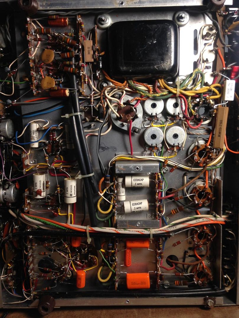

I did see the photo's you posted before. Can you take more? Maybe one of the whole underside, that way there I can use image editing software to highlight the areas of discussion.
Yes i can take some more pics i will post them later this evening the serial number starts with 275 so it is a later model . i also have a new rectifier tube on the way . i will make the current limiter you are talking about tomorrow .😀

Hello guys after lots of painstaking work and lots of help from [famousmockingbird]

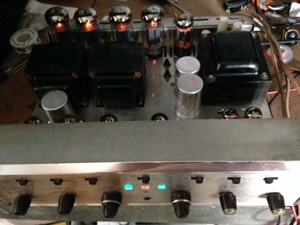

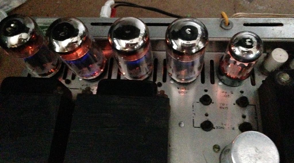

The Scott is back up and running like new with all new tubes coupling caps and electrolytic caps and plays and sounds fantastic . i replaced one can cap completely with a new one and the other 2 i disconnected them and fit axial caps underneath which was a task space is limited under there . ran into a few issues of course it kept blowing fuses [which was the initial problem before i started] but not until it got to about 105 volts turns out it was arcing at the rectifier tube connections and also the B+ lead going to resistor 206. after that problem was solved i set the tube balance and adjusted the bias and sent readings to [famousmockingbird] ,22 volts at test point 479 volts B+ at the rectifier tube 455 volts at the output tubes also -25 volts at pin6 of the output tubes . Man does this amp sound really good deep warm bass at all levels wow.
I also installed a new GOLDLION GZ34 rectifier tube made by Genalex .
Here are a few pics i still have tp do the cosmetic cleaning now but the hard part is over
