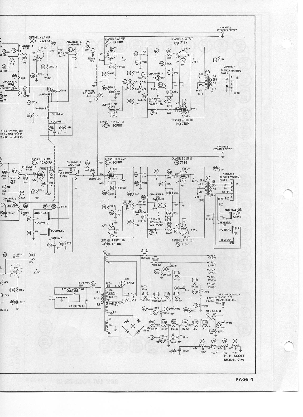

Ok so I just picked up a scott 299, and I believe it is the first generation because of the OPT placement. It came with no tubes, and sold as is but I got it pretty cheap for a project. I plan on pairing with some old Klipsch Heresy's when done.
I am pretty sure the PT is fine, I fired it up with no tubes and I cut the two orange wires for the bias/heater circuit and left them floating due to the hack job I saw when someone "upgraded" the selenium rectifier. All the voltages look good on the secondary and the fuse didn't pop
I have an 8A 400v silicon bridge rectifier to put in but was curious on the value change for resistor 106, stock is 10R but from what I read on the web most people find that 33R is used to compensate for the more efficient silicon rectifier.
Another question I had with the bias/heater circuit is do the 100-100-10 can capacitors have a common positive connection? It must because of the way they are wired but the schematic shows that the - side of the 100uf caps go to ground. This doesn't make sense to me? Anyway I think the new caps I install will have the - lead at the resistors and the + going to ground.
Ok so output tubes I plan on getting the russian military version of the EL84, I believe they are EL84M and are suppose to be a 7189 replacement.
I am also going to replace all of the black pyramid caps with some orange drops.

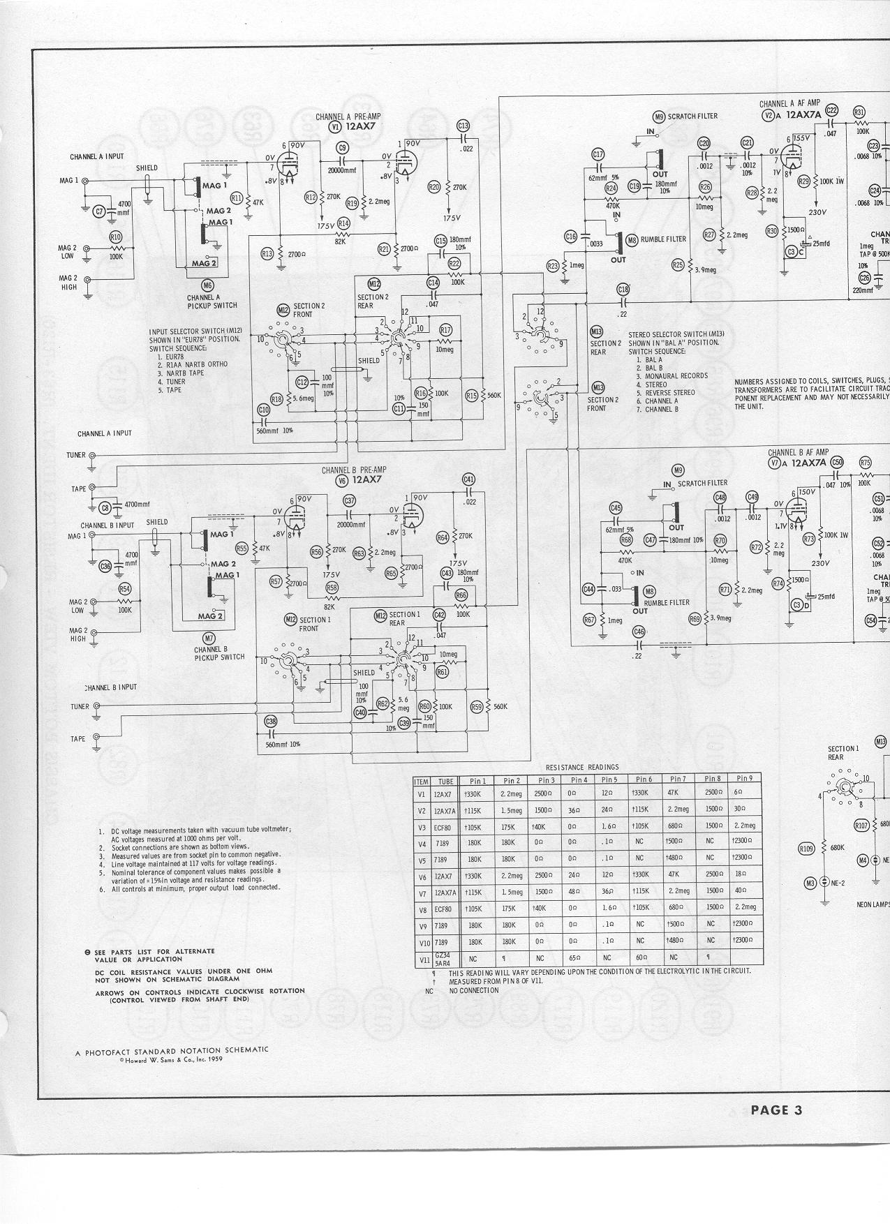

I am not sure if anyone else has encountered this but when comparing my amp with the resistance chart they give you my amp was pretty spot on except for R42 and R86. They are suppose to be 680R but measured 680k for both, to boot the color bands on the resistor are correct for 680R but I think they might have been mislabeled.

Well, you are correct about the filter capacitors. The drawing is wrong! And the resistors in question should be 680 ohms, not 680K. Part of your problem is that you are looking at a Sams schematic which are prone to errors. Too many stoned heads working there in the 60's. Always use H.H.Scott Schematic Library.
I caution you to not replace any capacitors in the RIAA (or other) equalization circuits with modern fast dielectric types (polyproplyene, polycarbonate, polystyrene, etc) because they will affect the frequency characteristics of the network even if the same values are used. They tend to accentuate higher frequencies. All the other paper capacitors can be replaced with Mylar (polyethylene) orange drops with good results.
An eight amp bridge is overkill, but ok if it fits. And a 33 ohm resistor seems about right although the 10K bias pot would probably take up the excess voltage. And I would put 10 ohm resistors in each 7189 cathode to measure quiescent current across. Scott cheaped-out there.

I know it is overkill but I like how the 8A has it's leads as appose to all the others I saw, and actually it was roughly the same size L x W but just a little fatter.
" And a 33 ohm resistor seems about right although the 10K bias pot would probably take up the excess voltage"
I was more worried about exsessive voltage for the heaters going to valves 1, 2, 6, and 7. I guess I will start with 33R and go from there.

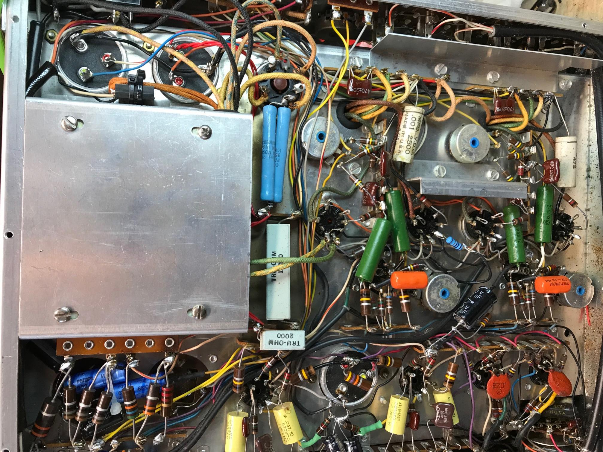

Well I finished up the cap job including all electrolytics and coupling caps (I left a lot of caps in the front/control section of the amp alone including thee RIAA section). I replaced the two 680k resistors on the ECF80's with correct 680R. All plate load resistors were spot on so I left them in, after about a week of listening everythings seems to be good. The amp is dead quiet and sounds fantastic! I can't be happier with the results and I want to thank Hollowstate for the knowledge
The amp is bias to where I read 20v across the big 20w 160R power resistor, but the power transformer is still pretty darn warm after a few hours of operation. Not as hot as some of my guitar amp transformers get but still pretty warm. My question is do people run the amp without the enclosure to dissipate heat? Or does it not really matter?

I found my notes when I bias the amp:
DC resistance / Voltage drop / mA in current
159 / 3.5 / .022
143 / 3.0 / .021
158 / 3.8 / .024
149 / 3.45 / .023
The .023 and .024 are a pair and the .022 and .021 are a pair.
My plate voltage is a little high at 415 but I think that is because my line voltage is 123vac lately. It usually is between 117 and 120. But still at 415vdc plate voltage and .024mA I get 9.96 watts which is only 71% plate dissipation. When my line voltage drops back down it will be running even cooler

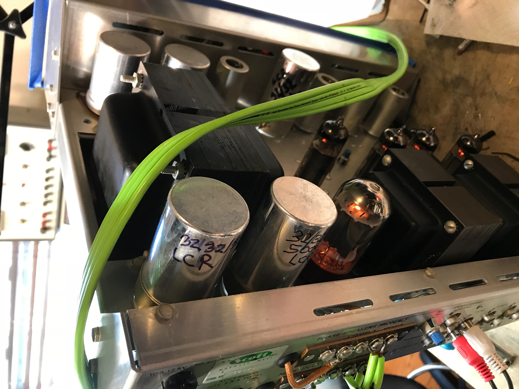

I know this is a late post, but anyone looking for info on why their 299 scott has crazy b+ voltage:
I've got a 299 but the version 2 amp.
It uses the 299b outputs, which means the outputs run at 420v on the plates.
For my amp I ended up around -12.5v on the grids measuring about 10w per tube. Make sense since the tubes are old soviet 7198 subs.
So if your 299 labelled scott amp has 420 or so on the plates, don't sweat it. If it has the larger transformers around 120 ohm per output winding, it's normal.
I soldered a 10 ohm resistor to measure actual current in the cathode circuit and used a matched quad.
Also after replacing the selenium bias rectifier I changed the first smoothing cap from 10 to 33 ohms to give enough range to bias the tubes.
If you want to run them at more than 10 w, a larger resistor is needed.
Other stuff:
The newer can caps can fit through the hole where the old combo caps are. I had to file the hole a bit, then strip the blue plastic off of a lcr dual cap, slide it down throught the hole and clamp it to the chassis. This enables me to put a taller cap in it so the cover fits.
82v 100uf caps work great to replace the bias caps. Small and fit great.
I also bumped the first smoothing resistor up to 180 ohm to help compensate for increased ac with paralleled 360 10 watts.
