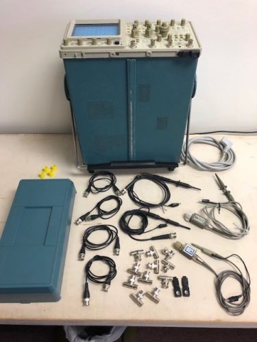

I just pulled the trigger on this one !!!!
It will be here next Friday Wooooo Hooooo !!!
I have waited at least 7 years for this day.
It's a 350Mhz and not a 400Mhz version but will suit me nicely for what I need.
Jer 😀

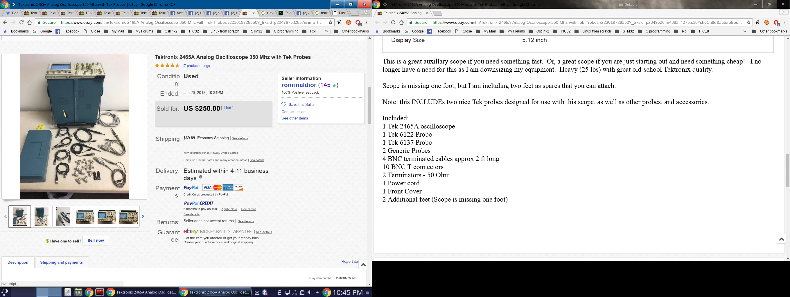

Tektronix 2465A Oscilloscope 350 MHz Four 4 -Channel Analog | eBay
P.S this is the model I got, but not the same Ebay page as they take those that are bought off the site right away below is a screen shot of the details for it.
Great choice, I own one myself, its a really good scope, has some of the advantages of a digital scope like markers and such, however I regret not buying the 2467B which has a much better CRT.
Ya I wanted a 2467 type but for the price I couldn't pass it up, if needed I will have it refurbished and calibrated next year and meanwhile I will keep my eyes peeled for a 2467B as well. 🙂
jer 🙂
