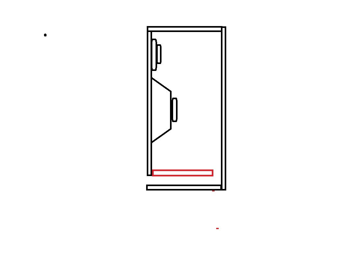

So there is one chance to go for a bass reflex design to gain more bass....
But i was offered one other design that i am sceptic about and i need opinions
The guy who calculated the box sent me a brief diagram and promissed to produce more bass than a typical bass reflex
can you comment on the idea ? ( later on i expcect dimension and choice of units )
Excuse the graph is poor

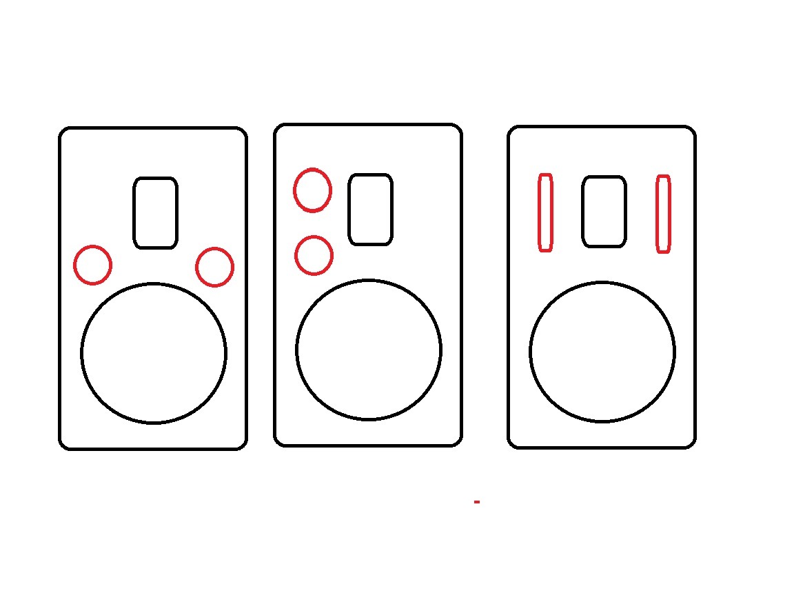

hint here is that if one calculates given size, to given units , with a front bass reflex design there is a very good chance that the size of the box cannot accomodate the bass reflex tube ...Height of the enclosure might not enough for that ....
One option will be a double but smaller calculated reflex left and right of the tweeter,
other option will be to have oval bass reflexes again left and right of the tweeter Behringer style
and the last option is to do a port like the picture seen above or any other idea
So it could be any of these designs or it could be a port Question is what will produce the most bass
At low volumes, given the same box tuning (Fb) all the ports will perform approximately the same in the low frequency, though proximity to the woofer will create different phase cancellation effects in the midrange frequencies.
The larger area, deeper rectangular shelf port depicted in the first post has more enclosed volume than the smaller ports depicted in post #3.The larger enclosed volume port will have a lower vent velocity, so will be able to be linear to a higher sound pressure level than the smaller ports.
At high volumes, the deeper shelf port will produce the most bass .
