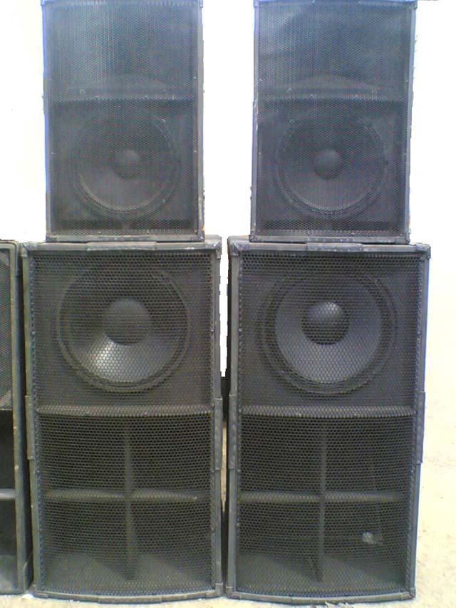

Scoop Bins + Midtop problem
Well I don't have any picture of it but I might arrange one if time permits.
The tops have handles and we just hanged these from the ceiling (or whatever) by running some packing straps down through one of these handles and around the bottom and up again on the other side. I.e the handles were just used for keeping the strap in place and not to carry the weight. We did not use any real flying harness. Doing this you have to watch out to comply with local safety rules. Since we mostly use the system for private parties this is less of a problem if common sense is used.
Regards
Charles
That's how I use to fly them (this one is smaller than yours though). Moving the tops a bit out od the scoops nearfield might help by great lengts. Youll hjust have to try to find out.
Regards
Charles
Crissty, please do a simple experiment for me. Sit the mid/high boxes on the scoops as normal, but don't connect them to anything. Fire up the bins to working volume, and see if the cones on the mid drivers move. I suspect they won't.
It does move.
IMO Plugging the ports might not solve the problem, cause the box volume is approx 70liters, and so would not restrict the movement of the cones.
I think the best solution would be to use Mids as horn loaded with small back chamber.
