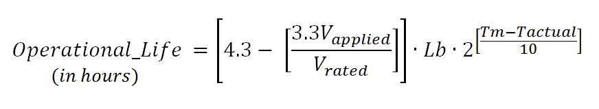

For those who are REALLY interested in temperature-accelerated failures of electrolytic capacitors, I recommend this excellent application note by Cornell Dubilier: LINK 1
It contains their Arrhenius model of capacitor lifetime:

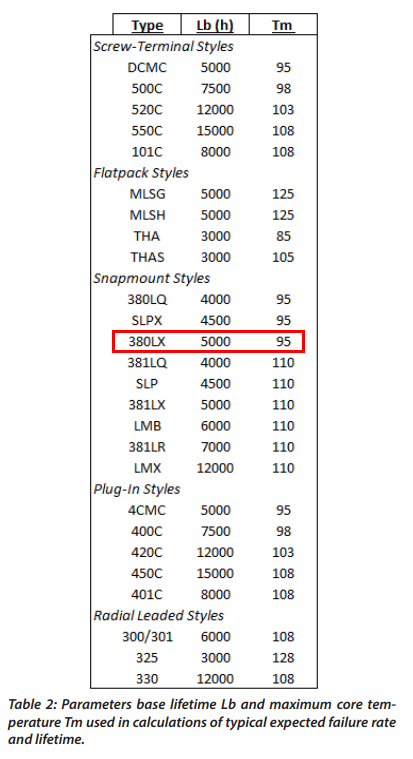

Let's use the capacitor and the temperature data in post #41 above, to work out an example.
1. The capacitors on that PCB (25mm diameter, 10000uF, 50V) are Cornell Dubilier 380LX103M050J052 (DigiKey link).
2. The sales information on the DigiKey page says "3000 hours @ 85C"
3. Let's assume the SeeK thermal image is incorrect by 2 degrees, and the capacitor temperature is really 63C, not 61C as displayed on the image. So "Tactual" in the model is 63C.
4. The operating voltage in the LM3886 ChipAmp application is 32VDC ("Vapplied" in the model) and the capacitor rating is 50V
5. Looking at the handy table provided by Cornell Dubilier and attached below, for this 380LX capacitor, Lb=5000 and Tm=90
6. Plugging these numbers into CDE's mathematical model gives: Operational_Life = 71 thousand hours. Not bad for a "3000 hour" capacitor.
7. And the reason WHY it's so good, is: we used Schottky rectifiers. They heat up a lot less than other rectifiers because their Vfwd is a lot lower.
