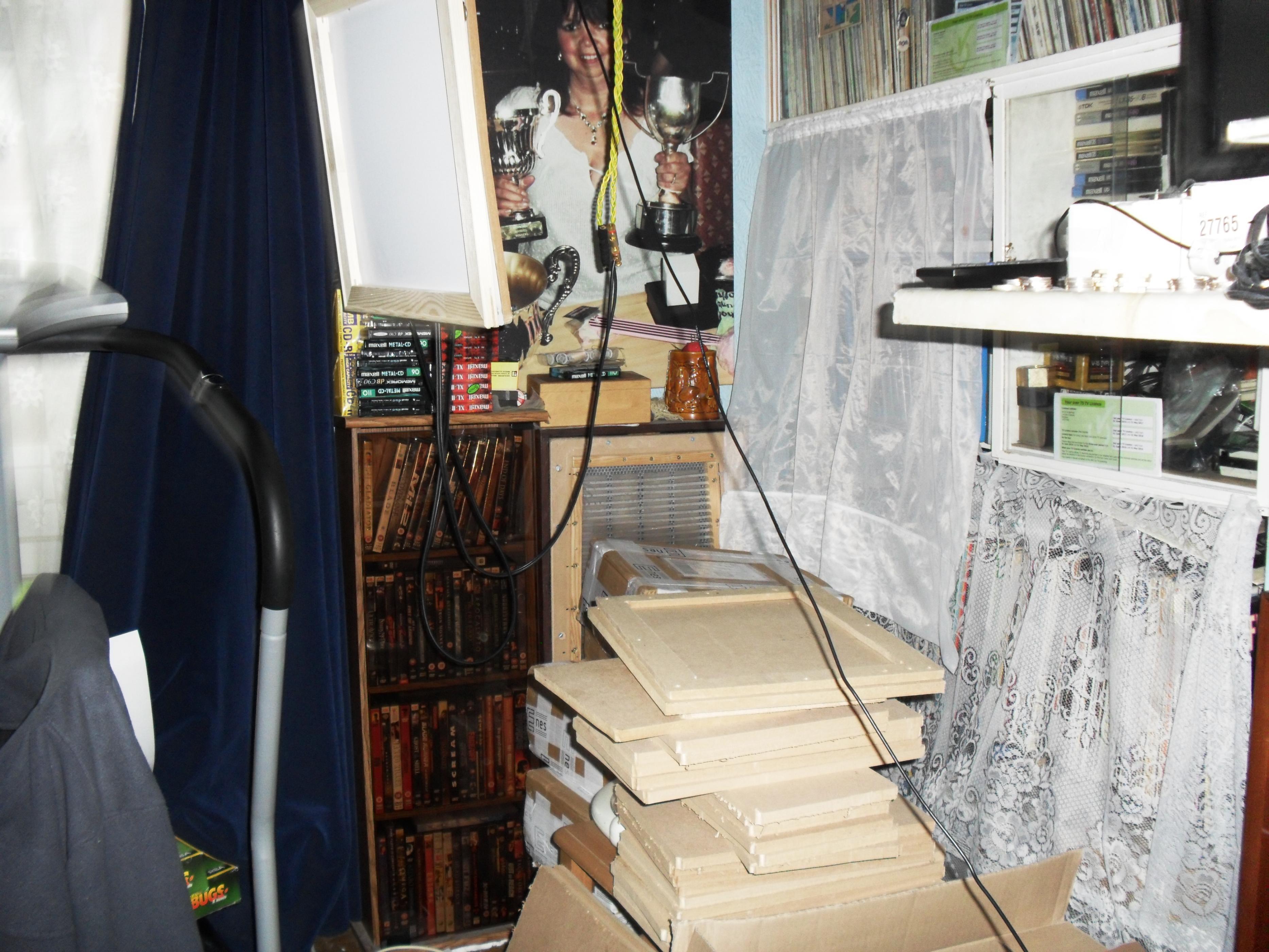

My speakers are all full range, and use aluminium tape already glued, never used corrugations never needed any anyway. Used to build big ones 4' x 2', but stopped building big ones too heavy at my time of life (79). My latest pair are 16" square, have a few more bits to use up.Used to cut my tape from 9 mm width down to required size must have cut 100's of meters. But mostly buy 3 mm tape now, have also used 5 mm wide tape as well depending on the width of the magnets which varied from 12.7 mm to 25 mm. Also I have changed my method of laying the tape. A lot easier now, and takes up less room on the cutout edge!
