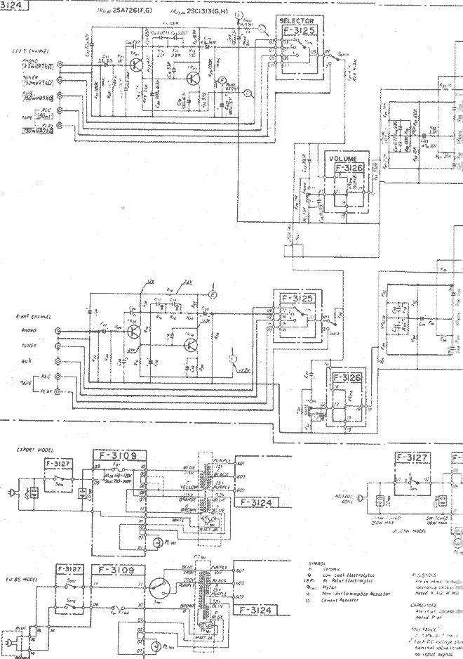

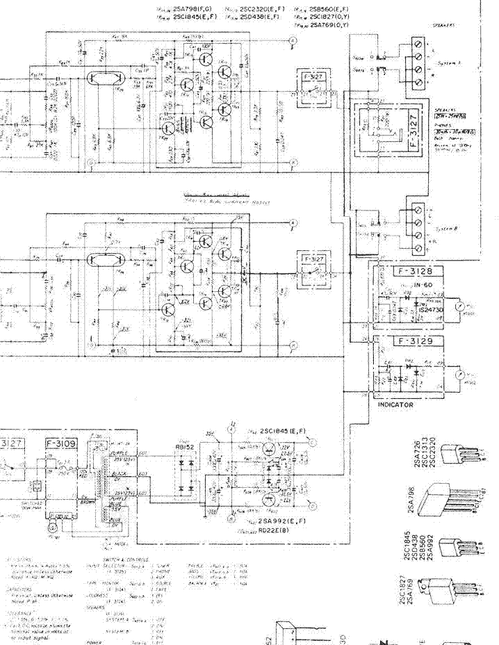

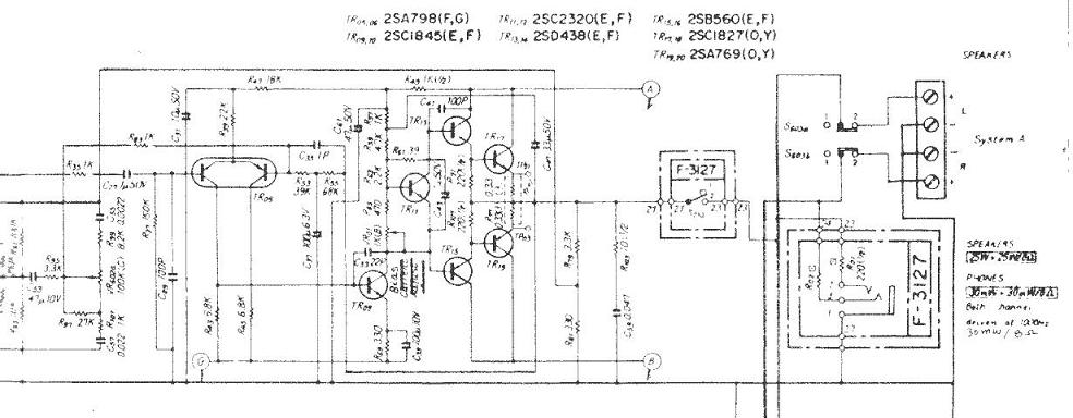

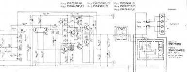

Thanks - the image seems to be a bit blurry, however.
For the life of me, I cannot understand the feedback network consisting of R53 (?) (39k) , R55 (68k), C17 (100u/6.3v), C33 (?) (1 pF), R19 (?) (1k) , around LTP TR05. Probably some missing components?

linuxguru said:Thanks - the image seems to be a bit blurry, however.
That network provides DC feedback, not AC feedback. That big electrolytic to ground filters out the AC component. This is necessary so the amplifier can steer its quiescent DC operating point.
AC feedback is sent through the Baxandall tone control network. I've seen this scheme in a few old designs. It keeps the input bias current from flowing through the tone control pots, so the amplifier won't suffer a fit of when a pot wiper starts to wear.
Glen
OK, I spotted that loop - starting with the resistive divider with R79 (3.3k) / R41 (?) 330R connected to the output. So this is probably the active variant of the Baxendall network, with the transfer function of the Baxendall being part of the feedback network. That's going to be impossible to analyse without the rest of the schematic, in particular the Bass control of the Baxendall and the take-off point for the input to the LTP.
