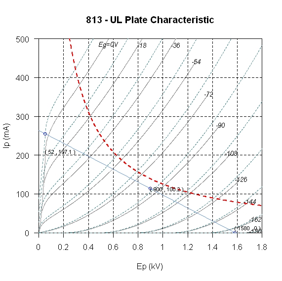

Look at original voltages, especially on G2. I called it "Insane", because I myself use them in A2 with twice lower G2 voltage and 850V B+, getting 30W from a tube. With given voltages, it would be enough juice in A1, so cathode bias is fine.
G2 is rated for 1100V, AF pentode operation. Triode mode often allows even higher G2 voltages. Kathode bias is not recommended according to the datasheet though.
900 v on a 813 screen sounds high UNLESS the current is very low... better look up the screen dissipation before applying power. 813's were used in RCA AM broadcast transmitters in the 250-500 watt range; I don't recall the screen voltage over 400 with 1250 v on the plates.. (two 813's p-p AB1 modulator, two 813's in parallel for RF...)

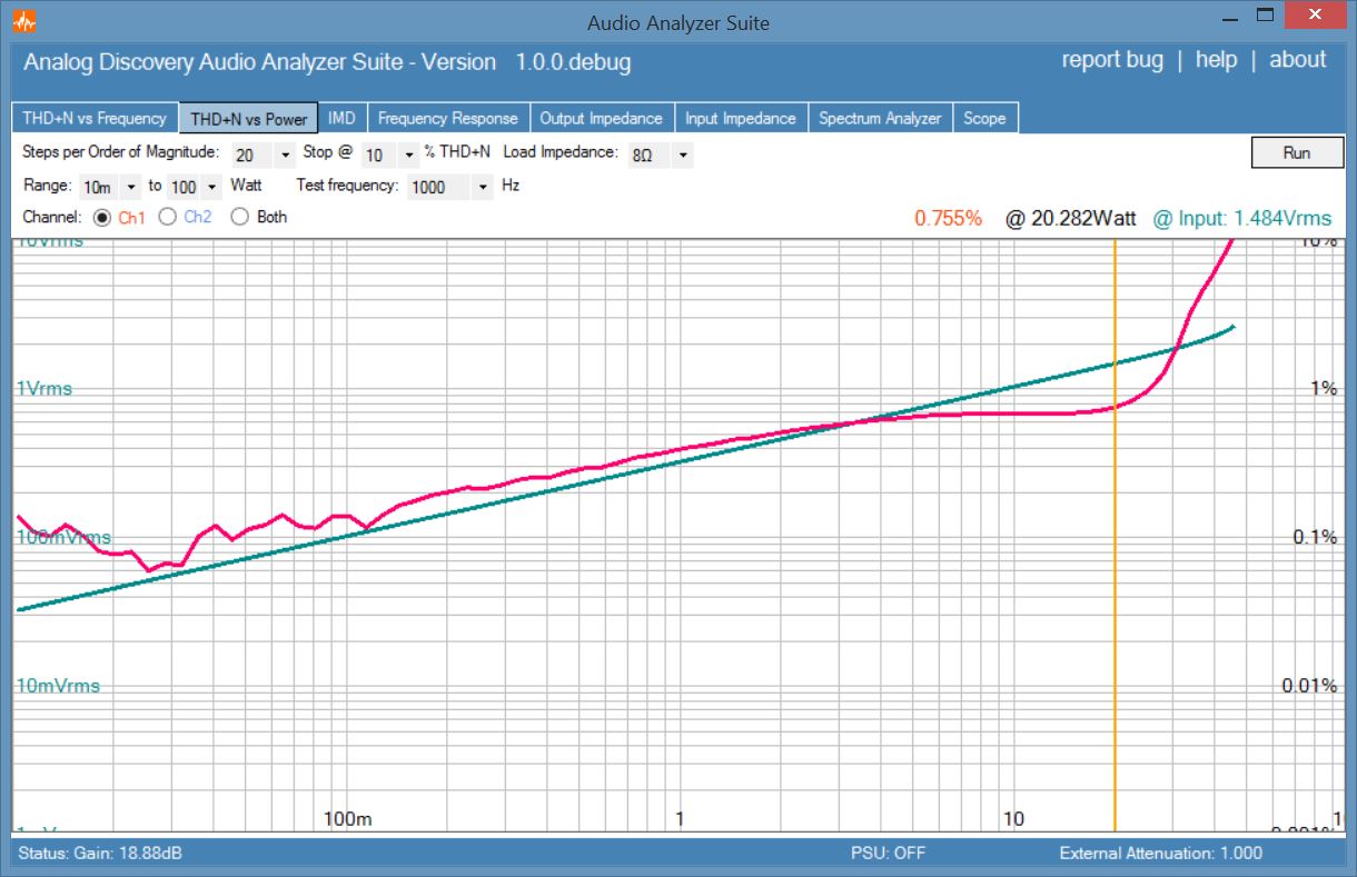

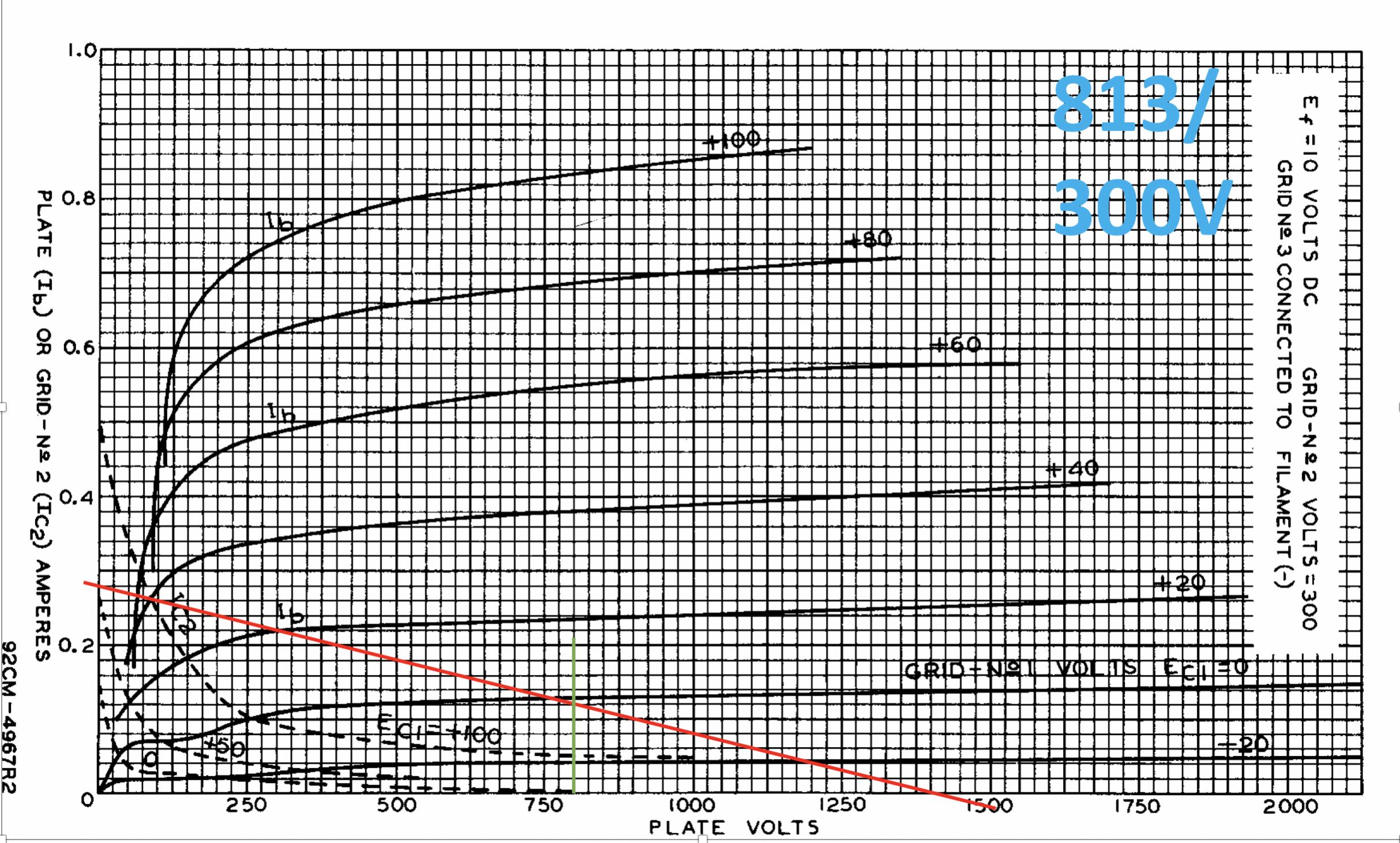

I've been working on am 810 amplifier, and decided to try out some other transmitter tubes. One of them is the 813 driven as a pentode.
I'm attaching the schematic showing measured voltages. It's still work in progress and is probably not optimal since it has grown over time. Thanks to audiowize for his advice nudging me towards the cathode follower for the grid current needs of the 810. The operating point I picked for the 813 puts it close to zero. So I have a 100 Ohm cathode bias on the 813 to bring the grid bias to about -4V. That gets me 120mA of plate current at 800V on the plate and 300V on the screen. The OPT is the Hammond 1628SEA which has a 120mA current limit.
As you can see from the attached THD vs pwr sweep, with 12db of GNFB I'm getting 0.75% THD at 20W and about 1.8% at 30W (max for the OPT).
I've used this setup to test 809, 810. 811A, 812A, 813 and 814 tubes. I'll post the results to another thread once I've finished testing.

Yes he did - triode strapped, class A1. I thought I'd post this since the 813 is being driven as a pentode in class A2.
