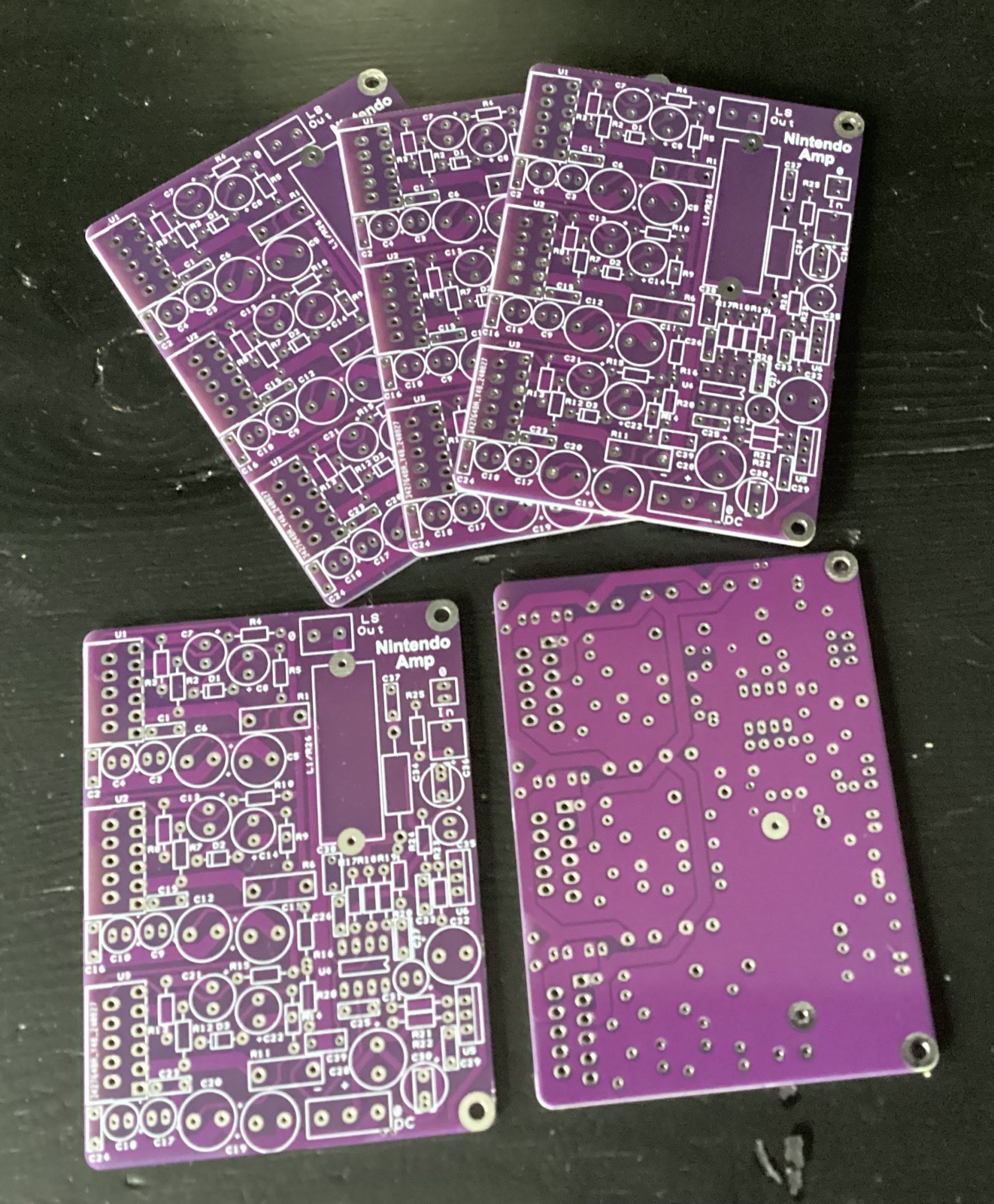

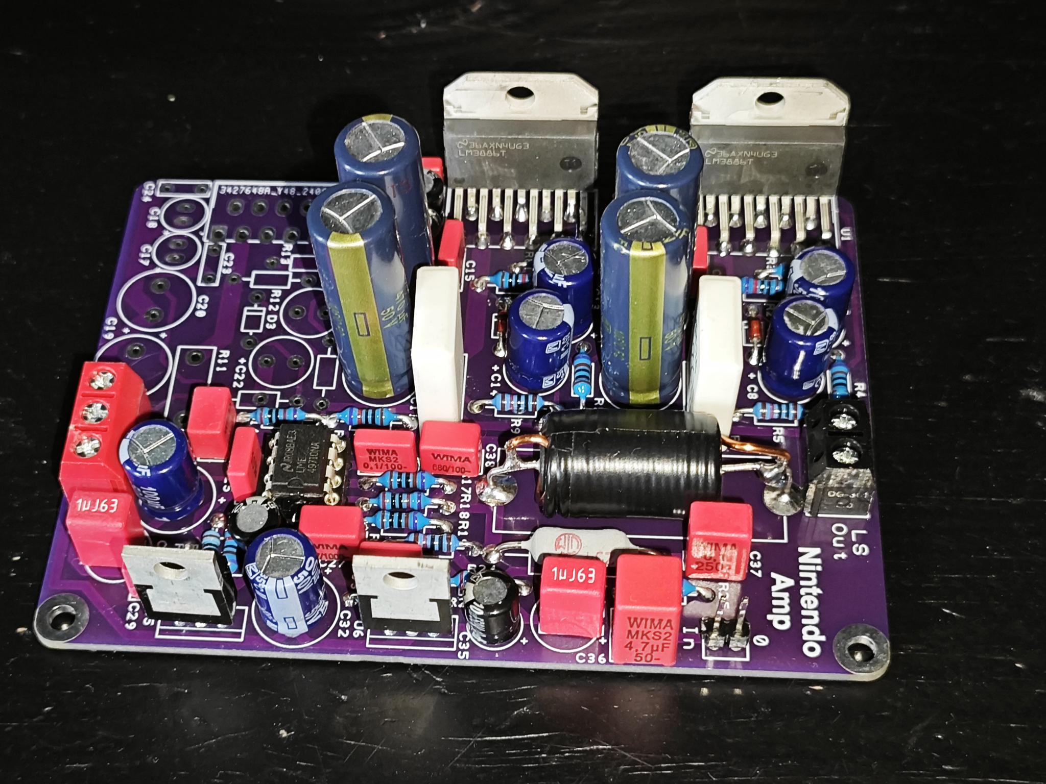

Hello CSandrelli,
Thanks for sharing.
Did you really use it without problems?Do you have pictures and/or description of your build?
I like to see them.
I am missing important correction networks, like explained by Tom at his site(Neurochrome).
And it is not a composite design with correction for lower THD+N.
Schematic From post 1 has only 5mV DC offset (one stage)so no adjustment necessary.
Bridged with two power stages DC offset below 1 mV. According to original builder.

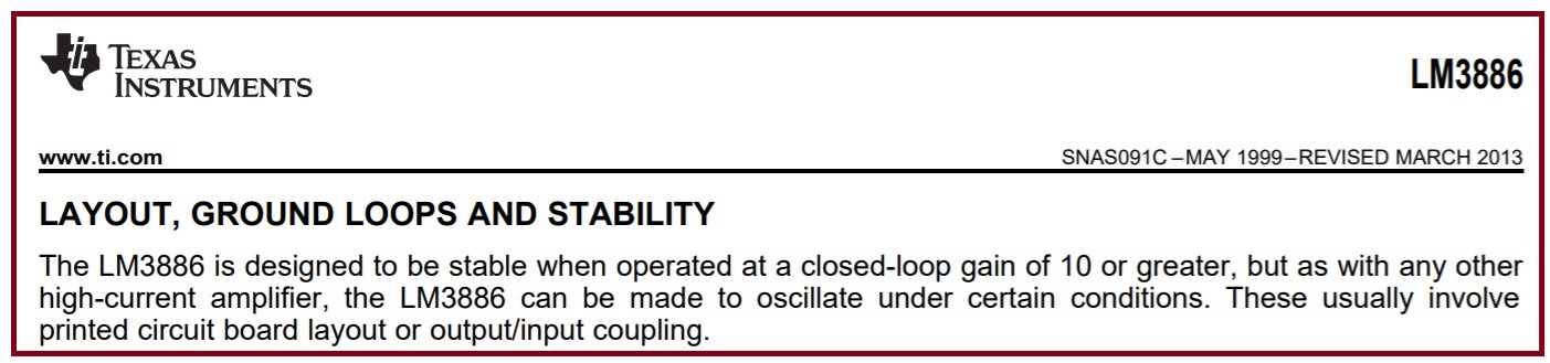

Ok, but to be safe it's better to increase it to x15 or x20 or higherAccording to LM3886 datasheet it should not oscillate.

I will start building the stereo unbalanced 2 x Parallel Lm3886. Because I have only 300W power supply. This has a gain of 21x.

Then I leave the LM3886 with 11x gain and the LME49710 does about 2x gain For the unbalanced 2 x LM3886 PCB.

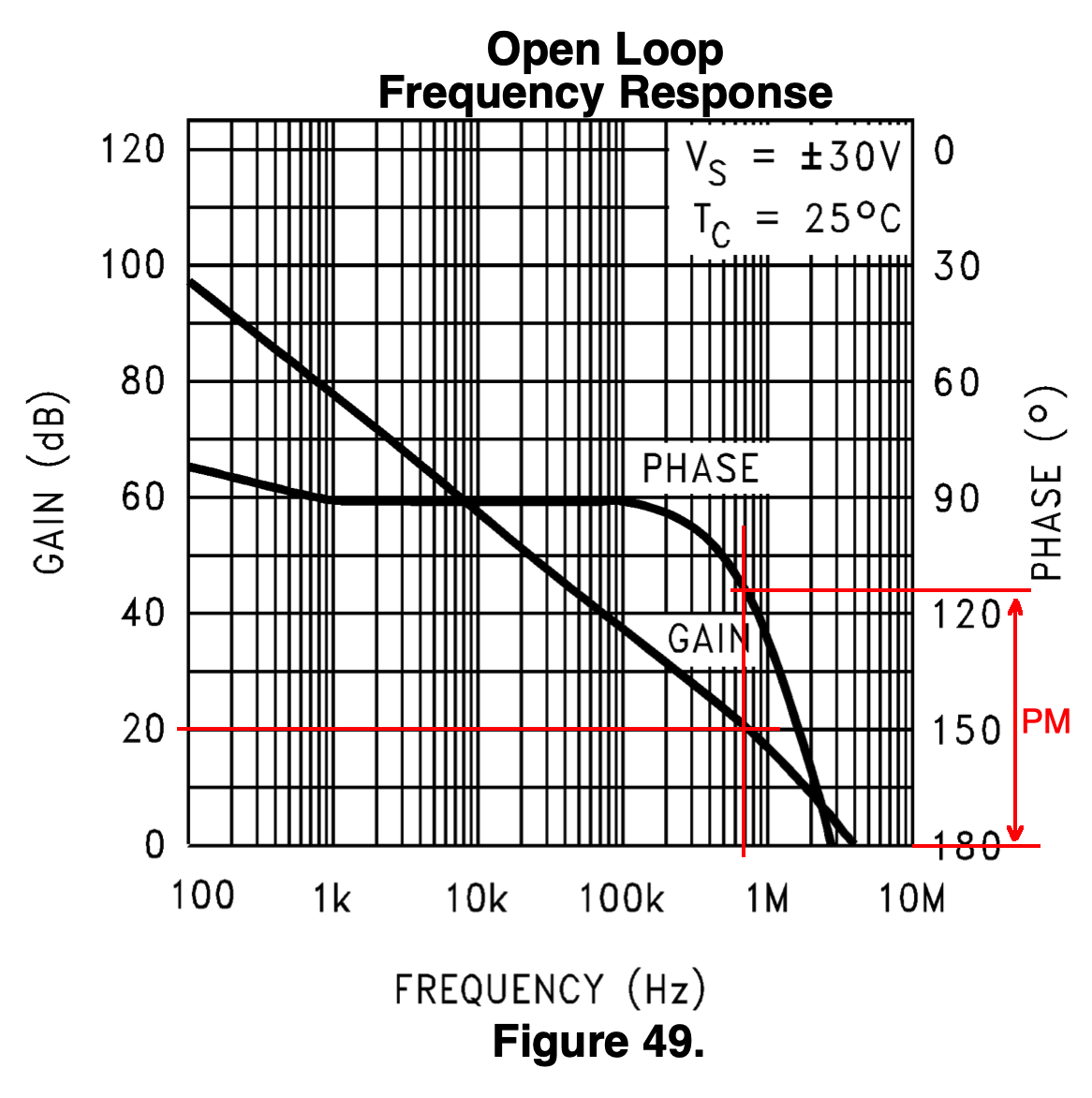

22k/1k yields a feedback factor of 1/22, corresponding to an inverting gain of 22 or non-inverting gain of 23. You're saying that the LM3886 is not stable below these values. Correct?The 3886 is not stable with a gain network lower than 22K/1K.
That statement is false. As indicated in the LM3886 data sheet, you can run the LM3886 at a gain of 10. We can dig a little further into the data sheet and find the open loop gain/phase curves. I've marked the closed loop gain of 10 (20 dB) and the corresponding phase margin (~65º).
65 degrees of phase margin is plenty. You won't even get an overshoot on the step response. Some may argue that you could push it even further, say, a gain of 4-5 (-> 45º PM), but I'd play it conservative here. Also, above curve is for a typical part. To allow for part-to-part variation, you really should not go below a gain of 10, so Rf = 10k, Rgnd = 1k, with the LM3886.

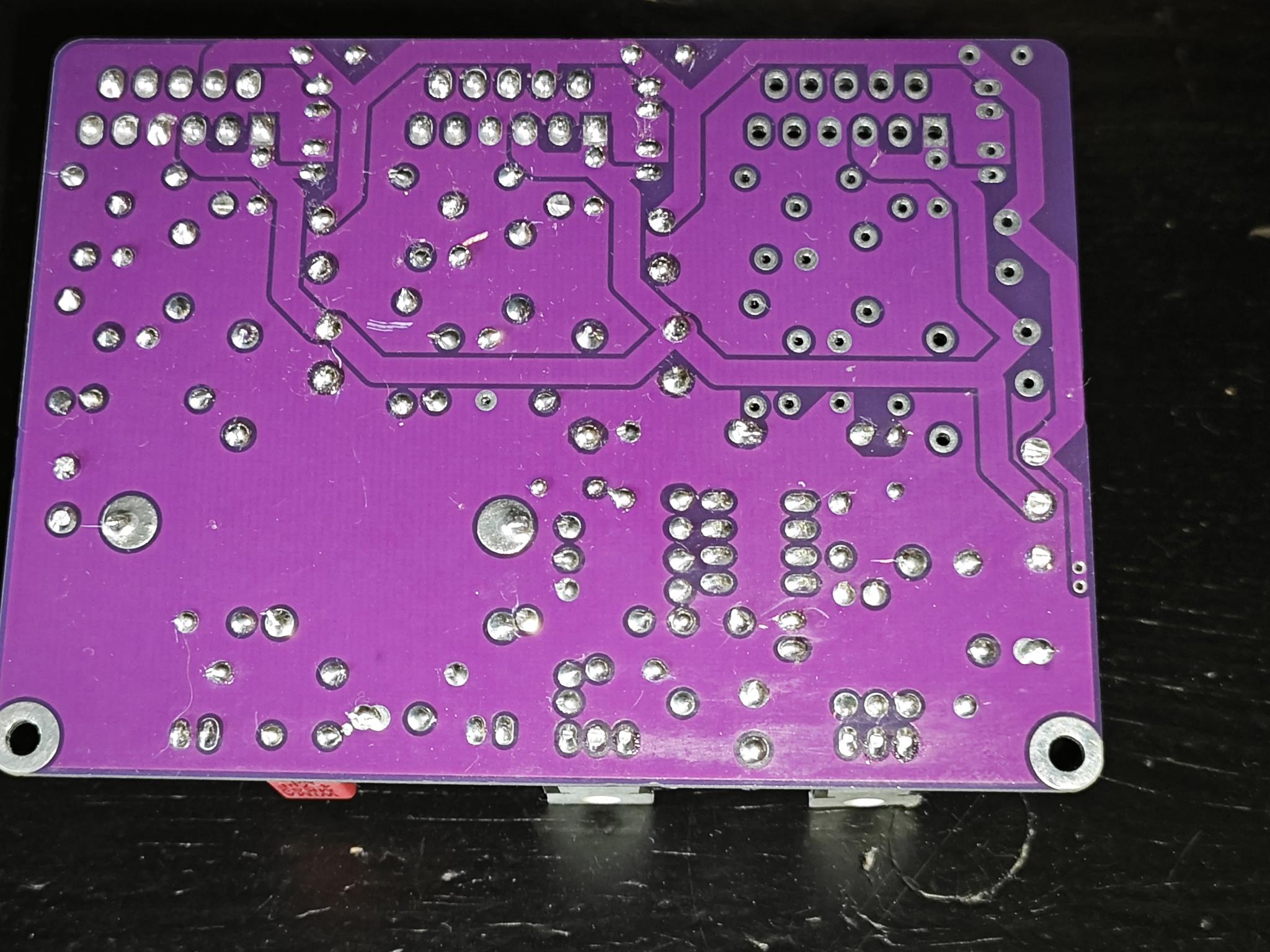

I realize I'm late with this feedback: You really don't want the PCB to dangle by the LM3886s. You want mounting holes by the heat sink as well. Oh, well. Too late now.
Tom
Tom
Understood. I provided the feedback for the benefit of those who finds this thread years from now.
Some five-minute epoxy and either some standoffs or angle brackets attached to the heat sink would do wonders.
Tom
