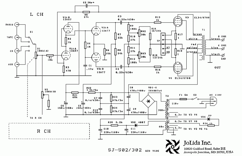

Schematic recommendations for a PP KT-88 with the gear I have?
Wondering if anyone can recommend a good Hi-Fi schematic for the transformers and tubes I already have?
I'm hoping to go KT88, 12AT7 and 12AX7 for the tubes in a push-pull configuration as I have many of these tubes.
I have a gutted Jolida JD302BRC case that has slots for 4 power tubes and 4 pre-amp tubes I am going to use for the build with the transformers already mounted to it.
My power transformer (Jolida SG-300A) specs is as follows:
6.3V (3.5A)
70V (100mA)
0-10-350-370V (500mA)
110V x 2
0-5-9V (5A) x 2
My output transformers (x2) specs (Edcor CXPP60-MS-4.2K) are:
60W
Primary: 4.2K ohms
Screen Voltage: 40%
Secondary: 4,8 and 16ohm
I was looking at a Jolida 502A Schematic and it looks pretty simple. Looking to max out wattage with these transformers. But wondering if there is a better way to go?
Any recommendations would be great.
Thanks in advance!

Unfortunately, the stock Jolida chassis isn't very good IMHO, because it's so shallow. This makes adding a decent power supply a real pain.
Have a look thru this old thread. Lot's of interesting ideas to improve the circuit. https://www.diyaudio.com/community/threads/opus-5-0-a-modern-mullard.161702/

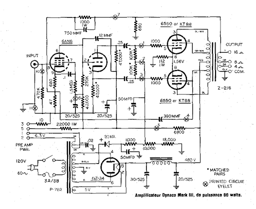

Have a look at this design, based on an Eico HF87/89 Mullard topology. FWIW, I have both Dynaco ST70 and Eico HF87, and the Eico is clearly the better amplifier. If you would like to know more about Kevin Ward’s adaptation for fixed bias 6550/KT88/KT120 with UL 4300 Ohm output transformers with EFB modulated negative bias supply, read about it here: https://audiokarma.org/forums/index.php?threads/kt120-amp-mk-3.828722/
