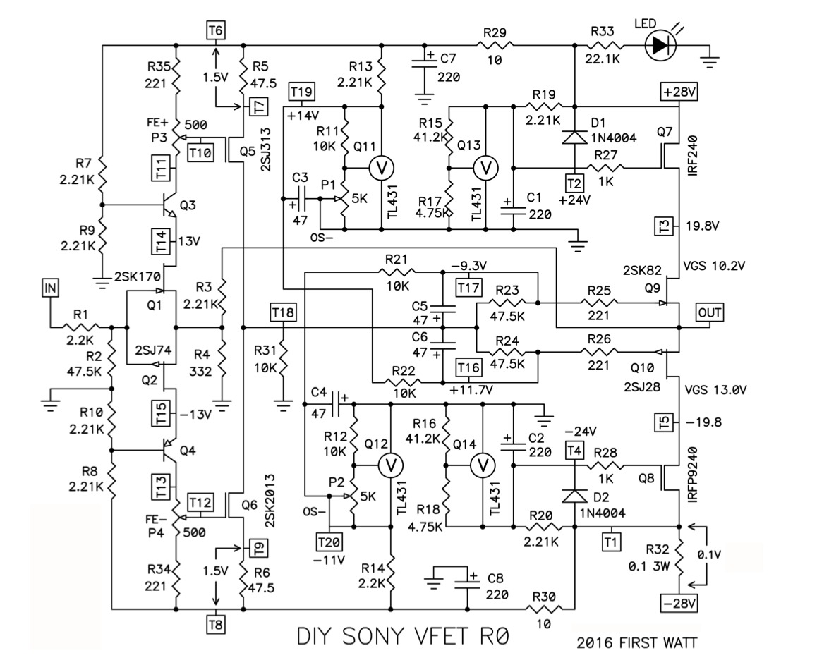

Schematic of Pass Labs amplifier SIT/VFET
Does anyone have information on the Pass Labs SIT/VFETS? Schematics of Pass Labs amplifiers that use the SIT/VFET?
His SIT amplifiers are the first of a new generation of audio amplifiers using Static Induction Transistors in a single-stage, single-ended, Class A circuit without feedback or degeneration.[13] The SIT chip combines a square-law input character with a low impedance output to form the only solid-state gain device, which Pass claims, "behaves like a triode tube." There is no output transformer on the SIT amps. The point of the SIT is that it behaves like a triode but at lower voltages and higher currents, so it doesn't need a matching transformer to deliver power to 8 Ohms. Like tubes, SITs have soft overload clipping. When brief bursts of musical energy occur, SITs react with rounded waveform tops instead of sharp and hard clipping of solid-state. SITs have a curve which looks a lot like a triode vacuum tube; low at first and climbs steadily. The distortion curve is similar, a steady rise instead of a valley with high distortion at both ends.
Is it possible Mr. Pass has invested $60m to create his SIT's?

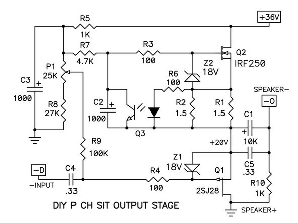

Something like this perhaps?

There are no (zero, nada, zip) SIT/VFET devices in production today. The Pass SIT was a production run of one batch, and sadly the fab that made them went out of business a year or so later for completely unrelated reasons. The Pass SIT has never been available in any product other than the various Firstwatt SIT amplifiers. (SIT-1, -2, -3. The new SIT-4 uses a NOS Tokin device)
The other SIT that people build amplifiers around are 40+yr old, and extremely rare. So you’ll need to source some yourself, then build a suitable amp for the devices you can find.
Tokin THF-51S, Tokin 2SK182ES, Tokin 2SK180
Yamaha 2SK77
Sony 2SK82, 2SJ28, 2SK60, 2SJ18
These can be made into amplifiers. That‘s the easy part. Finding them is the challenge.
And yes, they absolutely, unquestionably sound as good as you think they do. 😎
