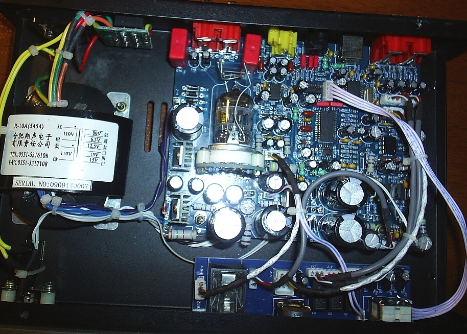

Schematic for Xiang Sheng Tube DAC Model "DAC-01A" wanted
Who can post the associated schematic?
From the supplier xshn@xshn.com I get follow reply:
Hi, I am really sorry to tell you that we do not have the schematic diagram of the DAC-01A. But if you need some help, I think our engineers could help you. Please understand. With Best Regards, Spencer
Obviously the PCB producer isn't the same as the supplier.
Where I can I additional ask?

Did you use an oscilloscope to probe the output pins of the DAC chip?
It sounds like a dry solder joint.
May I respectfully advise that the correct word to use in the sentence above, would be dead, not death.
Eg, the channel is dead.
english isn't my native language - nevertheless best thanks for your advices.
I will check this as soon as I get this device for service.

no news??
Yes, this was the reason. After resolder all solder joints arround the CS8416 (receiver Chip) and CS4398 (DAC) the device works fine in all respects.

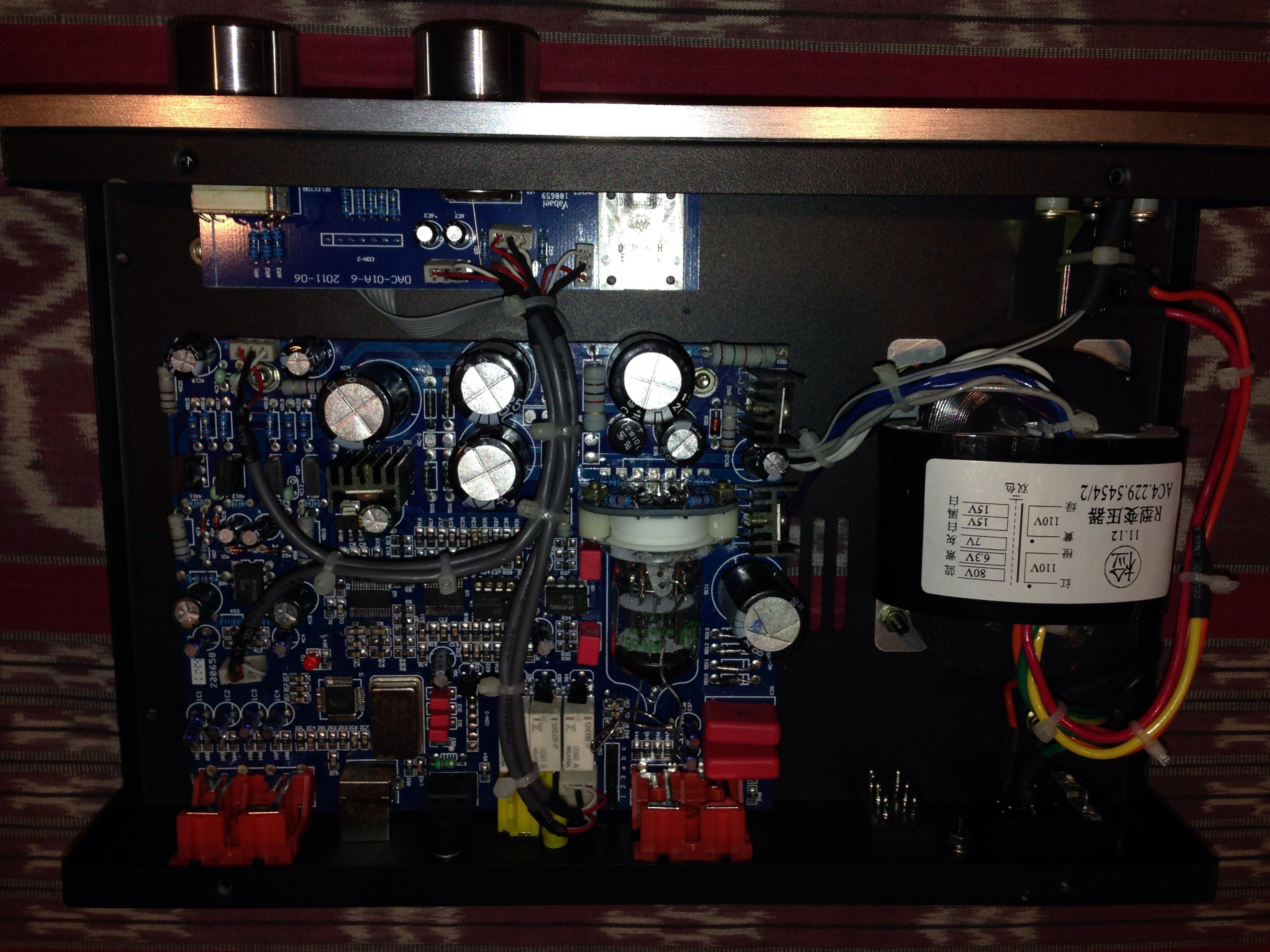

Re: modding the DAC01A
Hi all,
First time poster here. I have an interesting problem with this DAC and I hough I'd hijack this thread instead of starting a new one.
First off, I should say I have no experience in diyaudio, so I apologize in advance for being unclear or misusing words.
So this DAC was recommended to me by a forum member as a DAC and preamp solution. Many might know that there are versions of this out here that are identical in design to the Grant Fidelity tubedac09 and that there are instructions on how to convert the volume pot so that it controls both the headphone amp as well as the various sources the DAC can accept. There are three different versions on the GF sight, complete with pictures and instructions on how to move the jumper cables to make this happen.
So I bought one off eBay only to find the innards completely different from the three versions on huge GF site. I'll post the pic here, but it seems to my ignorant eyes the same as what the OP showed above.
So...does anyone have any experience or idea how to mod this design? I emailed the manufacturer and I was told the mod is not possible.
Any help would be appreciated. I could always use it as a tube buffer and get a separate preamp, but I bought it in the first place as an economical solution to having both a tubedac and preamp.
Cheers, Chris

I have another question, what is that metal wire kind of thing on the Tube? my DAC does not have it... I bought used, from someone who fried the opamp.. may be it got removed. Any idea what it is? Sorry if my question is dumb..
