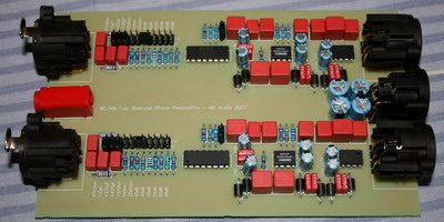

Hi Zoltán,
a very clean board, congratulations. 😎
Just like Calvin, I'd also like to know how it sounds and how it compares.
And I've got another couple of questions, if you don't mind... 😉
I can see you used Wima FKP2 capacitors in the front end.
In that range and size you can buy MKT, FKP and FKC types (despite mica and ceramics).
Any particular reason you chose the FKP dielectricum (despite the availability in better selection grades)?
I can see you attach power to the board by another XLR plug, right? Funny. 🙂
Why do you go for no local power supply decoupling near the ICs at all?
I assume this detail is just a difference between the posted schematic and the board you made, as the additional caps are easy to spot near the INA, OPA and DRV...
What are the ferrite beads doing, and why?
Are you aware of the 'pin one problem'? How is noise immunity with your board and your connections, now that you seem to mix signal and power supply ground in the high-gain stage?
Thank you for your effort and sorry for all the bothering questions. 😀
Sebastian.
Hallo Calvin und Sebastian,
First of all I must say that this phono stage isn’t working in my system (I prefer only digital sources), but one of my friend’s quit expensive chain. He has ordered it, because his new 2nd hand ML38 preamp doesn’t contain phono input. In order to satisfy your interest, I have already requested a short description/comparison concerning sound quality from my friend. As soon as I have it I will share with you.
To return to the questions:
The choice of FKP2 was based on Cavin’s suggestion, and in the other hand the easy availability of this WIMA series at local suppliers.
Between the outputs the 5pin XLR male connector can receive the external PSU, because I didn’t want to put the transformator in same case together with the preamp. (And optional the user can use batteries as well…) Currently one modified Jung regulators is used as power source in same size ALUBOS housing then the preamp.
Electrical point of view the ferrite beads don’t play to much role in this low frequency application (increasing impedance of bypass loops), but their usages and lengths allow to increase the surface of ground plane around ICs.
The ‘pin 1 problem’ was absolutely new for me. But I’m sure that it isn’t issue in case of this design because I/we didn’t find any hum & buzz.

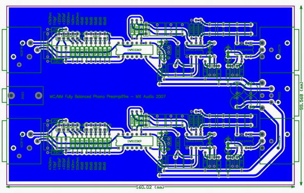

And finally please find a picture about a topview… And don't hasitate to tell me your critisms!
Tschau
Zoltán
