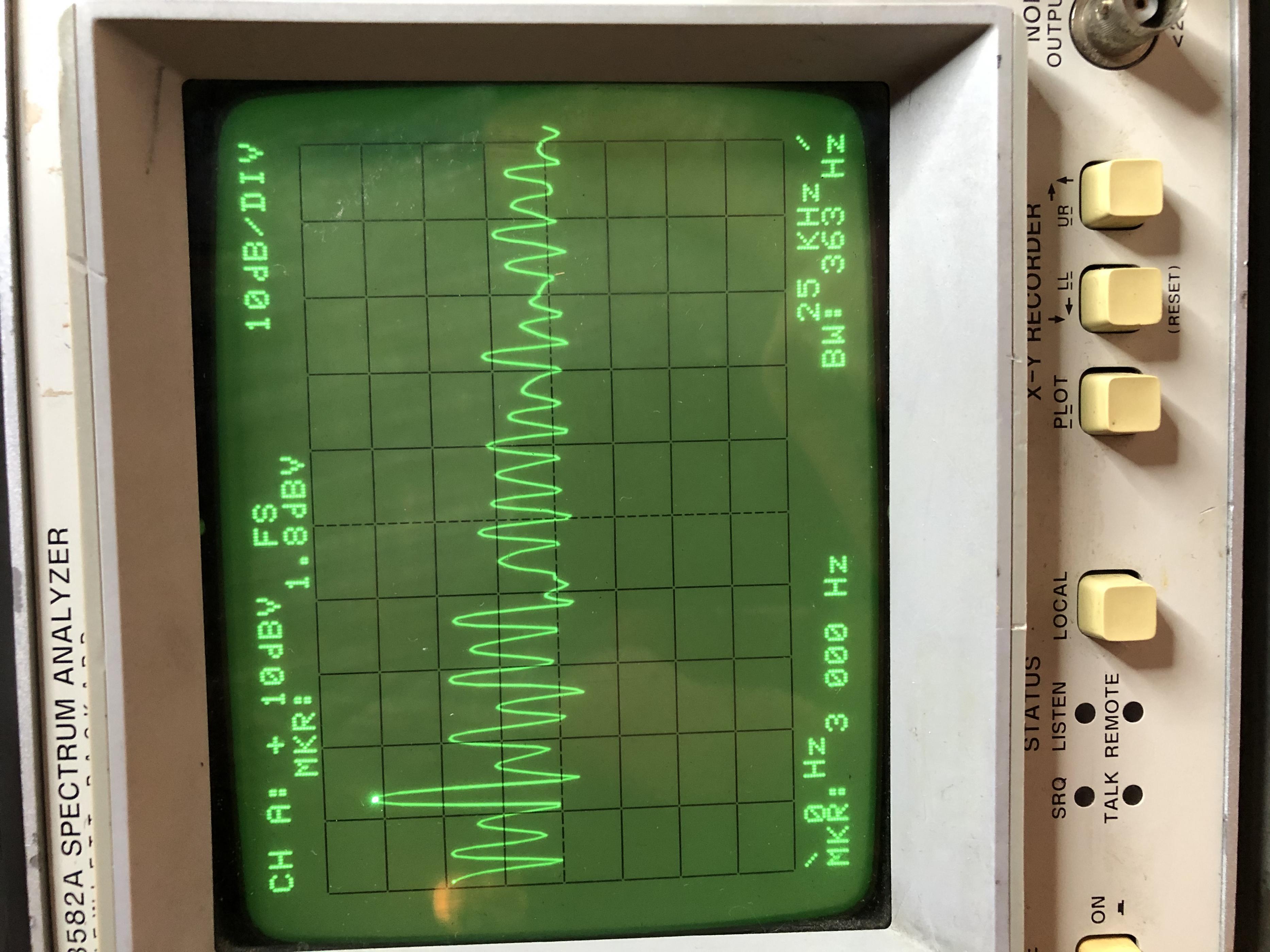

Since my last post I acquired an HP 3582A audio spectrum analyzer. Still learning to use it, but it does show what the problem is. Just not WHERE, yet anyway.
See the attached photo,
What your seeing is the monitor output of my HP8903A. It's an RMS average of 16 samples. Basically it shows just the noise (1 kHz fundamental removed). It very clearly shows odd order harmonics. The marker is on the 3rd harmonic.
What I'm thinking is that odd order harmonics are caused by clipping? Need help here.
Any chance it's a bad cap somewhere?

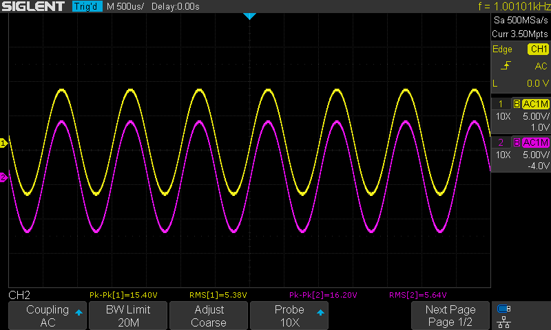

I don't see any clipping in the output, see the attachment.

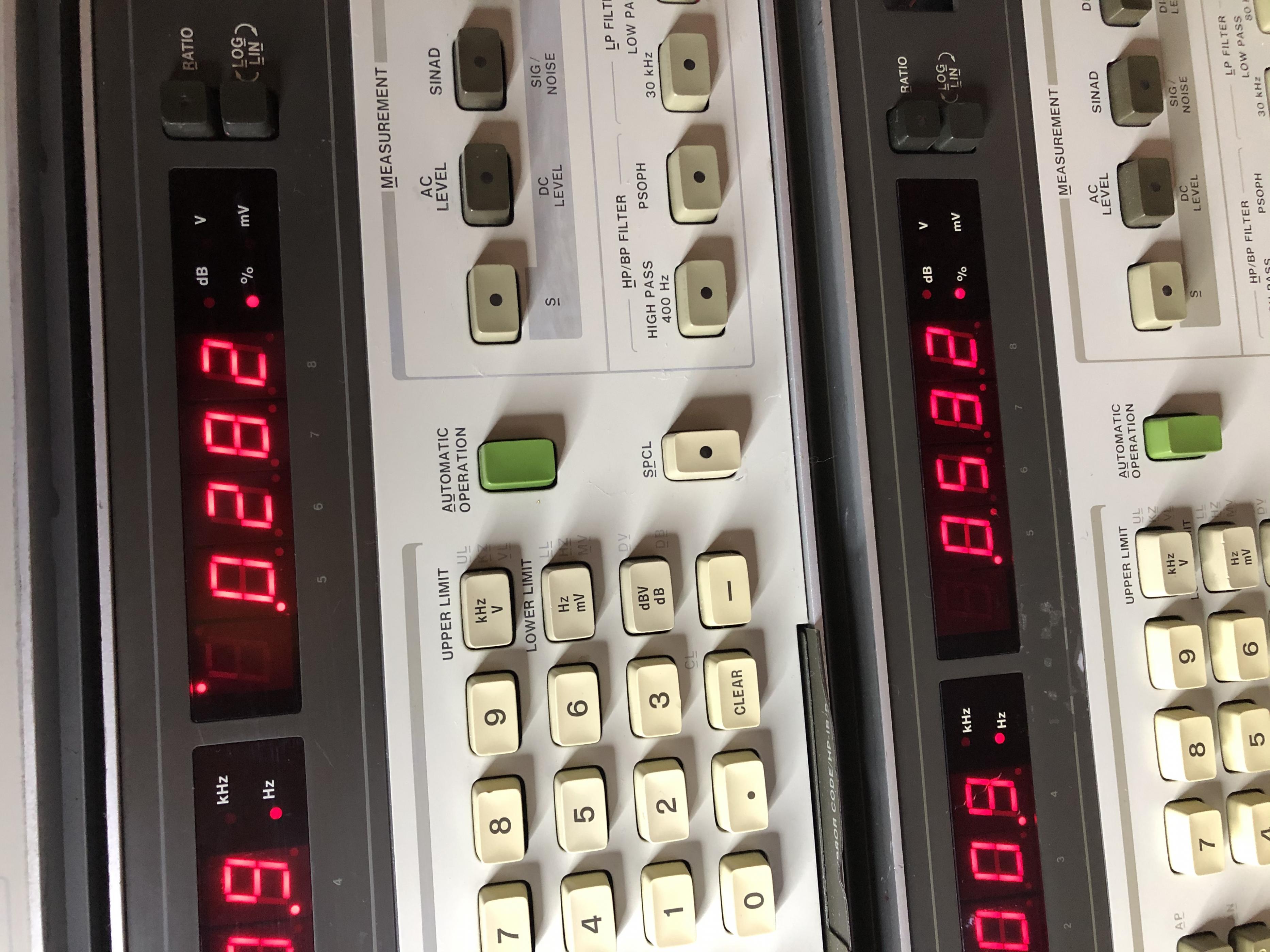

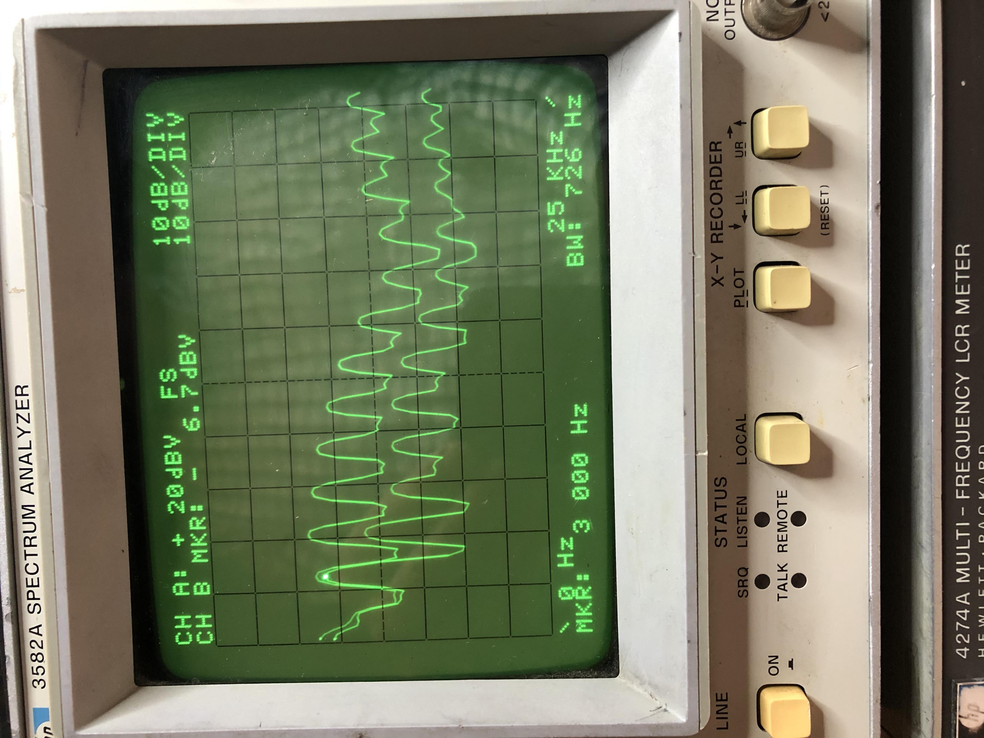

Below is another spectrum analyzer shot of the left and right channels at about 40 Watts both channels and 1kHz. The waveform are from the monitor output of the 8903As. So it's just the noise.
The left channel (top trace) is 20dB higher than the right channel. It just all across the band width.
The second shot is a pic of the THD from the front of the 8903As. The higher number .0532 is the left channel. As you can see the right channel is in spec.
I'm not sure what to look for; transistor, cap, something else?
Anyone have any ideas?
