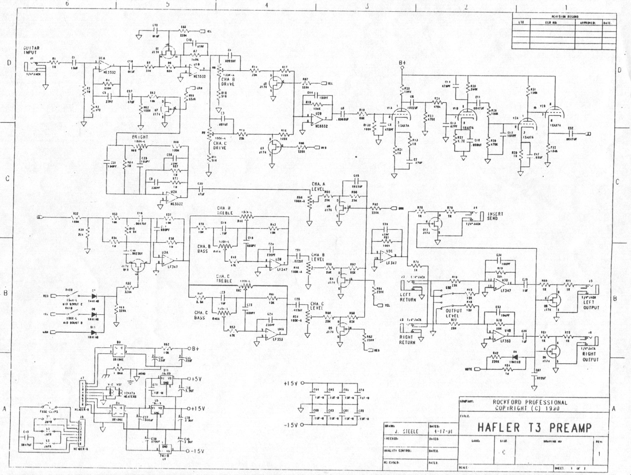

Thanks proaudiomaster. I did receive a PDF a while back of the schematic. However, virtually all of the labels on the components are illegibly fuzzy. If yours is different please email me at....

Hello proaudiomaster,
being a newbie I'm not able to contact you directly, but you would do me a great favor by sending a schematic of the Hafler too. Thanks in advance!

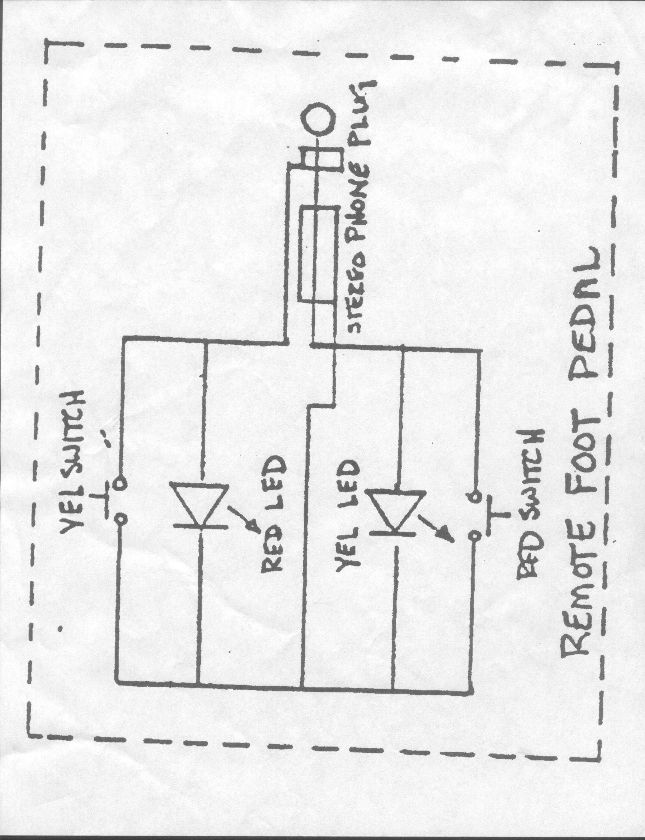

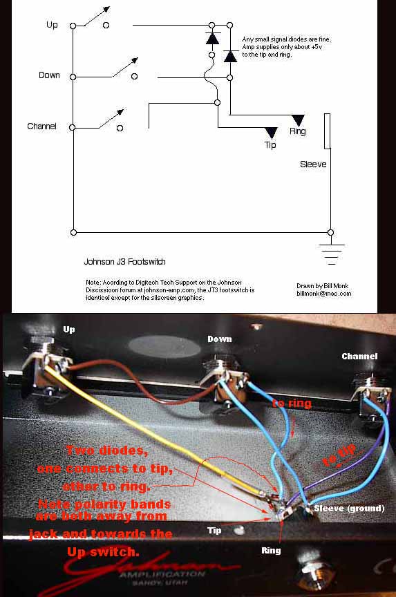

I built one of these foot-switches and it does work. However, both LED's when switched on do shine but when switched off they keep on dimming. Is this something I should be worried about?
On channel one both lights light dim, channel 2 just that light bright and channel 3 just that light bright.
I know this thread is ancient but I'm trying to hunt the t3 schem diag but all i can find is a jpeg of it. If anyone can send me a pdf to ben.chudyk(at)gmail
